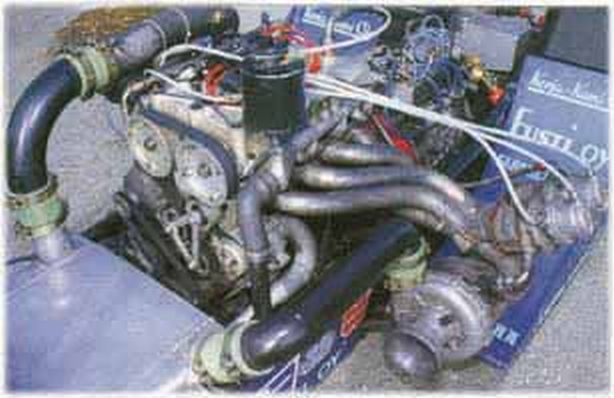

Chris Wilson Posted October 17, 2007 Share Posted October 17, 2007 Any link Chris? Bet thats worth a bit isn't it? It's not on the net, sorry. I think it could be bought for about 20K To be honest it's quite old technology now, there are far better engines out there. In its day though, it was a benchmark 4 pot turbo race engine. Quote Link to comment Share on other sites More sharing options...
Muffleman Posted October 17, 2007 Share Posted October 17, 2007 Is there any detail anywhere on just how the 503E differs to the 3SGTE ? Quote Link to comment Share on other sites More sharing options...
Chris Wilson Posted October 17, 2007 Share Posted October 17, 2007 It's totally and utterly different, one's a road car production engine, the other a bespoke race engine that has a little resemblance to the 3S-GTE. Just search Toyota 503E , but bear in mind there are some sites proclaiming details of 503E's that are really modified 3S-GTE engines. You can recognise a genuine 503E as it has external plumbing for cooling the block and head separately. The block top was closed deck. It was sometimes nicknamed Medusa due to the plethora of pipes external to the thing. Quote Link to comment Share on other sites More sharing options...
