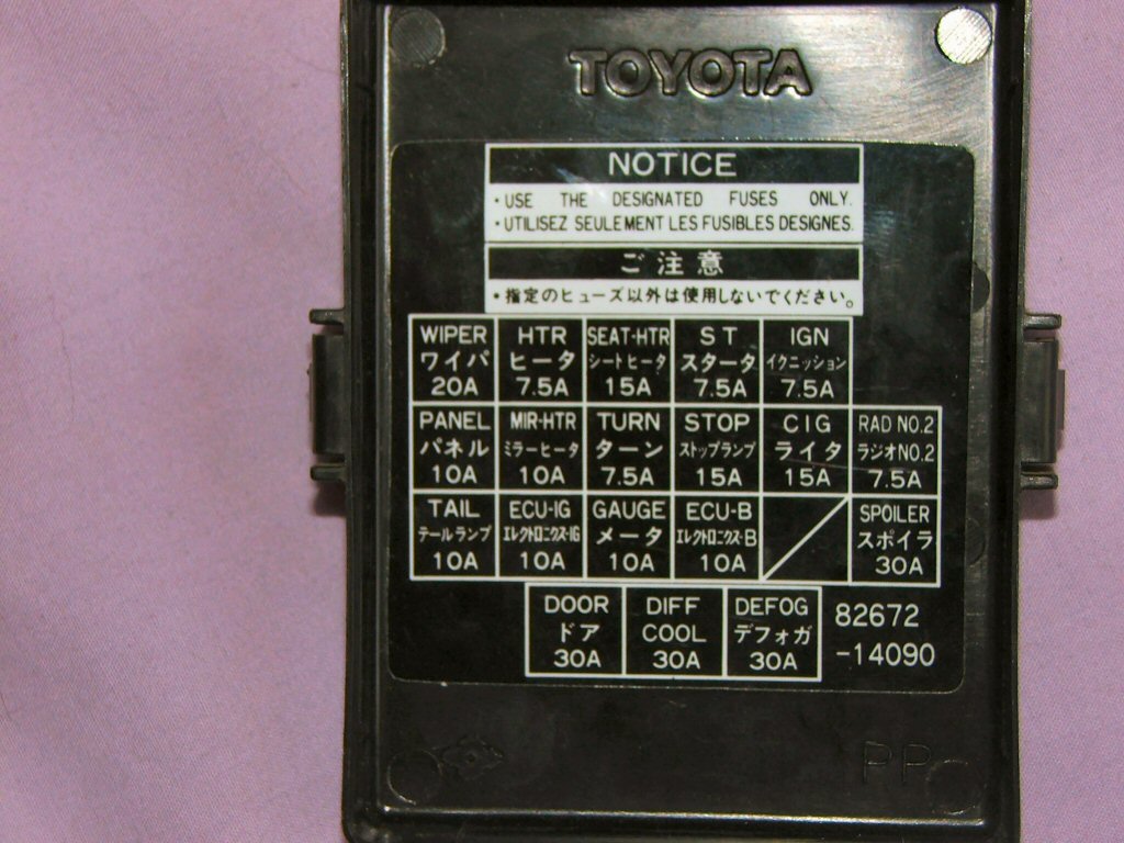

Guru Posted February 9, 2007 Share Posted February 9, 2007 Drivers fuse box is to the right of the loud pedal behin the plastic. Very small box and hard to adjust your body to get to. Here is the fuse box plan mate Link to comment Share on other sites More sharing options...
CJ Posted February 9, 2007 Author Share Posted February 9, 2007 Thanks Matt. I did know that but as you can see, there are no fuses there for the trac control. Apparently, these are mounted in the engine bay on the left as you look from the front. Link to comment Share on other sites More sharing options...
