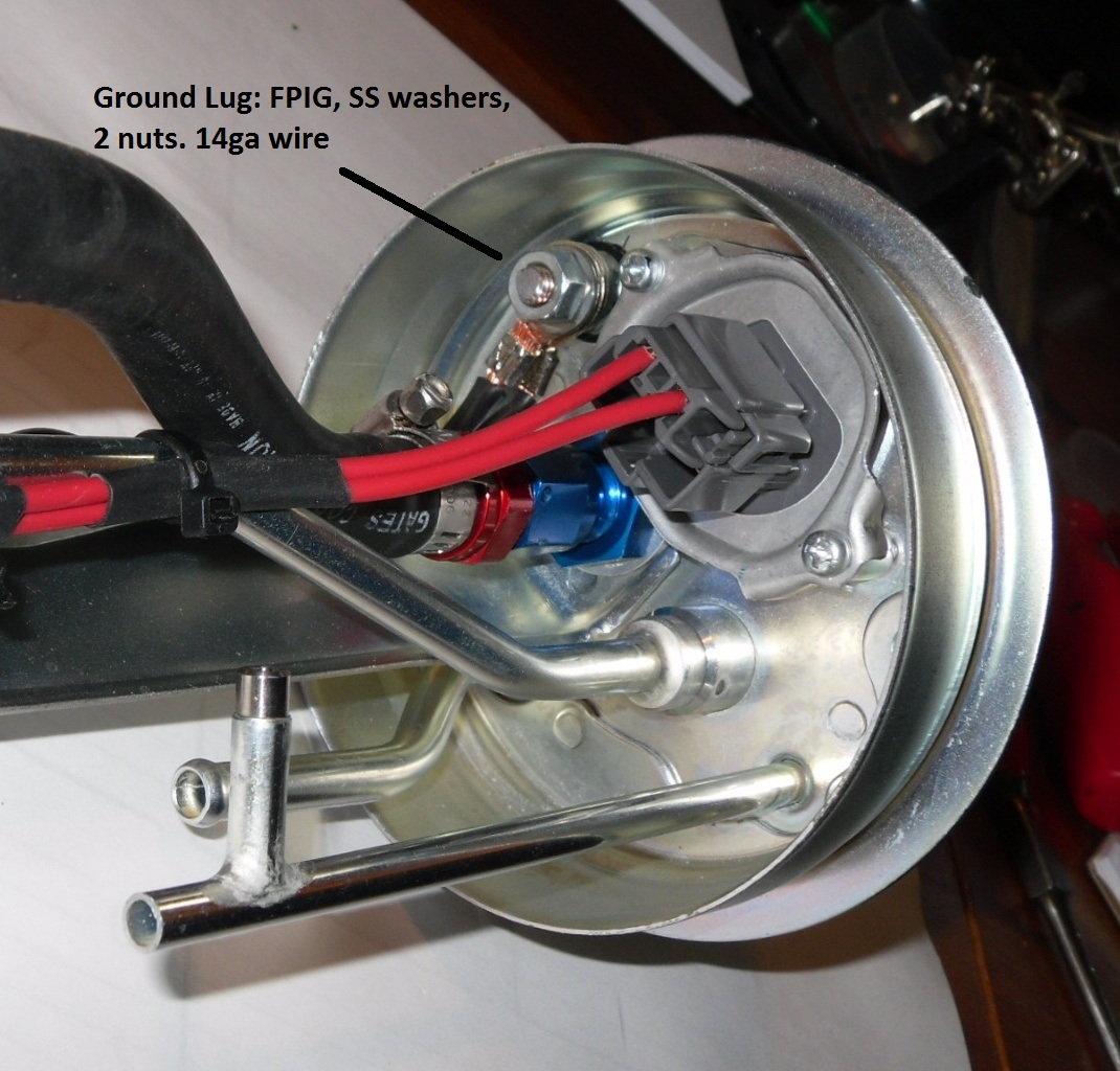

Batmax Posted July 2, 2008 Share Posted July 2, 2008 Hi Congratulations for your time to post these nice Thread. Today I have intalled my fuel pumps of my single and I turn the ignition off and they still running I notice int these pic you put the red wires but I put one red of the pump to the blue stock wire and black wire pump to the black wire stock connector, why you put the 2 red wires ? Link to comment Share on other sites More sharing options...
TLicense Posted July 3, 2008 Author Share Posted July 3, 2008 Because they're both 12 volt power feeds. 1 to each pump. My ground is connected external to this connector, through the pump hanger and then to a good ground on the chassis:- Here's how the ground wires were fixed. Don't worry the bolts aren't annodised so they will conduct fine. (I measured 1.6ohms from the power supply, through each pump and back to the hanger). I used nordlock anti-vibration washers under the ground wire bolts to prevent them from ever vibrating loose:- By doing it this way, each side of the stock connector is only seeing one pumps worth of current. If you connect both pumps through the stock connector then it's rumoured to end up getting quite hot.... not good in the fuel tank! Link to comment Share on other sites More sharing options...

Stu Hagen Posted September 29, 2010 Share Posted September 29, 2010 Thought I would throw this in as well. I re-wired the stock fuel pump with 2 red wires as well. I actually "re-pinned" the stock plug all the way to the harness in the trunk. I also did both in red so I knew they were the +. I also ran a ground to the trunk area as he did. I did however mark the plug with a Blue marker so I new which pump was on the OEM wiring run. I have 2 OEM 055 stock pumps now. One is triggered by the FPECU when the car hits 4000rpms, the 2nd pump then comes on line. (PS I noted I used FPIG for sealing the ground Lug. That is actually not recomended. Use a LockTite fuel resistant compound instead.) http://www.97supraturbo.com/Fuel%20Pump%20upgrade/Stu%20Pump-2.JPG http://www.97supraturbo.com/Fuel%20Pump%20upgrade/Stu%20Pump.jpg Stu Link to comment Share on other sites More sharing options...
