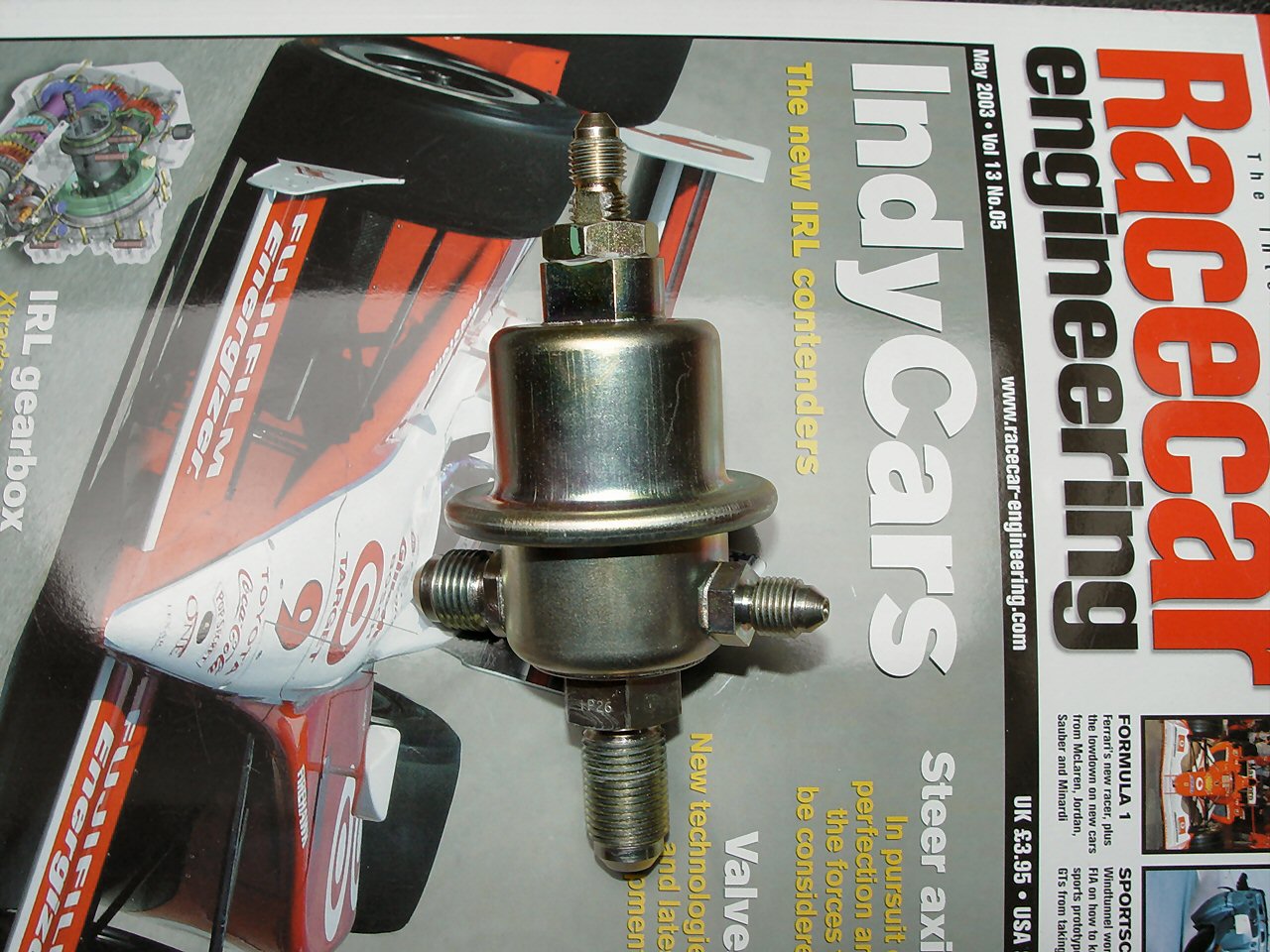

Chris Wilson Posted June 3, 2006 Share Posted June 3, 2006 I atill have 2 Toyota Team Europe, Bosch Motorsport quality fuel pressure regs for sale, you get what you pay for in FPR's .... http://chriswilson.tv/regulator/regulator.jpg Link to comment Share on other sites More sharing options...
