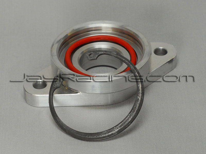

Guest Carsten Posted June 22, 2009 Share Posted June 22, 2009 Okay. I found out where to fit the bov. http://mkiv.com/techarticles/bov/dscn1550.jpg But now ive one problem: HOW. Someone got the manual or something? I´ve the BOV, a flange, a o-ring and an odd metal clamp. Looks a bit like this kit: http://www.jayracing.com/images/products/BV-DH1_1.jpg Quote Link to comment Share on other sites More sharing options...
Scott Posted June 22, 2009 Share Posted June 22, 2009 Okay. I found out where to fit the bov. http://mkiv.com/techarticles/bov/dscn1550.jpg But now ive one problem: HOW. Someone got the manual or something? I´ve the BOV, a flange, a o-ring and an odd metal clamp. Looks a bit like this kit: http://www.jayracing.com/images/products/BV-DH1_1.jpg Thats the universal kit bud, that needs to be welded on. You need the supra specific kit to fit it in place of the stock BOV. Quote Link to comment Share on other sites More sharing options...

Guest Carsten Posted June 22, 2009 Share Posted June 22, 2009 Yep its unversal. But i dont need to weld it There is a way to connect the hose directly to the BOV. But i dont exactly know how. Quote Link to comment Share on other sites More sharing options...
Scott Posted June 23, 2009 Share Posted June 23, 2009 i'm going to disagree. The bottom flange is interchangeable. You have the weld on flange, as in universal, you need the hose adapter flange which is what comes with the supra specific kit. Quote Link to comment Share on other sites More sharing options...
mikeyb10supra Posted June 23, 2009 Share Posted June 23, 2009 Yep its unversal. But i dont need to weld it yes you do. It will go on one of your intercooler pipes Quote Link to comment Share on other sites More sharing options...
Guest Carsten Posted June 23, 2009 Share Posted June 23, 2009 Why? I can build a connector to connect the hose with the bov. That should also work. Quote Link to comment Share on other sites More sharing options...
Scott Posted June 23, 2009 Share Posted June 23, 2009 yeah but that would then be a specific kit wouldn't it? If you are building a hose coupler onto it how do you plan on attaching it without welding? Would be far easier to just buy the proper kit and be done with it. You might get lucky with someone who has changed to a single tubby though. Quote Link to comment Share on other sites More sharing options...
