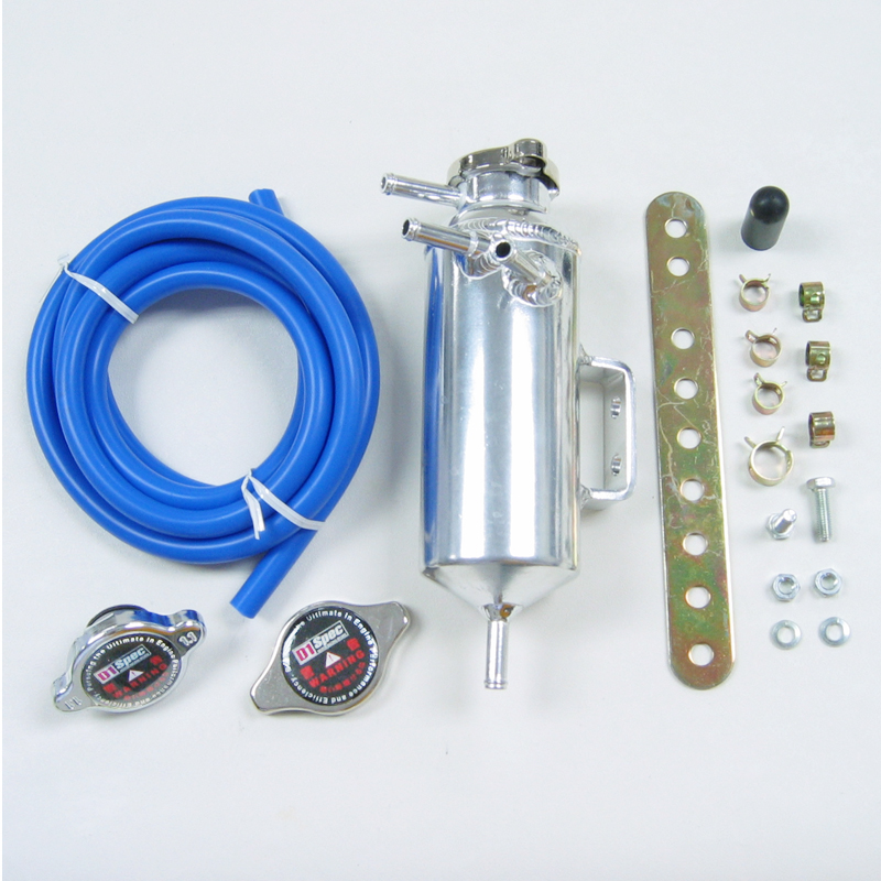

Dash Rendar Posted March 15, 2006 Share Posted March 15, 2006 I've just been considering buying one of these. This unit has four nozzles. I've just been speaking to the guy that sells them and he says that on a typical vehicle, you'd simply hose two of the nozzles together. The leaves two... One inlet and one outlet. He explained to me that the inlet is for the pressurized water coming through the rad cap, while the outlet feeds back to the bottom of the rad. But I'm only aware of the one hose at the top of the rad??? So, if he's right, then the home-made water bottle doesn't work because there is no feed back into the rad. Quote Link to comment Share on other sites More sharing options...
SupraJames Posted March 15, 2006 Share Posted March 15, 2006 Did not know Supras had a feed back to the rad..! The stock tank does not have one..! Quote Link to comment Share on other sites More sharing options...
SupraJames Posted March 15, 2006 Share Posted March 15, 2006 I need a tank for mine, seems there is quite a few options..! Paul E have you got the shiny ones in stock.? Quote Link to comment Share on other sites More sharing options...
Ian C Posted March 15, 2006 Share Posted March 15, 2006 The stock one has no return, it's got a pickup hose that goes to the bottom of the tank. As the coolant expands, it goes into the expansion tank, as it cools, it's sucked back into the radiator. That's all you need, but you *do* need it. I wouldn't run without one, you'll be low on coolant after one drive, and have lots of nice airlocks introduced. -Ian Quote Link to comment Share on other sites More sharing options...
Dash Rendar Posted March 15, 2006 Share Posted March 15, 2006 So, if the hose from the rad only lets water through under high pressure, how does the water get back in? Or is it some sort of one-way valve? Quote Link to comment Share on other sites More sharing options...
Dash Rendar Posted March 15, 2006 Share Posted March 15, 2006 Oh I see. In which case, the one I linked to is completely useless. Looks like I'm gonna have to spend a bit more and get the tres-bling one from Paul! Quote Link to comment Share on other sites More sharing options...
