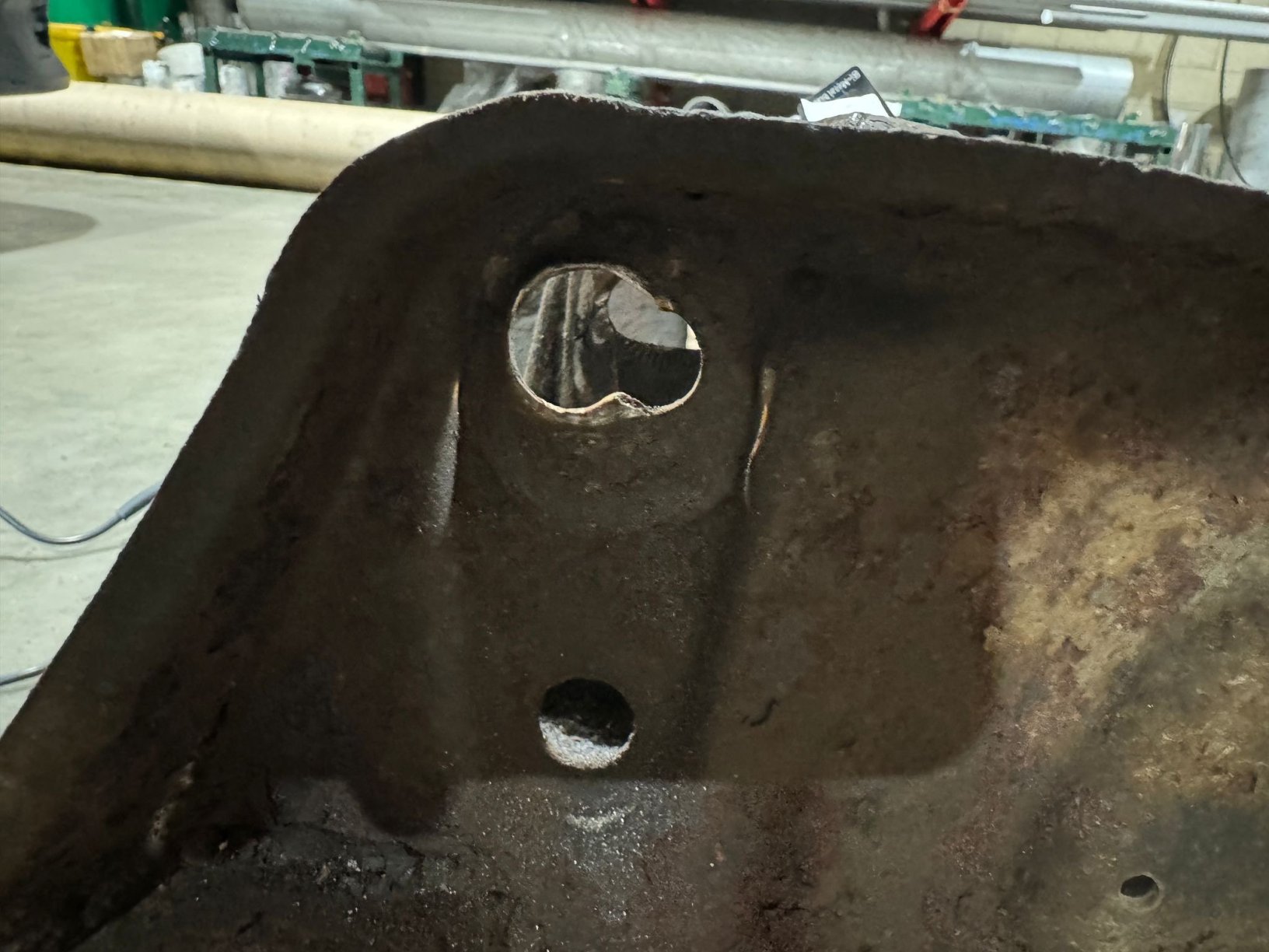

Took a half day off yesterday to try get some more bits done.

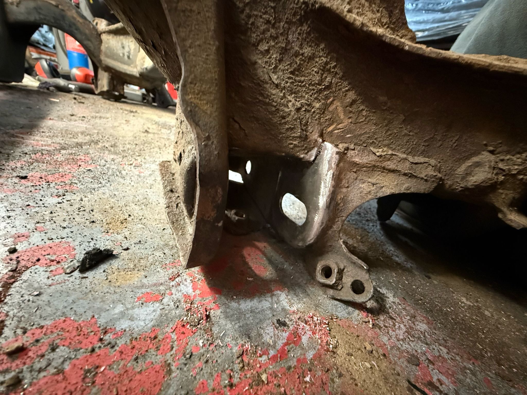

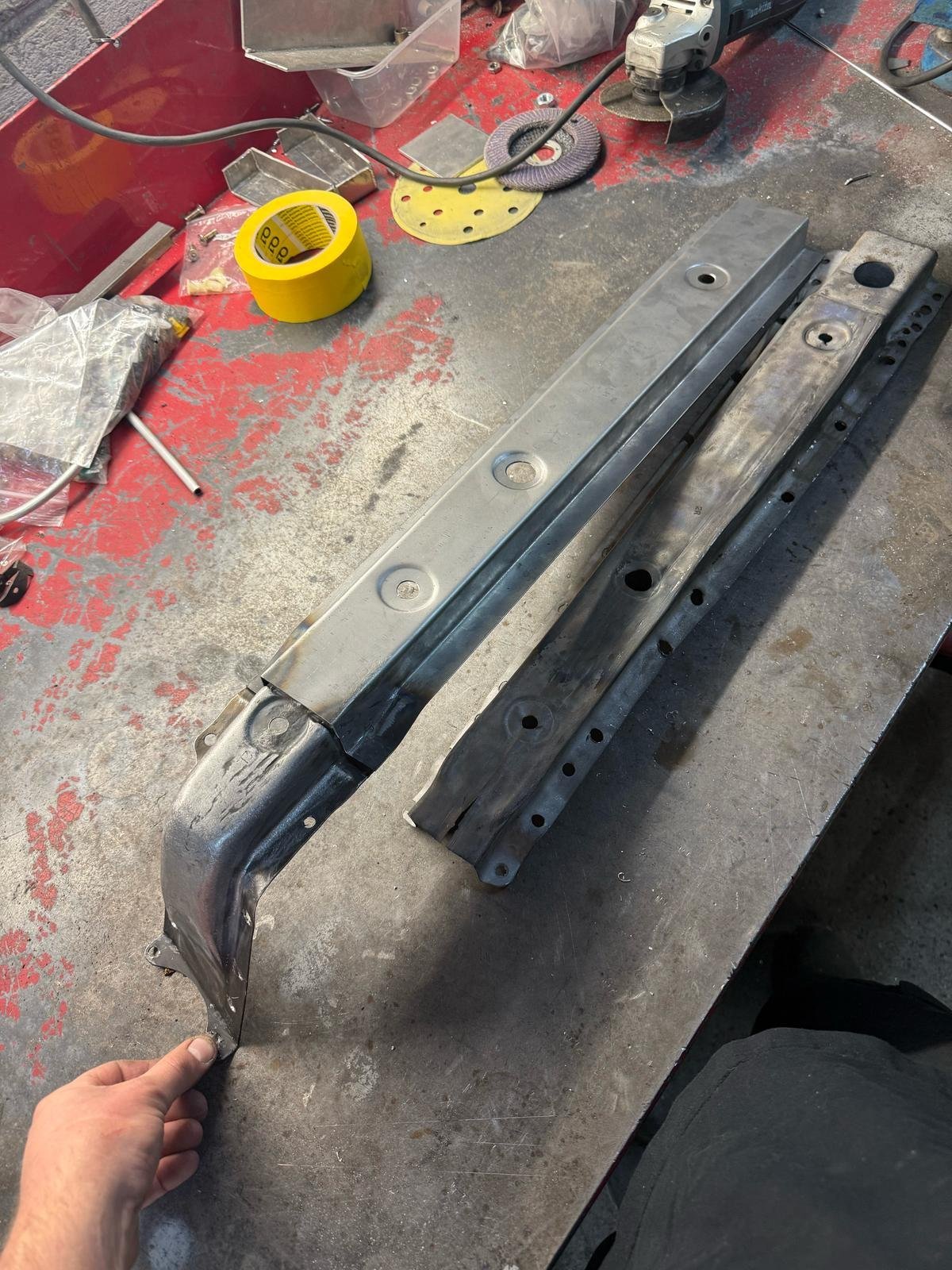

The box section had been crushed at some point. No idea how - my best guess is maybe the previous owner reverse over a bike or something..
So ended up drilling the spot welds to get the 2 pieces out so that they can be repaired/replaced.
Scotched up the rear section ready for seam sealing.
I need to make a start on cleaning the unit up though as it's not in a good way after this project

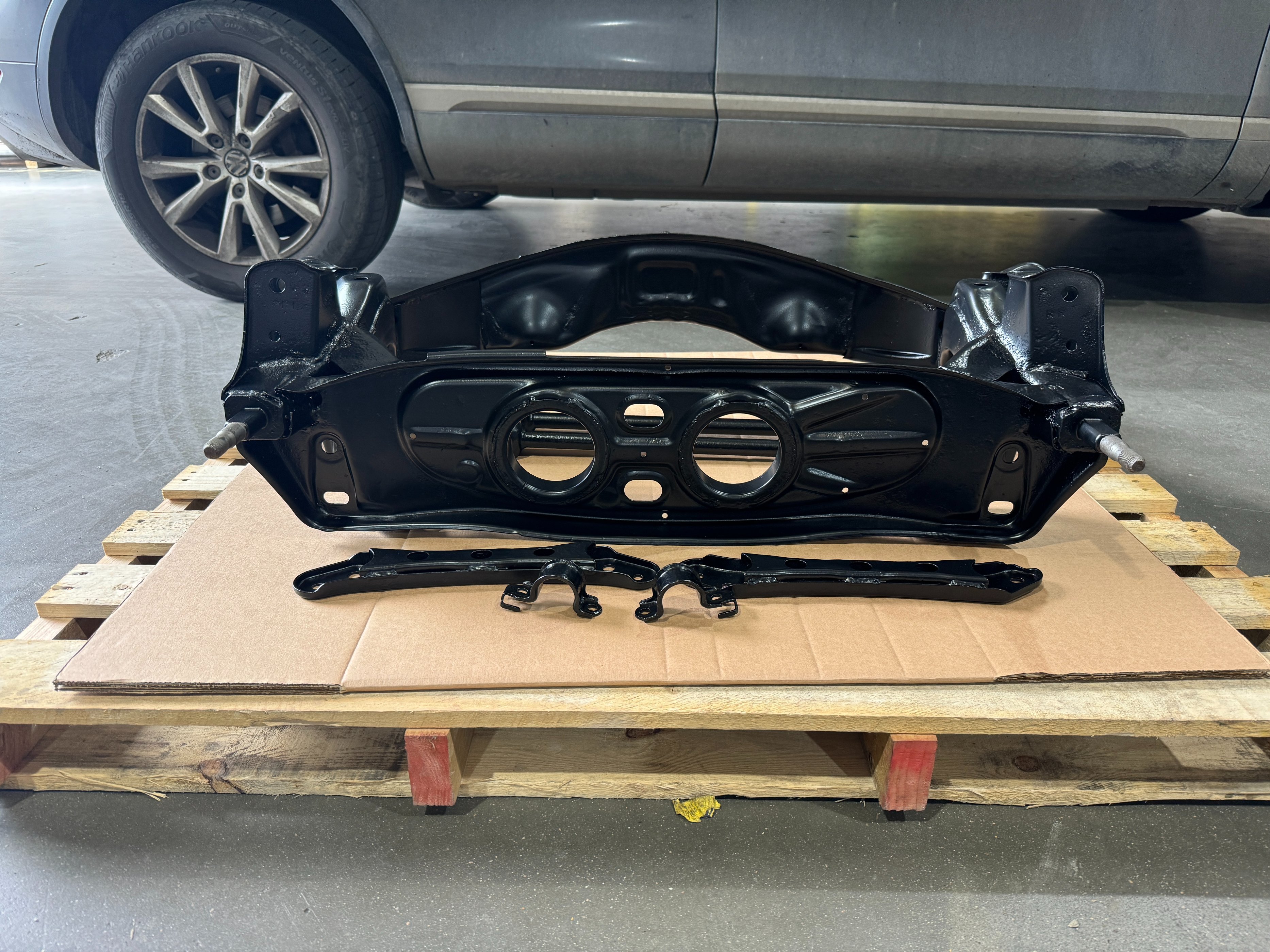

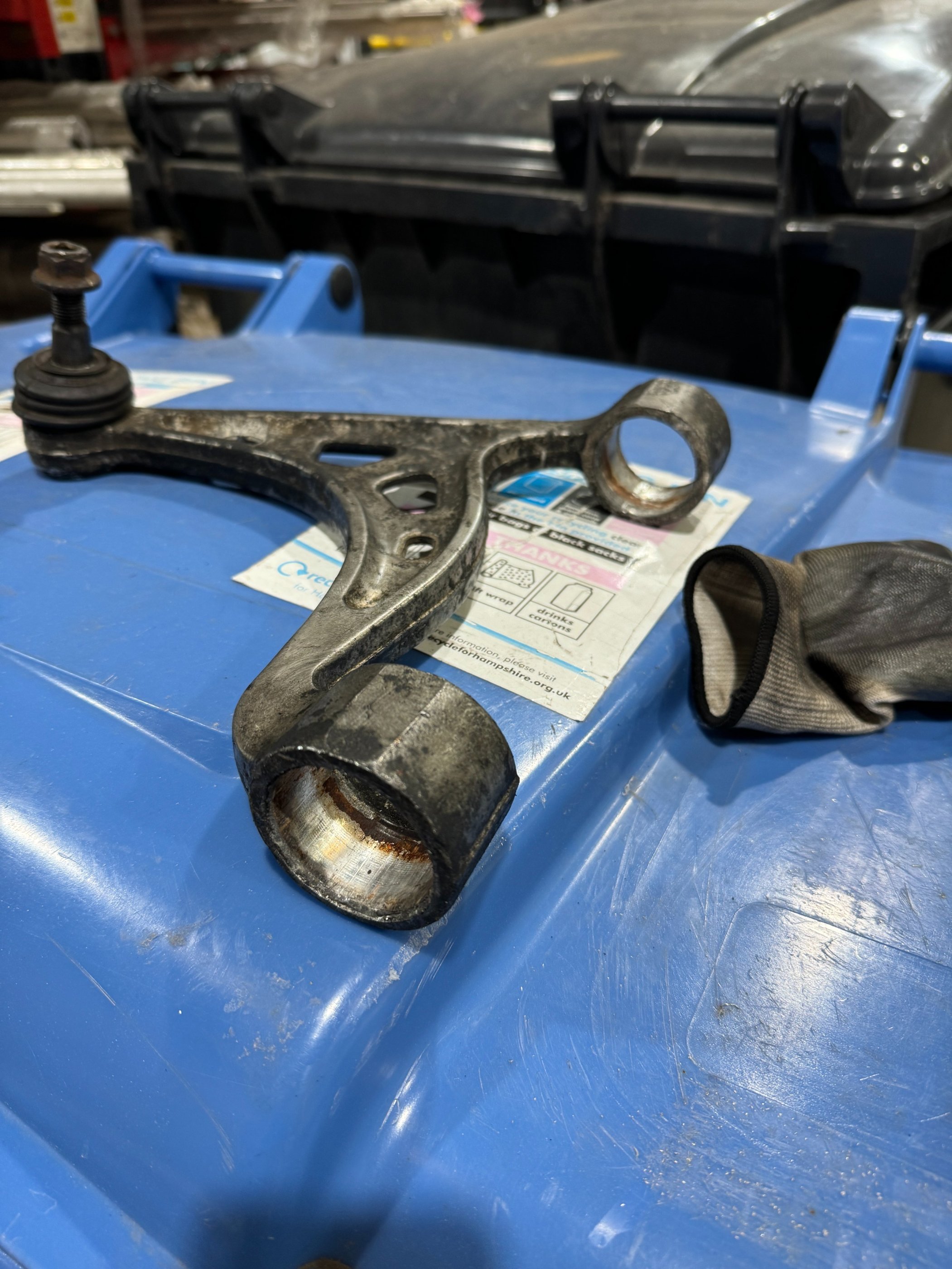

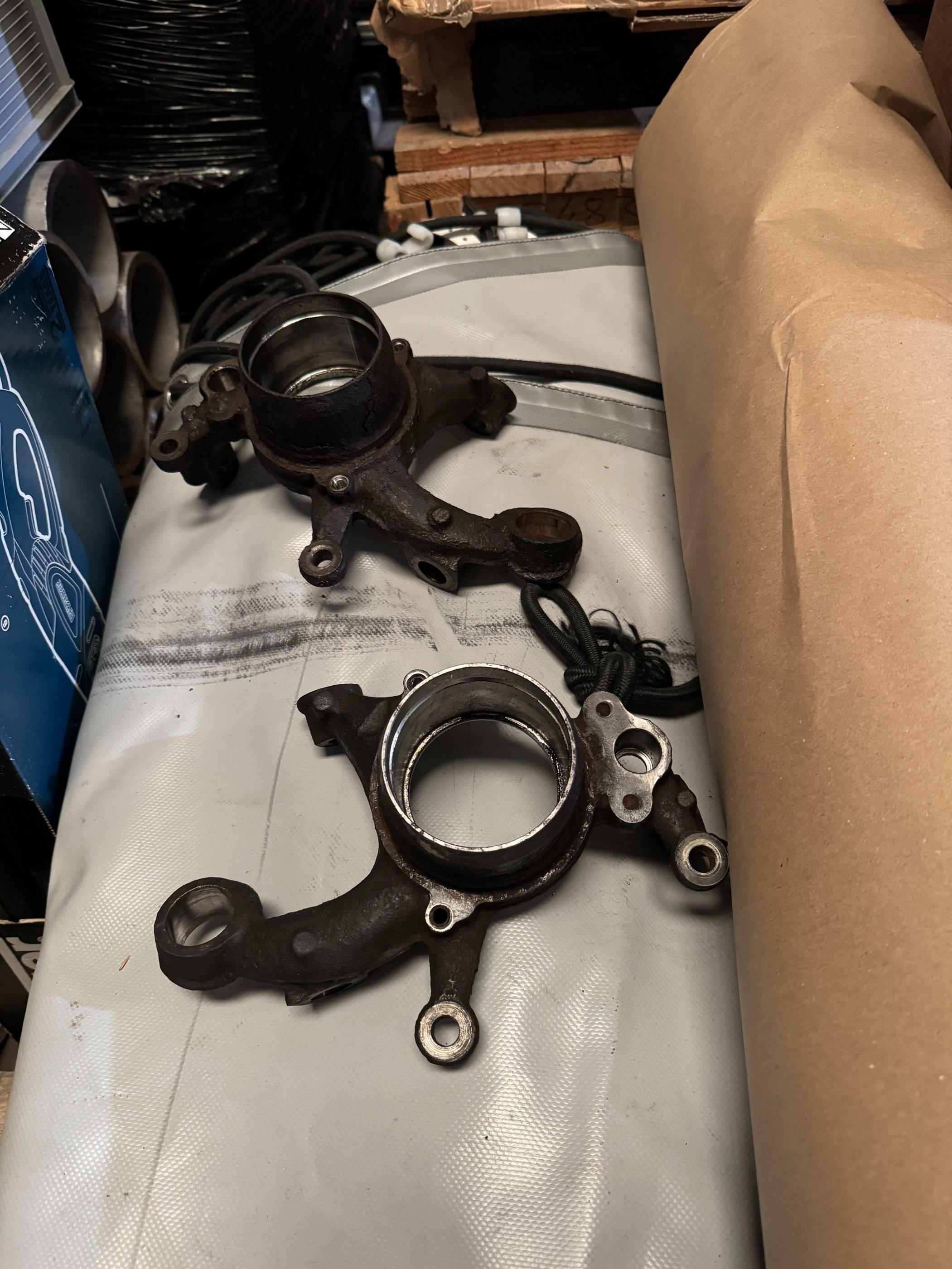

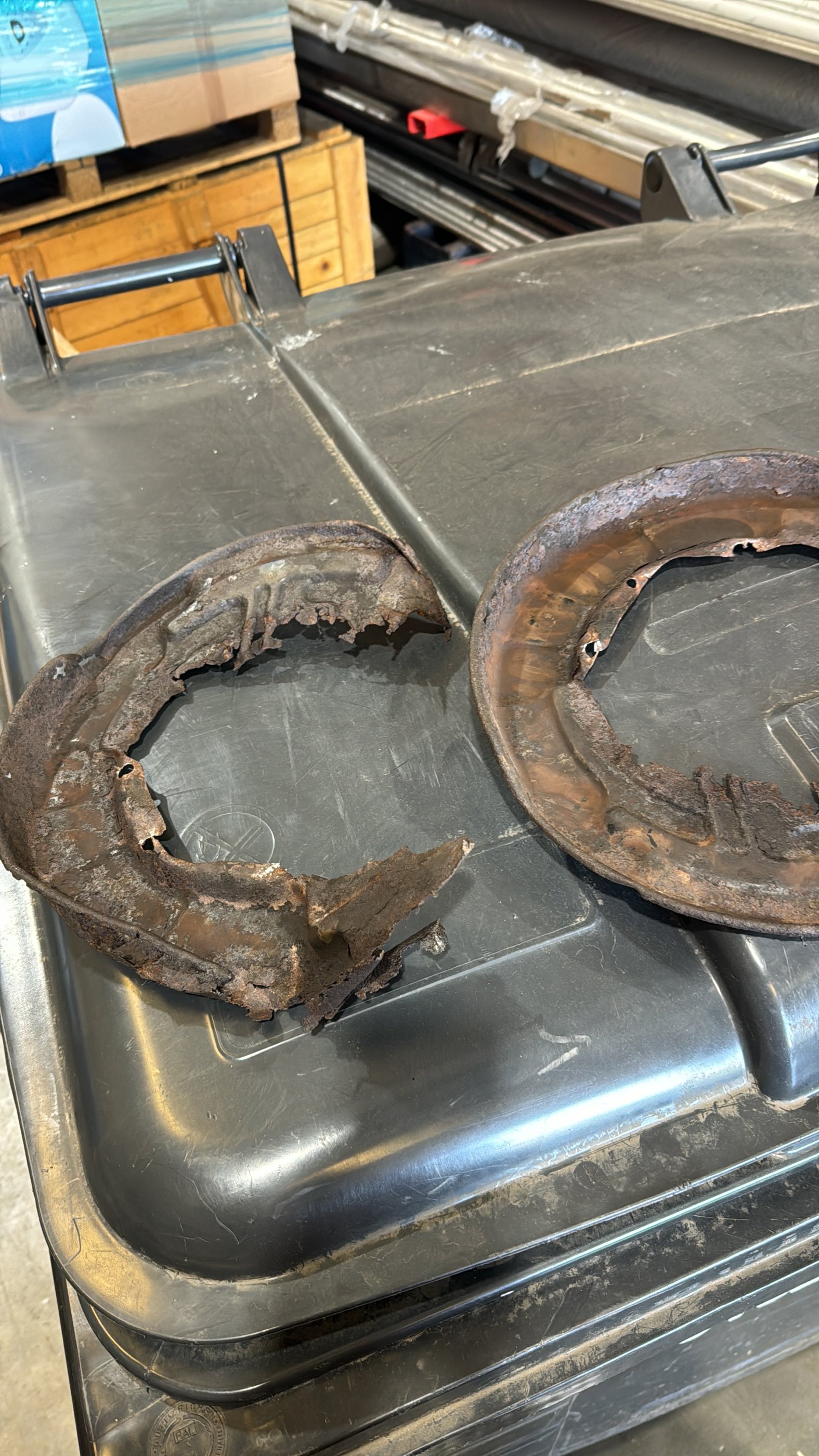

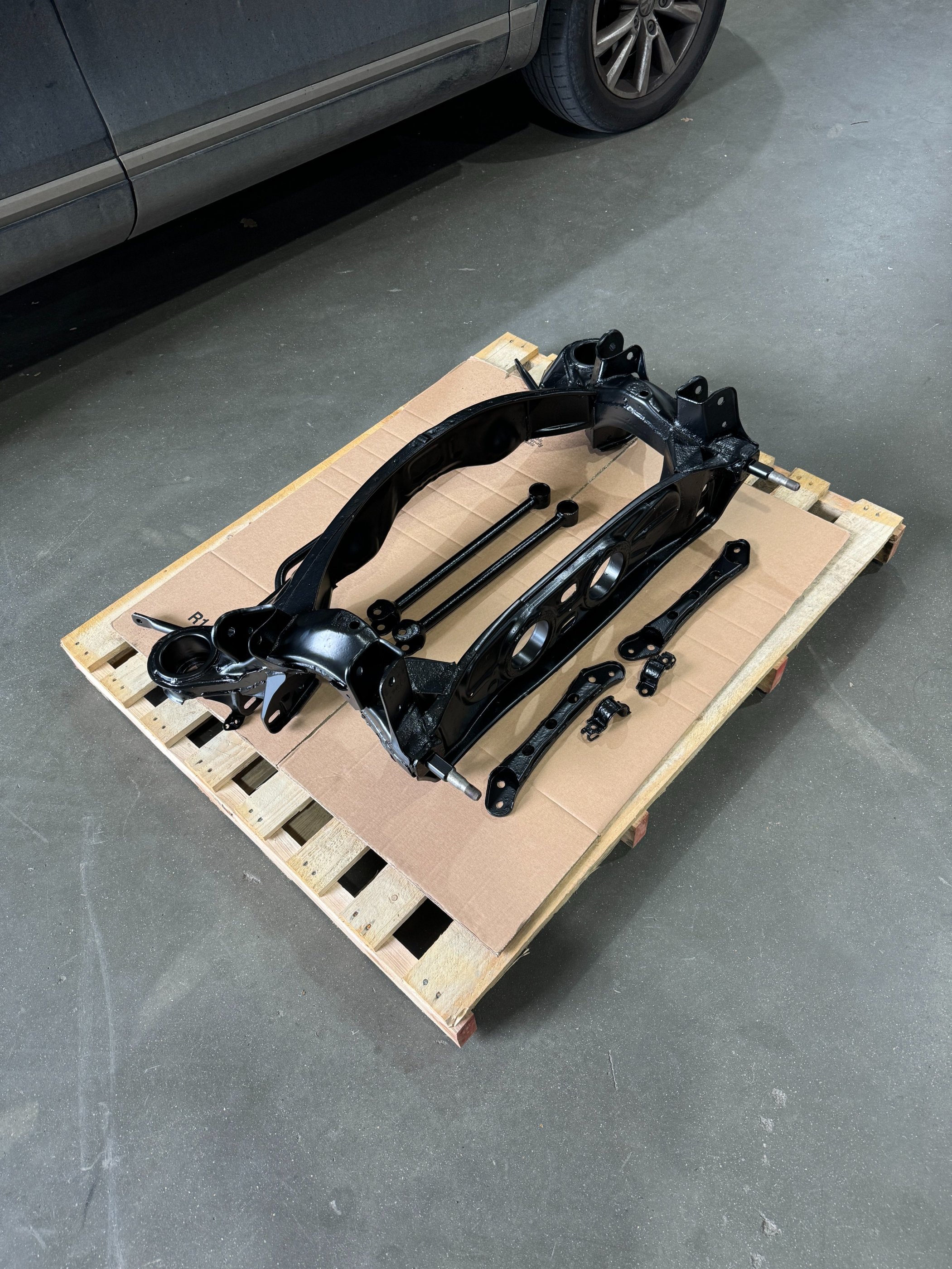

Making a start on disassembling the rear subframe today
  • Like 3

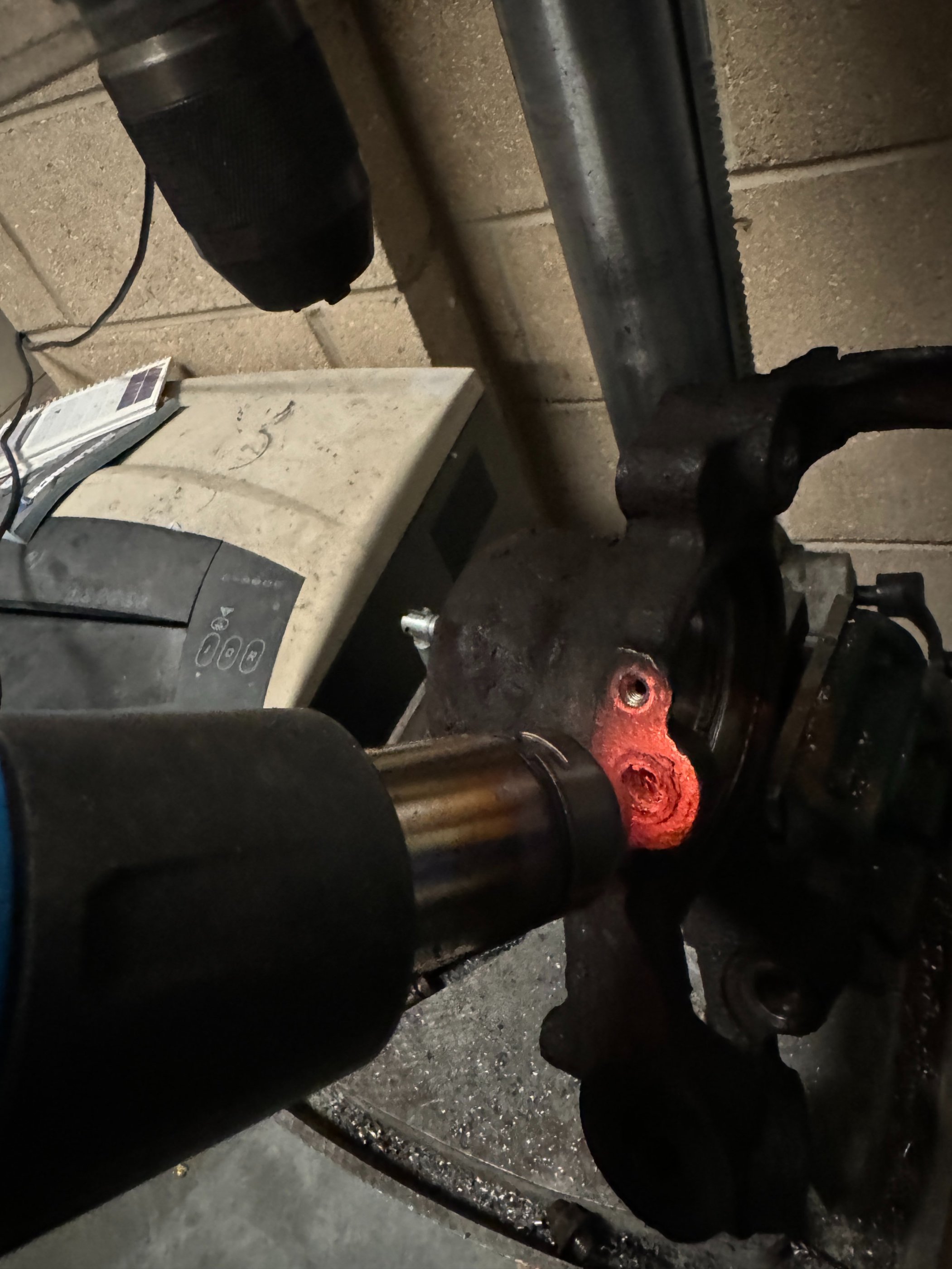

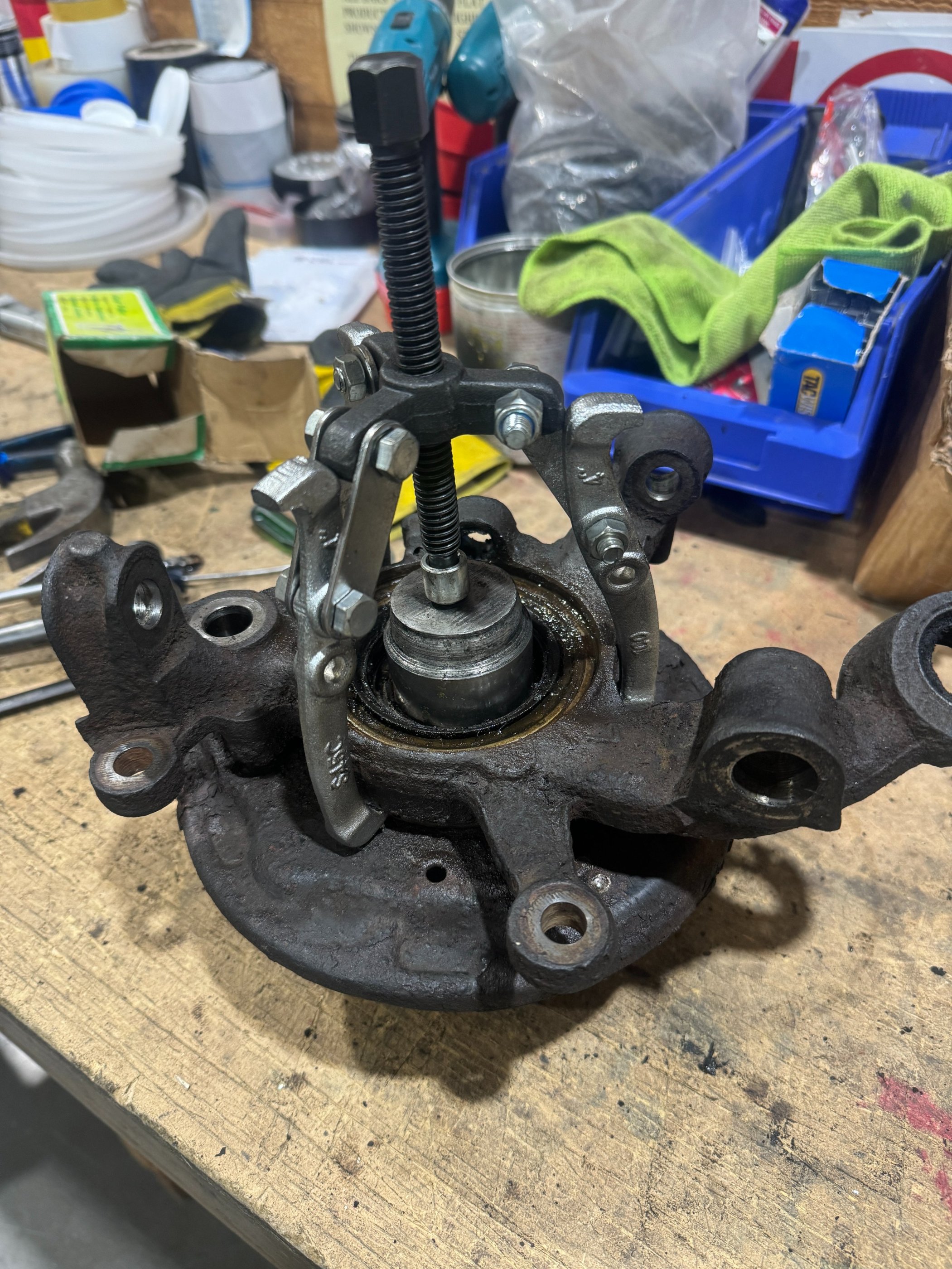

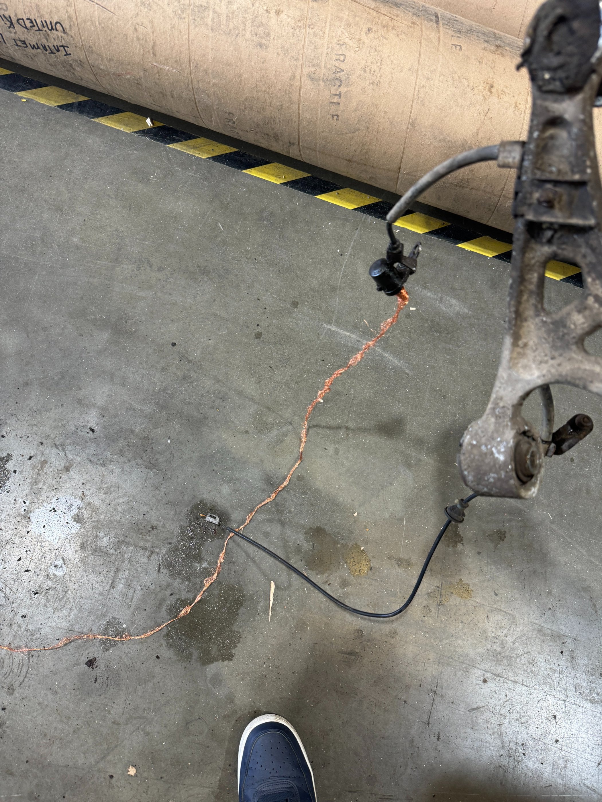

Yeh man, just starting splitting it to be painted but oh my days the rear abs sensors are causing me a headache to remove
3 hours ago, mwilkinson said:
I've been there - I had to buy new as mine were impossible to remove without breaking them.
I assume you've soaked them in penetrating oil?
Ah man, I feel like Ive tried everything. breaking them might be the only way now annoyingly
yeh soaked in penetrating oil but not budging even made a tool to push from inside but does nothing
