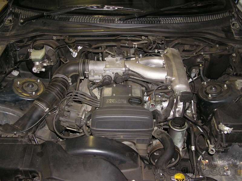

Dazzi Posted May 17, 2015 Share Posted May 17, 2015 Link to comment Share on other sites More sharing options...
bluedrag Posted May 18, 2015 Share Posted May 18, 2015 isnt the IACV in front of the trottle body on a NA? the left hand of the two plug fittings on this image? Link to comment Share on other sites More sharing options...
Dazzi Posted May 18, 2015 Share Posted May 18, 2015 Yep the left one next to throttle position sensor Link to comment Share on other sites More sharing options...
