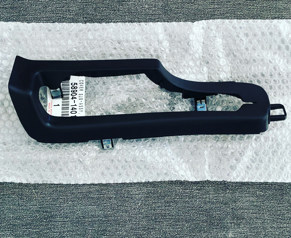

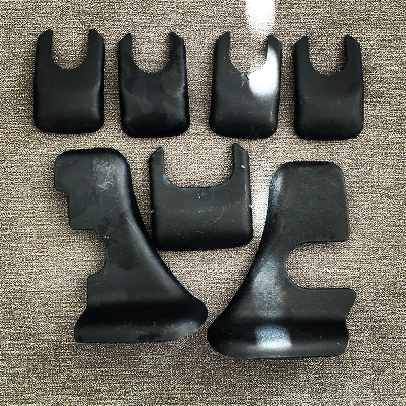

Supra-love Posted July 3, 2020 Author Share Posted July 3, 2020 (edited) New handbrake surround, old one has some clips broken. Driving my OCD mad Edited August 26, 2020 by Supra-love (see edit history) Link to comment Share on other sites More sharing options...

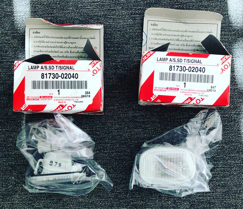

Supra-love Posted July 3, 2020 Author Share Posted July 3, 2020 (edited) Clear side repeaters to go. New Jesus/grip assist kit. The passengers will need this! Edited August 26, 2020 by Supra-love (see edit history) Link to comment Share on other sites More sharing options...

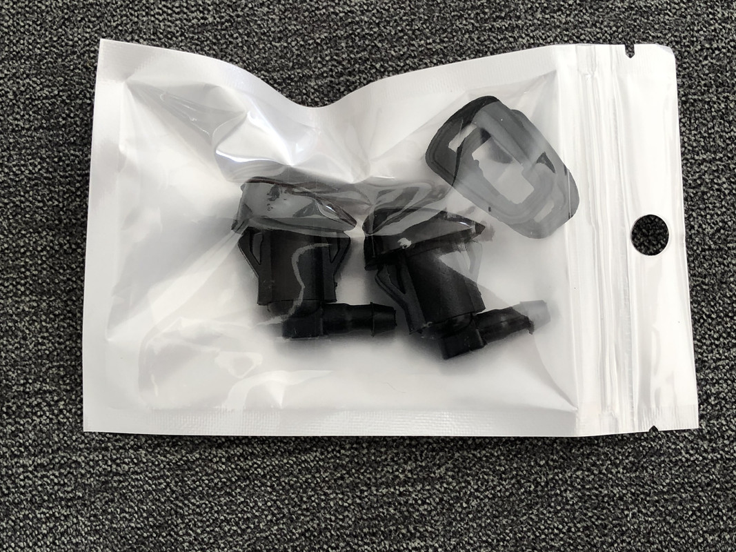

Supra-love Posted July 3, 2020 Author Share Posted July 3, 2020 (edited) Had missing seat bolt covers so managed to get these for now, Decent spray patterned wind washer nozzles and a Key pouch for those new spare keys Edited August 26, 2020 by Supra-love (see edit history) Link to comment Share on other sites More sharing options...

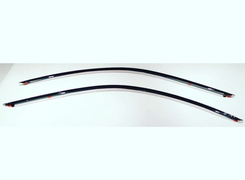

Supra-love Posted July 3, 2020 Author Share Posted July 3, 2020 (edited) Set of genuine wind deflectors. Edited August 26, 2020 by Supra-love (see edit history) Link to comment Share on other sites More sharing options...
Peter P Posted July 3, 2020 Share Posted July 3, 2020 Set of genuine wind deflectors on order. [ATTACH=CONFIG]236812[/ATTACH] [ATTACH=CONFIG]236813[/ATTACH] Nice collection of new parts you have there mate. Can you PM me the cost and where you ordered the wind deflectors from please mate? Part numbers would be fab as well if you don’t mind sharing. Keep up the great work. Cheers, Pete Link to comment Share on other sites More sharing options...
Supra-love Posted July 3, 2020 Author Share Posted July 3, 2020 Nice collection of new parts you have there mate. Can you PM me the cost and where you ordered the wind deflectors from please mate? Part numbers would be fab as well if you don’t mind sharing. Keep up the great work. Cheers, Pete Thanks mate. Yeah got a lot of parts to be fitted when she gets back now. The parts number for the two set of deflectors is in the pic mate, just google and go with what you can afford on the results. I got mine from a bidding site in Japan, cost arm and leg! Link to comment Share on other sites More sharing options...

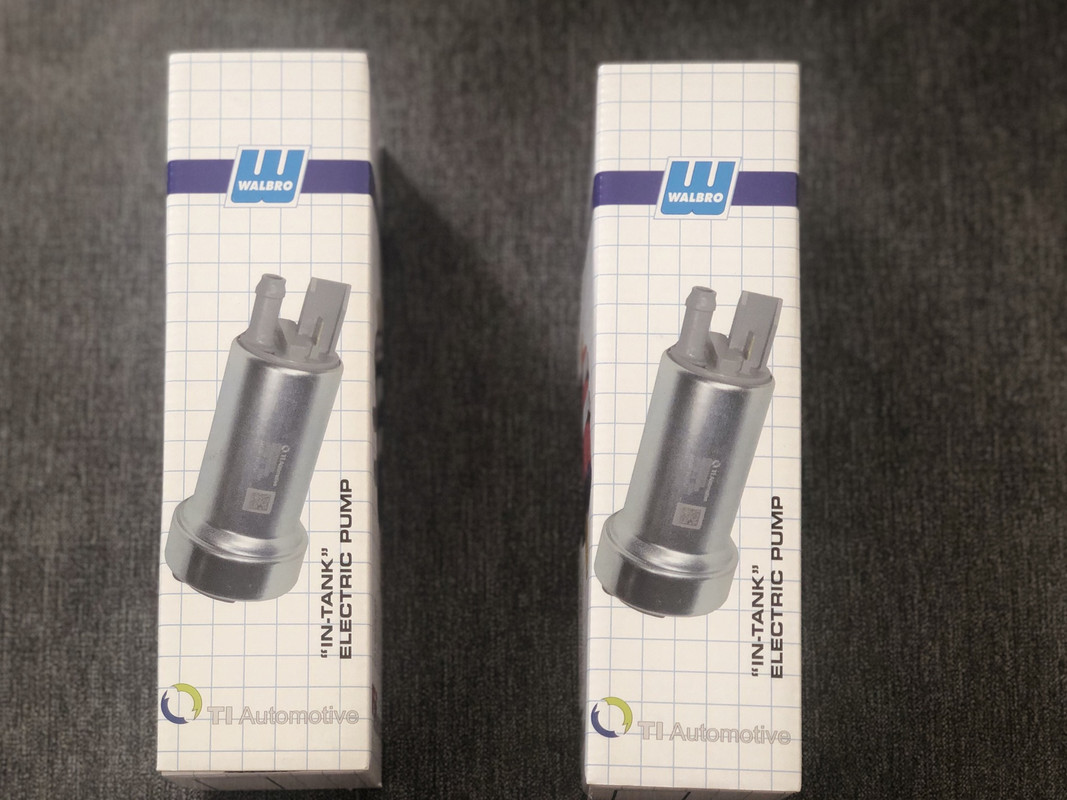

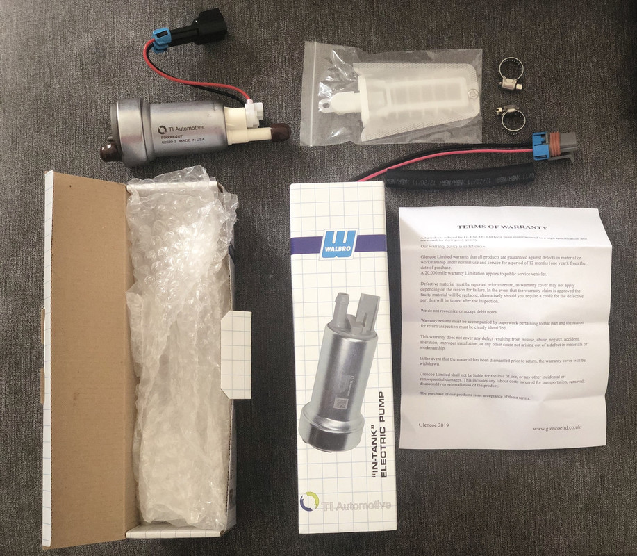

Supra-love Posted July 13, 2020 Author Share Posted July 13, 2020 (edited) Twin walbro GST450-KL 485 fuel pumps arrived today. From glencoeltd. Edited August 26, 2020 by Supra-love (see edit history) Link to comment Share on other sites More sharing options...

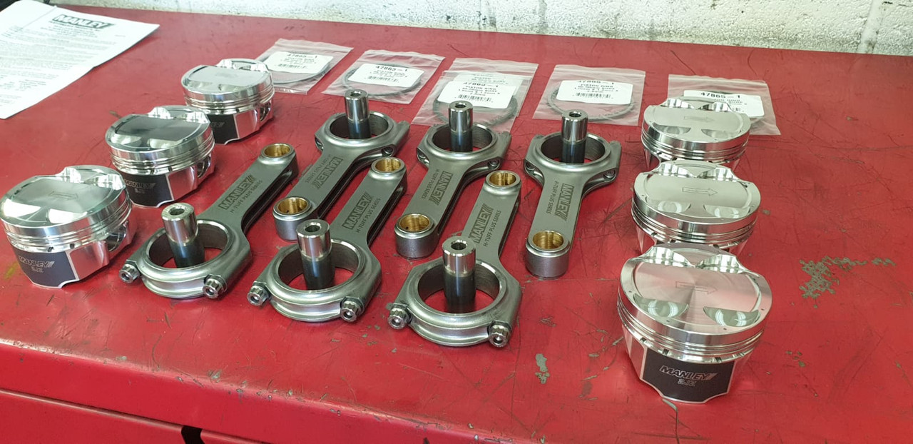

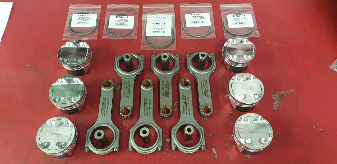

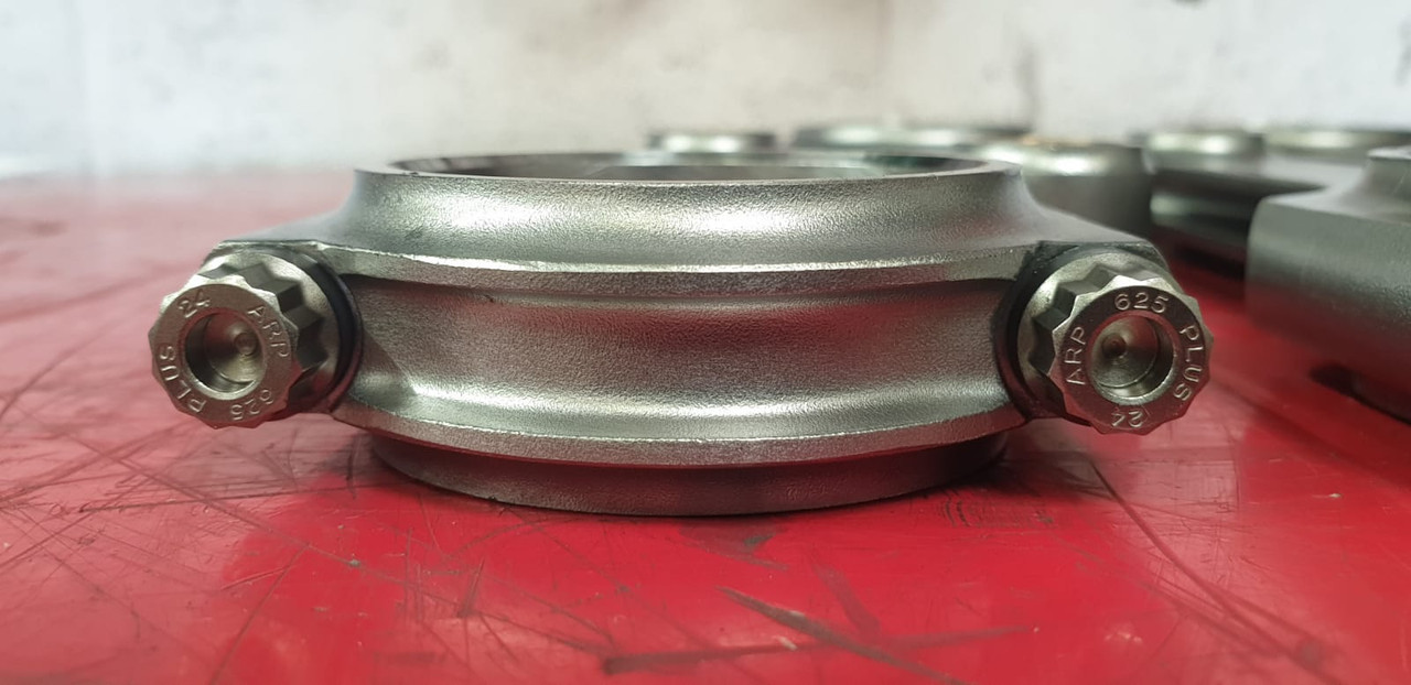

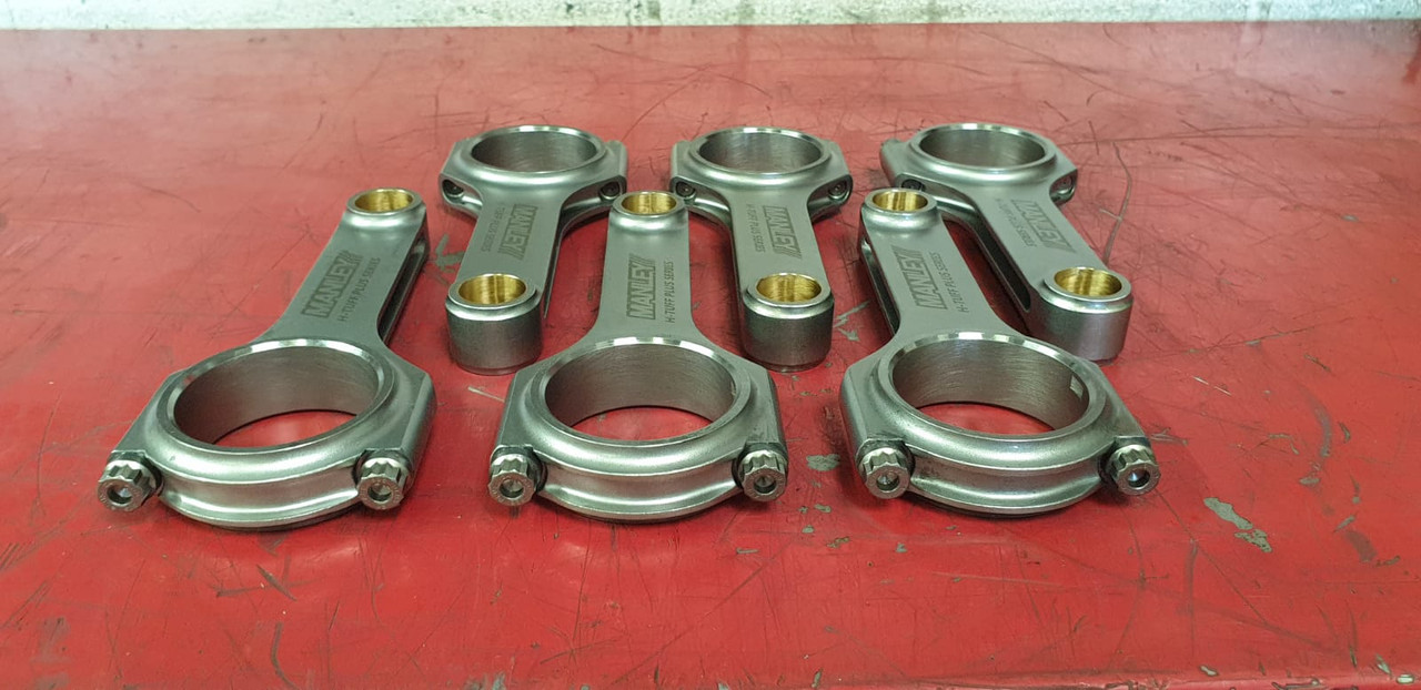

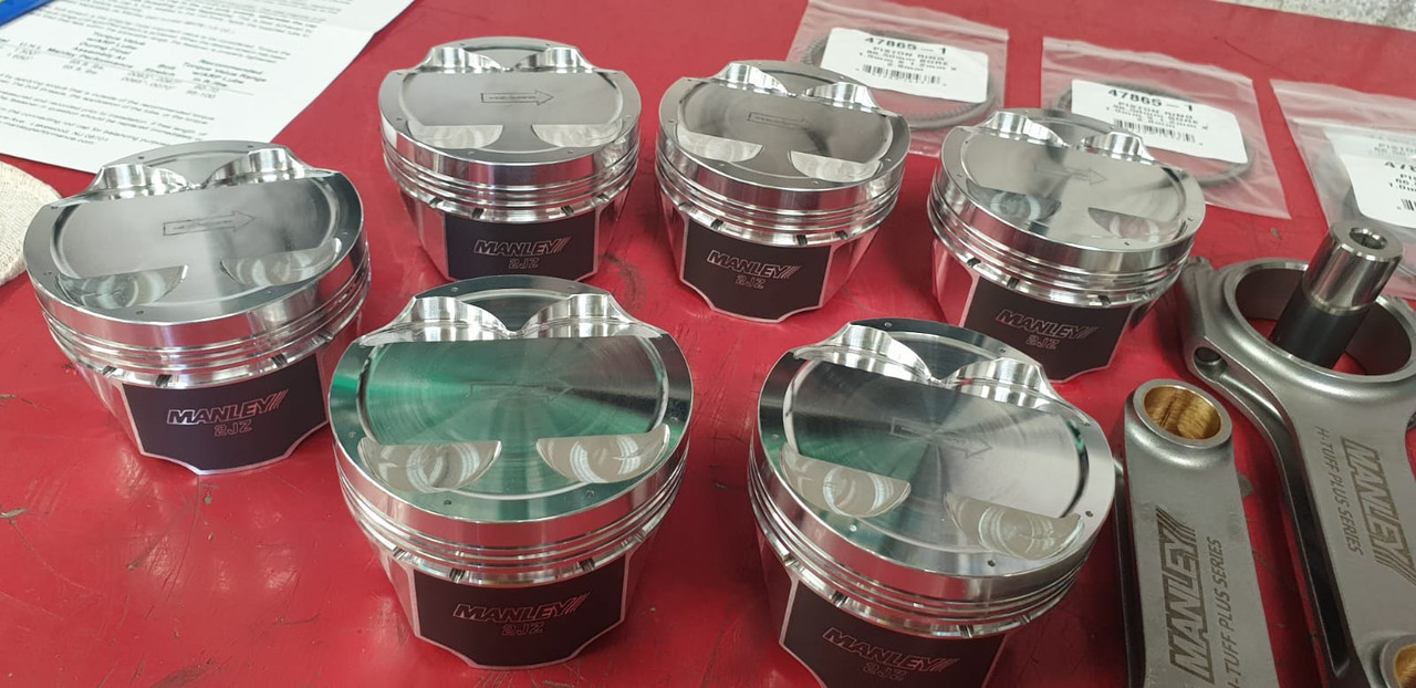

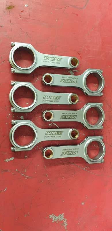

Supra-love Posted August 26, 2020 Author Share Posted August 26, 2020 (edited) Manley H-tuff 625 plus rods, Manley platinum series pistons and extreme wrist pins ready to battle Edited August 26, 2020 by Supra-love (see edit history) Link to comment Share on other sites More sharing options...

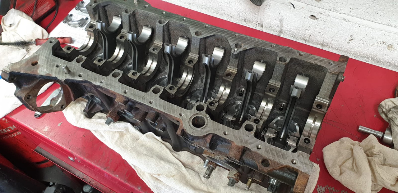

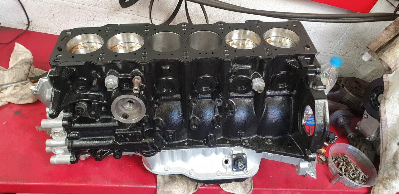

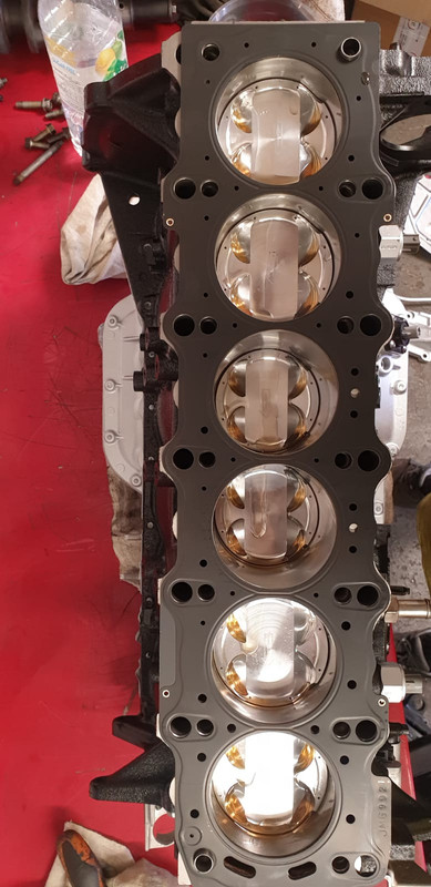

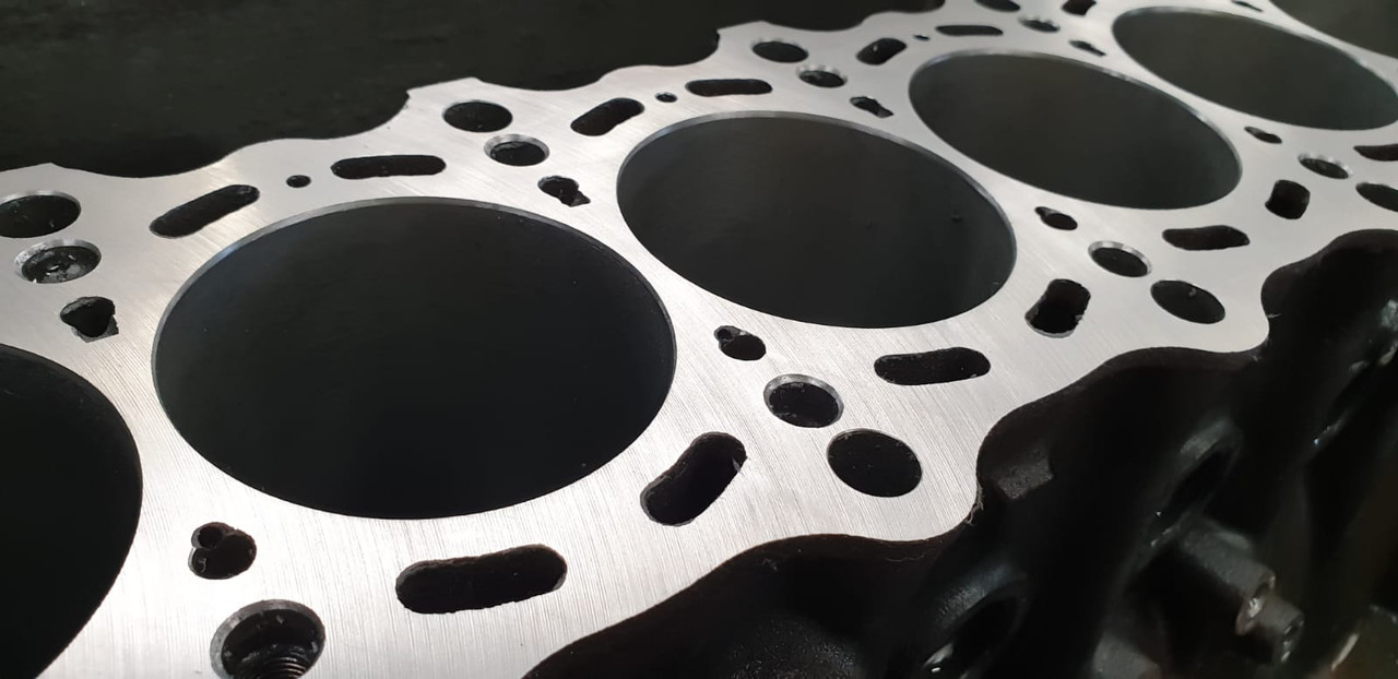

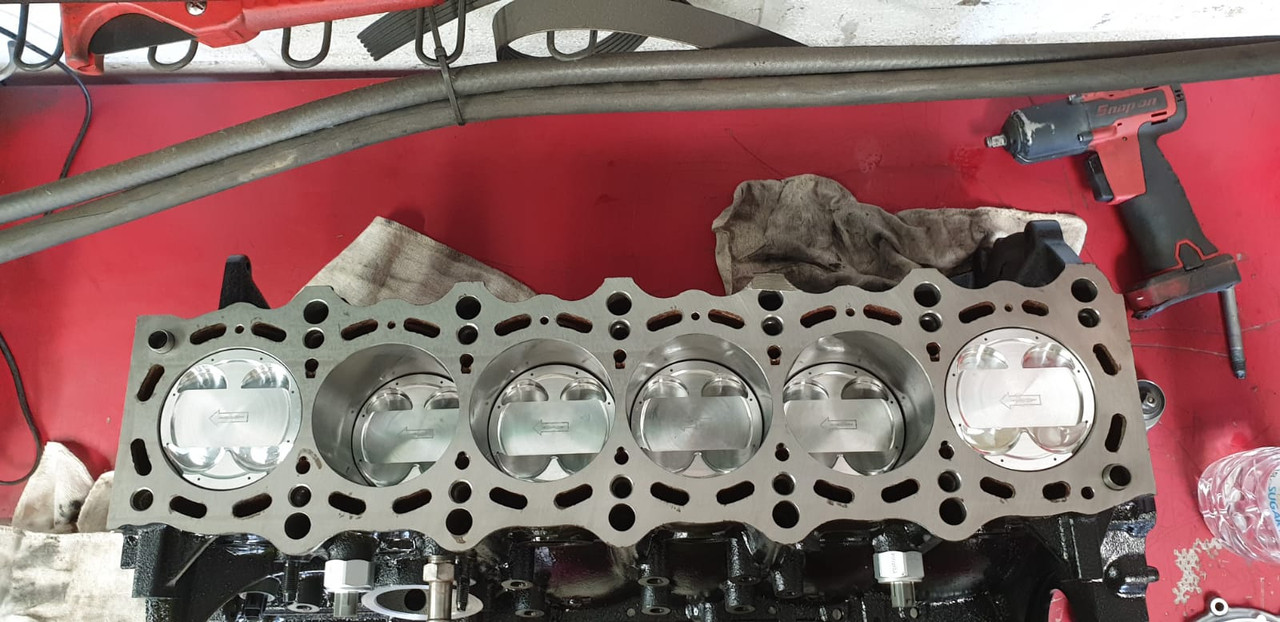

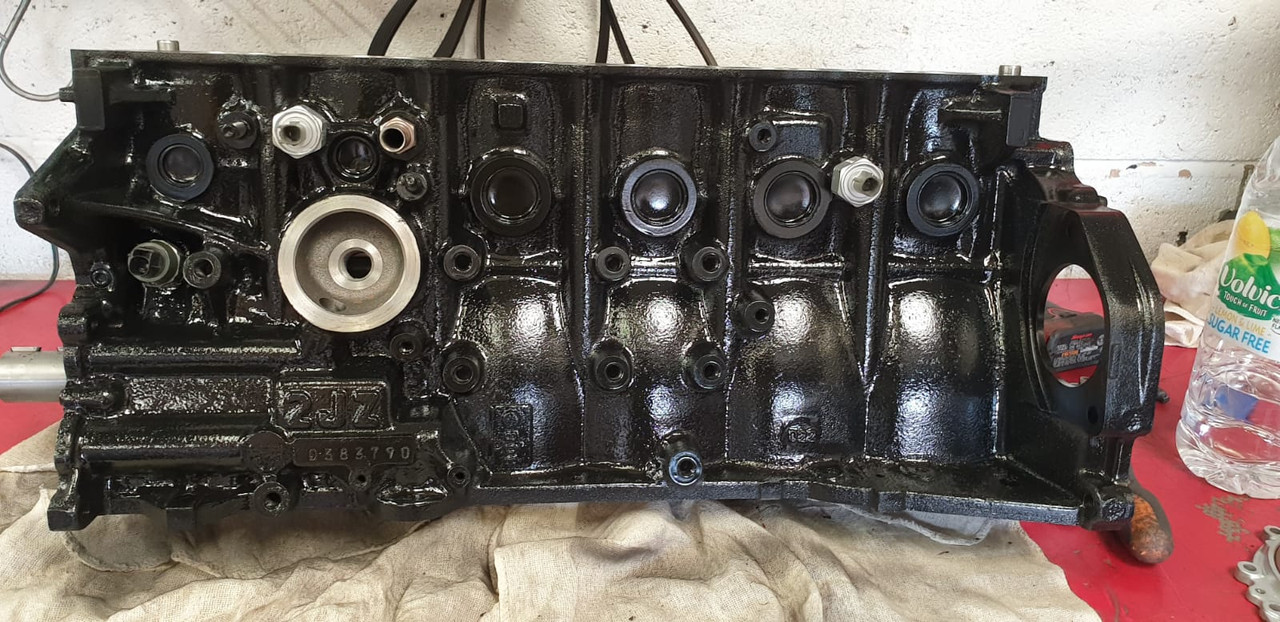

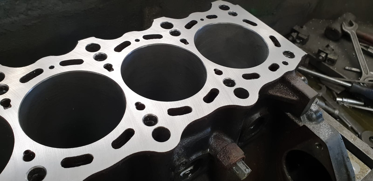

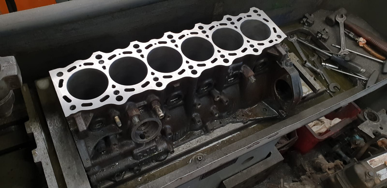

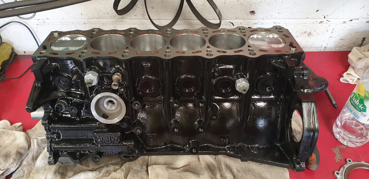

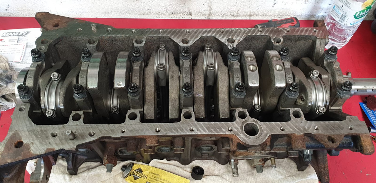

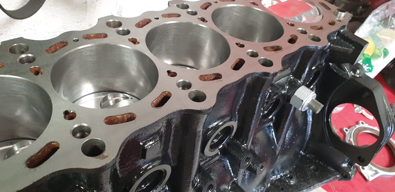

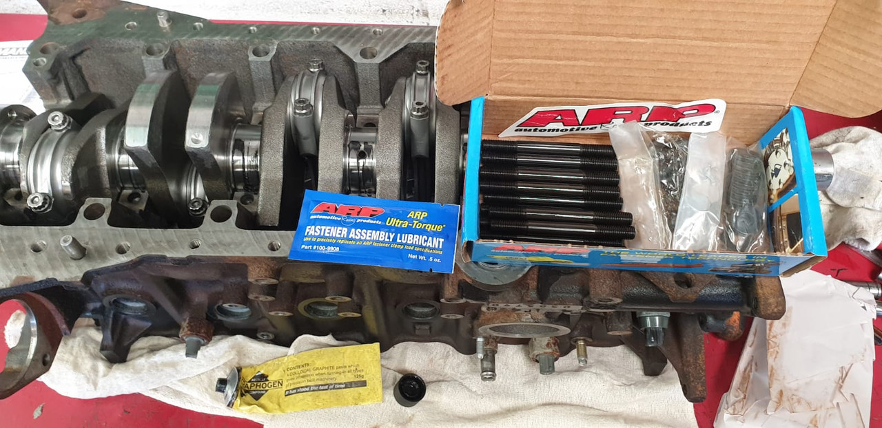

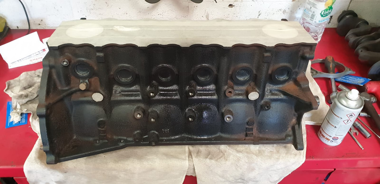

Supra-love Posted August 26, 2020 Author Share Posted August 26, 2020 (edited) Engine block prepped and getting those Manley parts fitted along with king race bearings. All micro polished and balanced - - - Updated - - - Edited August 26, 2020 by Supra-love (see edit history) Link to comment Share on other sites More sharing options...

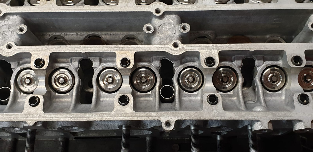

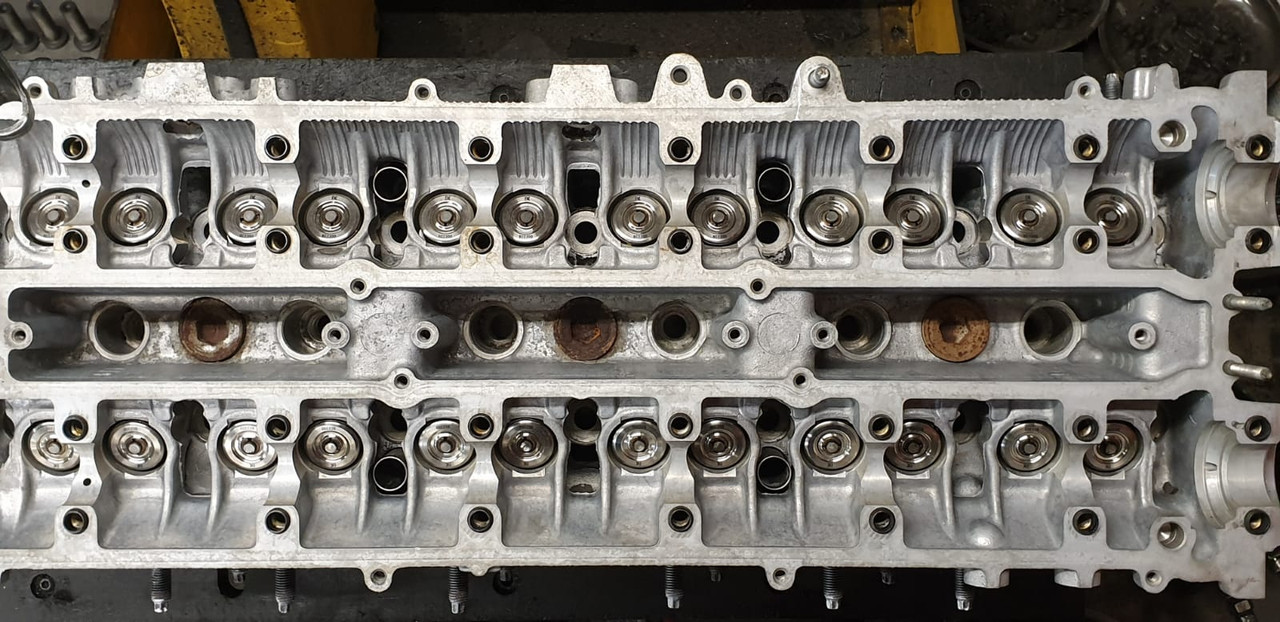

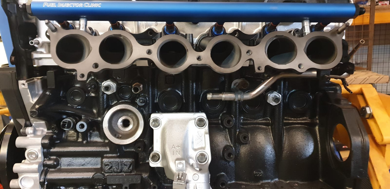

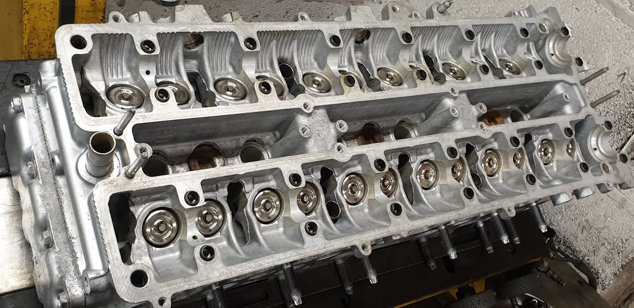

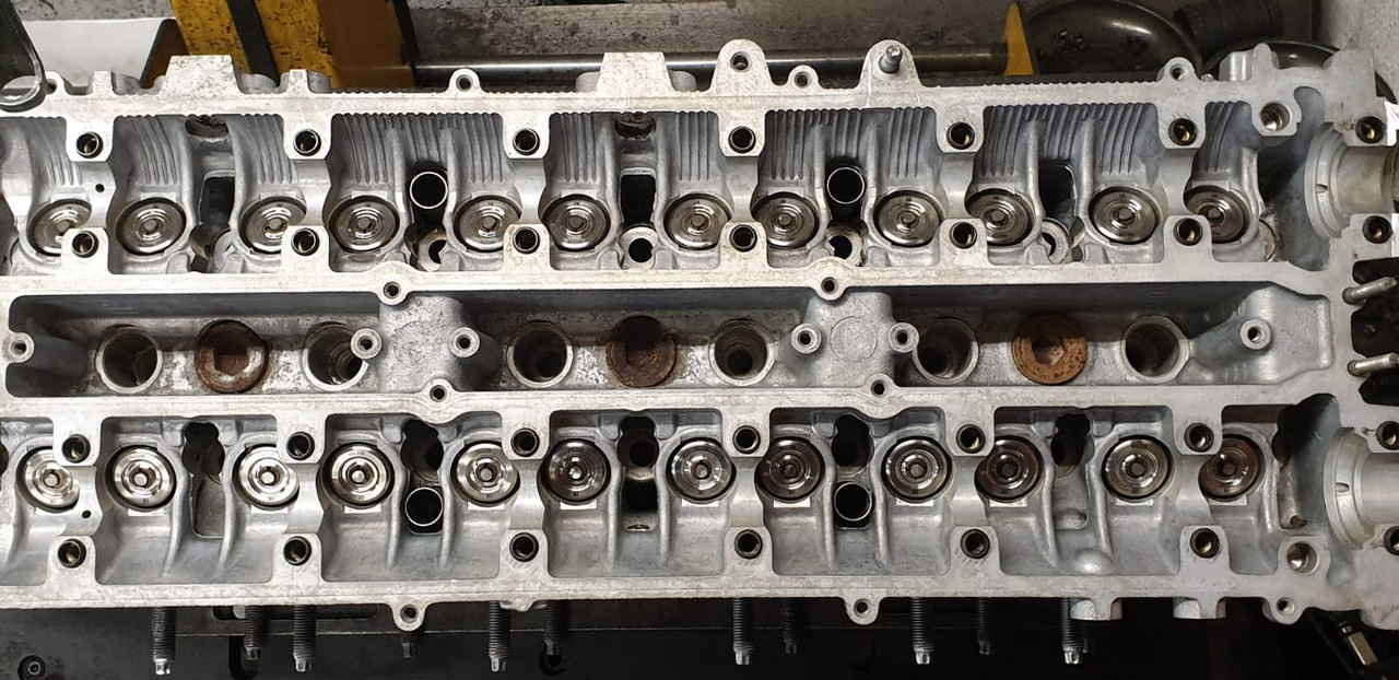

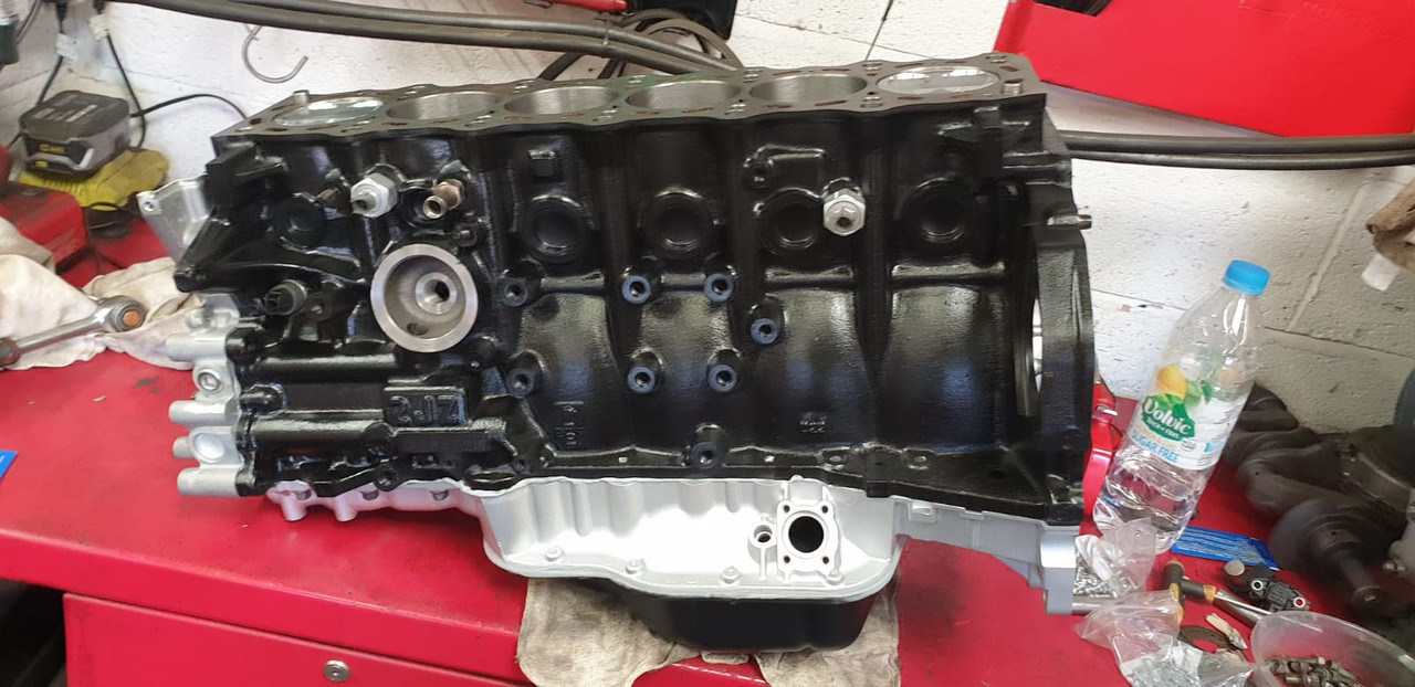

Supra-love Posted August 26, 2020 Author Share Posted August 26, 2020 (edited) block and cylinder head built up! - - - Updated - - - Edited August 26, 2020 by Supra-love (see edit history) Link to comment Share on other sites More sharing options...

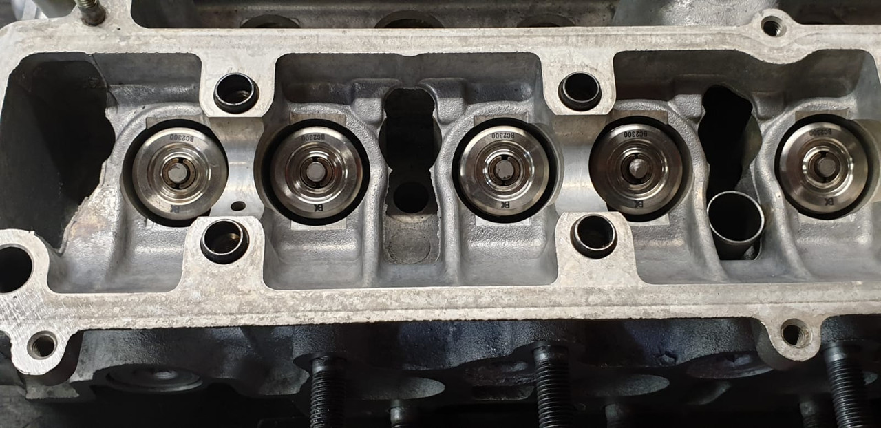

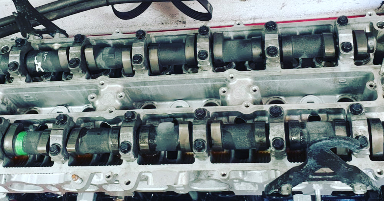

Supra-love Posted August 26, 2020 Author Share Posted August 26, 2020 (edited) Brian crower 264 cams fitted Edited August 26, 2020 by Supra-love (see edit history) Link to comment Share on other sites More sharing options...

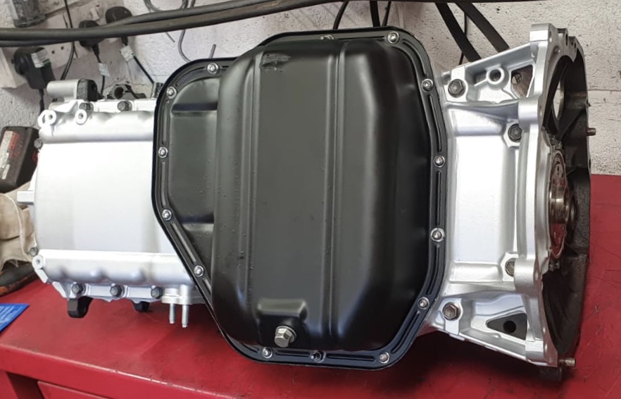

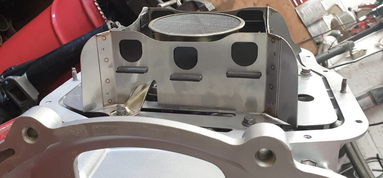

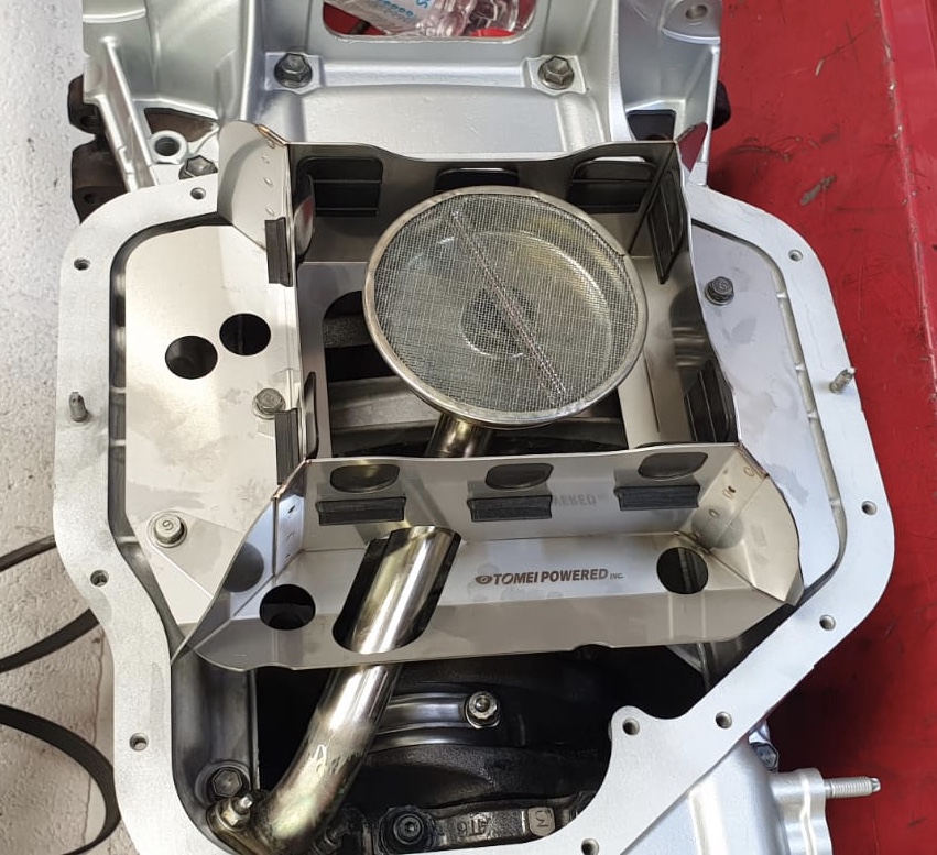

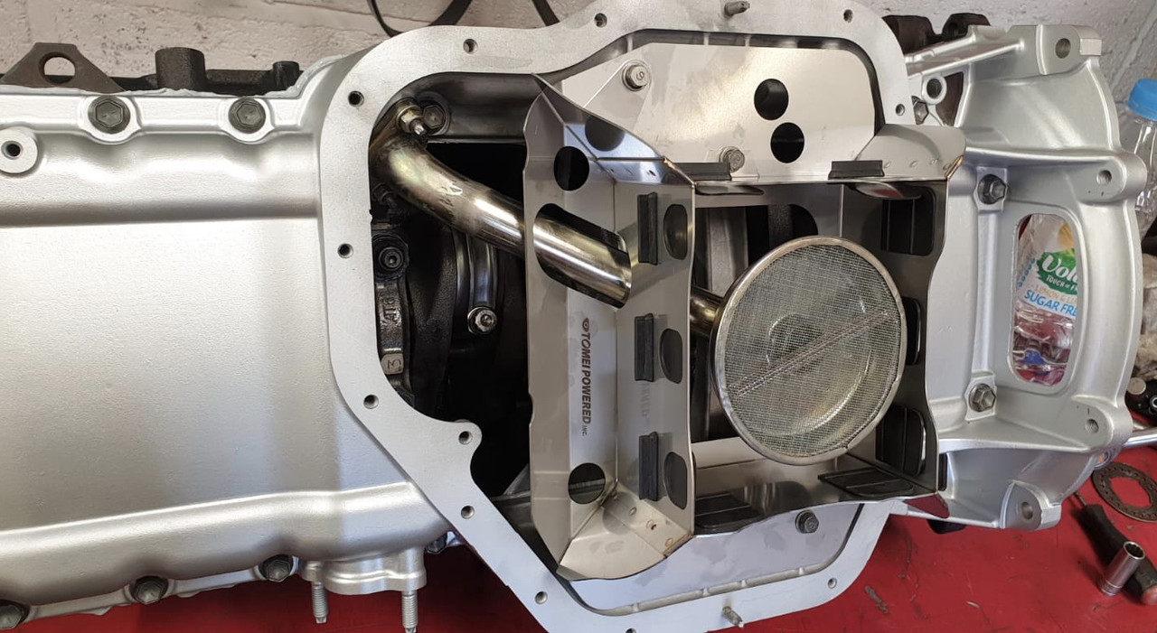

Supra-love Posted August 26, 2020 Author Share Posted August 26, 2020 (edited) Tomei baffles sump fitted, saving engine oil starvation Edited August 26, 2020 by Supra-love (see edit history) Link to comment Share on other sites More sharing options...

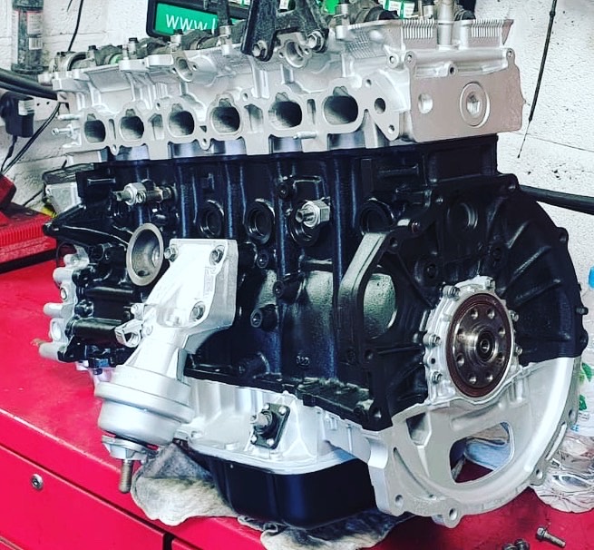

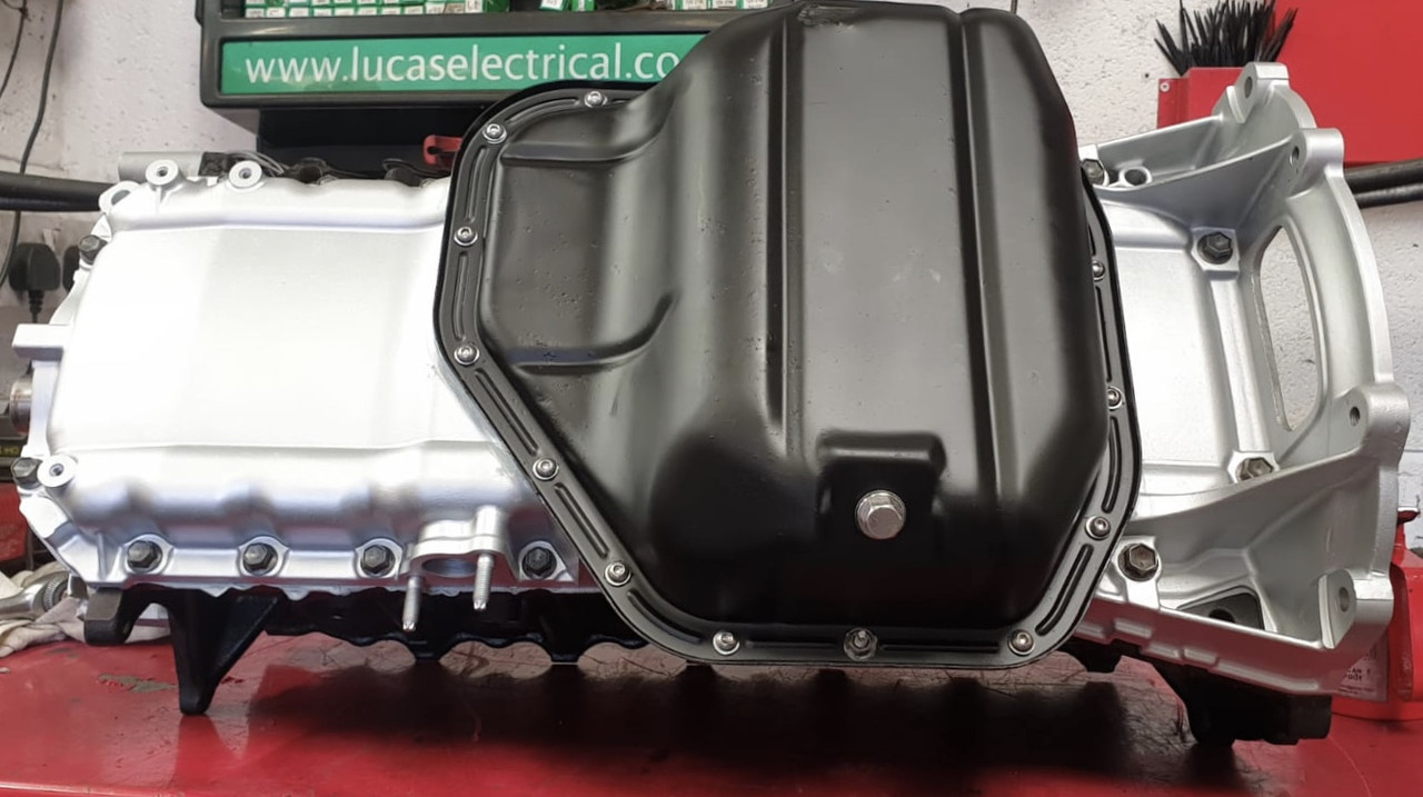

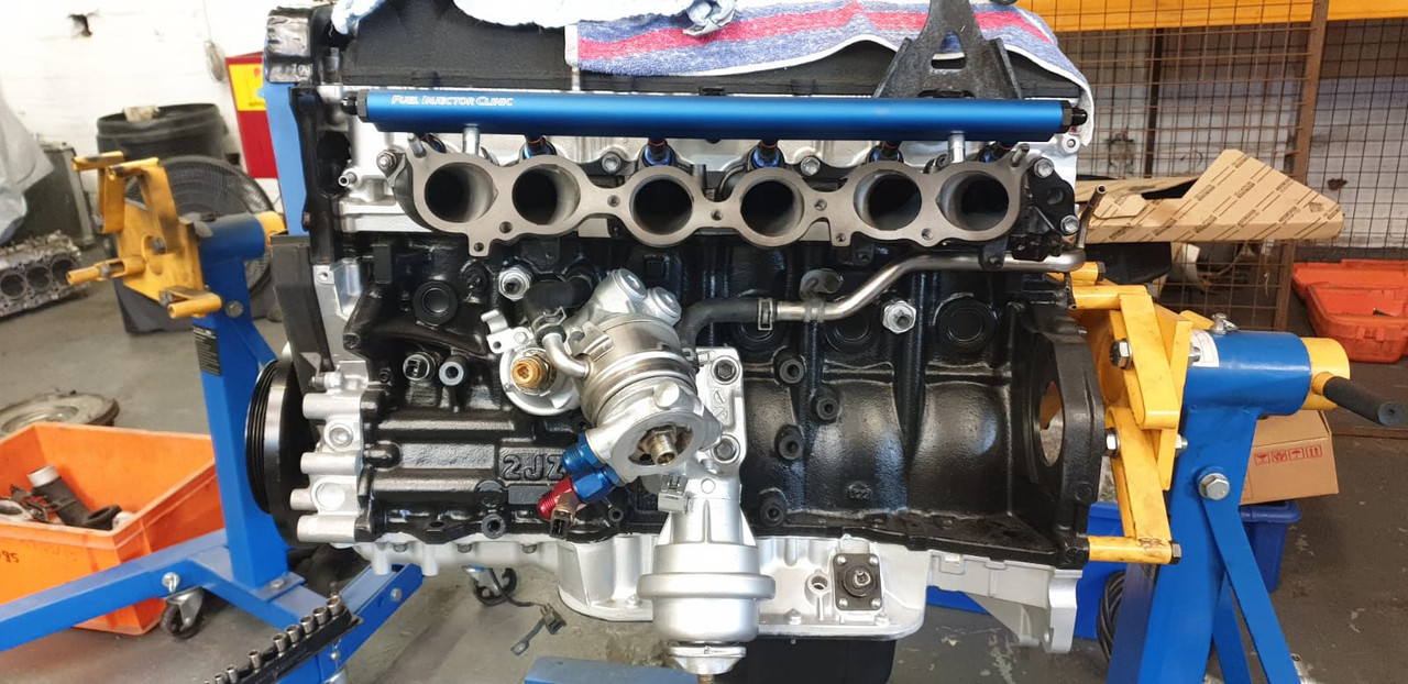

Supra-love Posted August 26, 2020 Author Share Posted August 26, 2020 (edited) Engine closed and ready for build up! Edited August 26, 2020 by Supra-love (see edit history) Link to comment Share on other sites More sharing options...

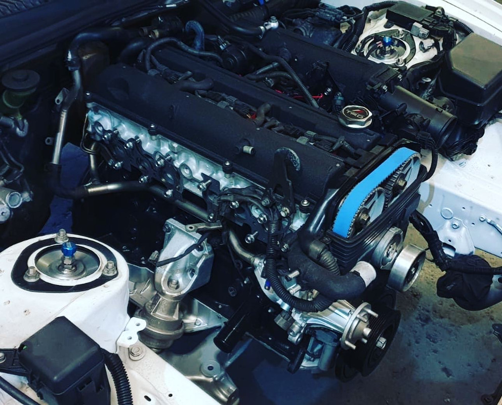

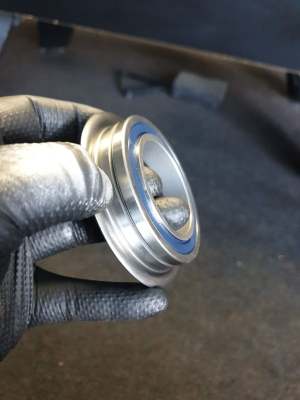

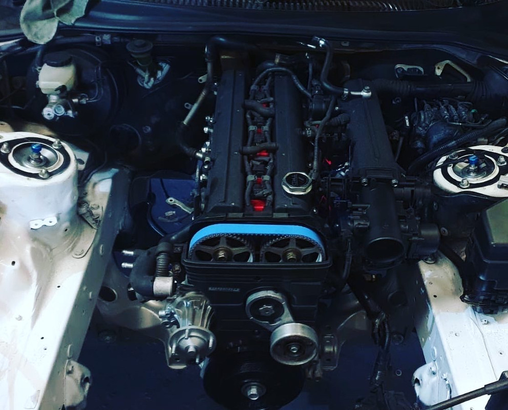

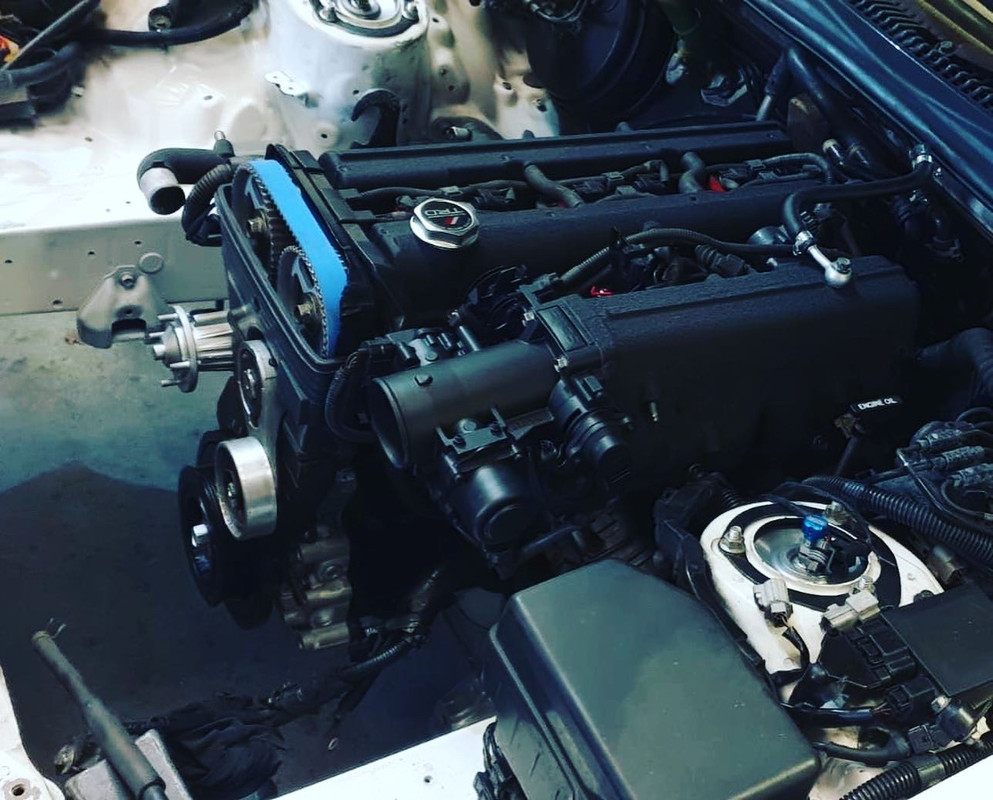

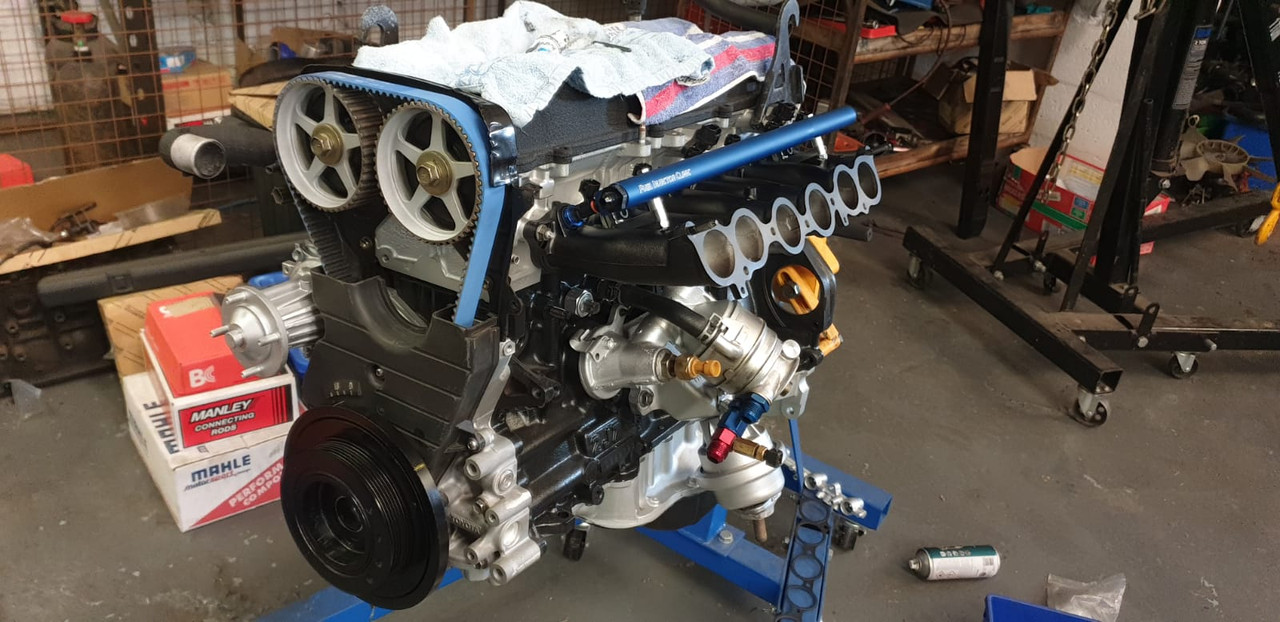

Supra-love Posted August 26, 2020 Author Share Posted August 26, 2020 (edited) Being built back up, gate racing timing belt, welded sprocket, billet tensioner all fitted your ready. Edited August 26, 2020 by Supra-love (see edit history) Link to comment Share on other sites More sharing options...

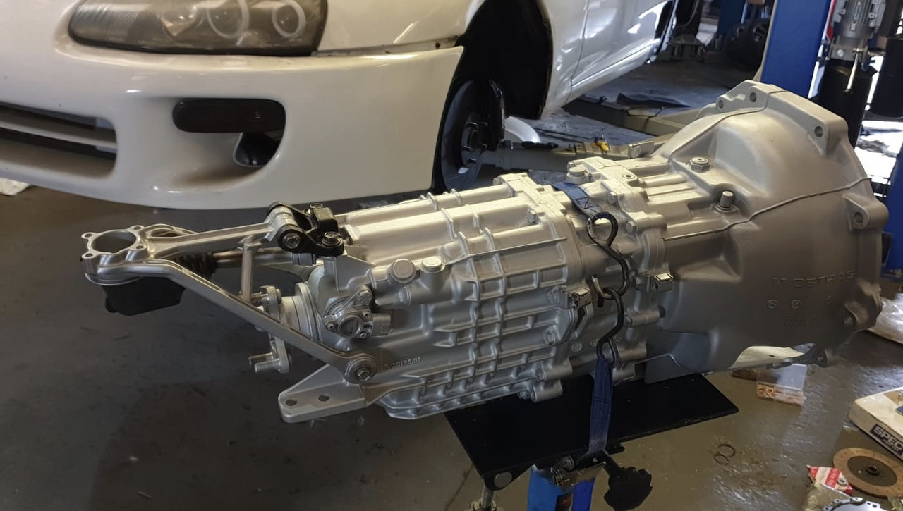

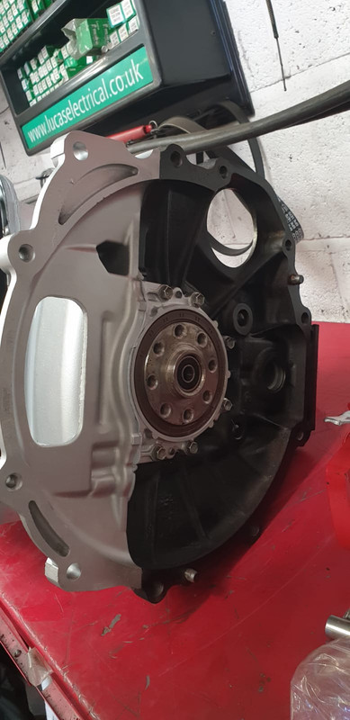

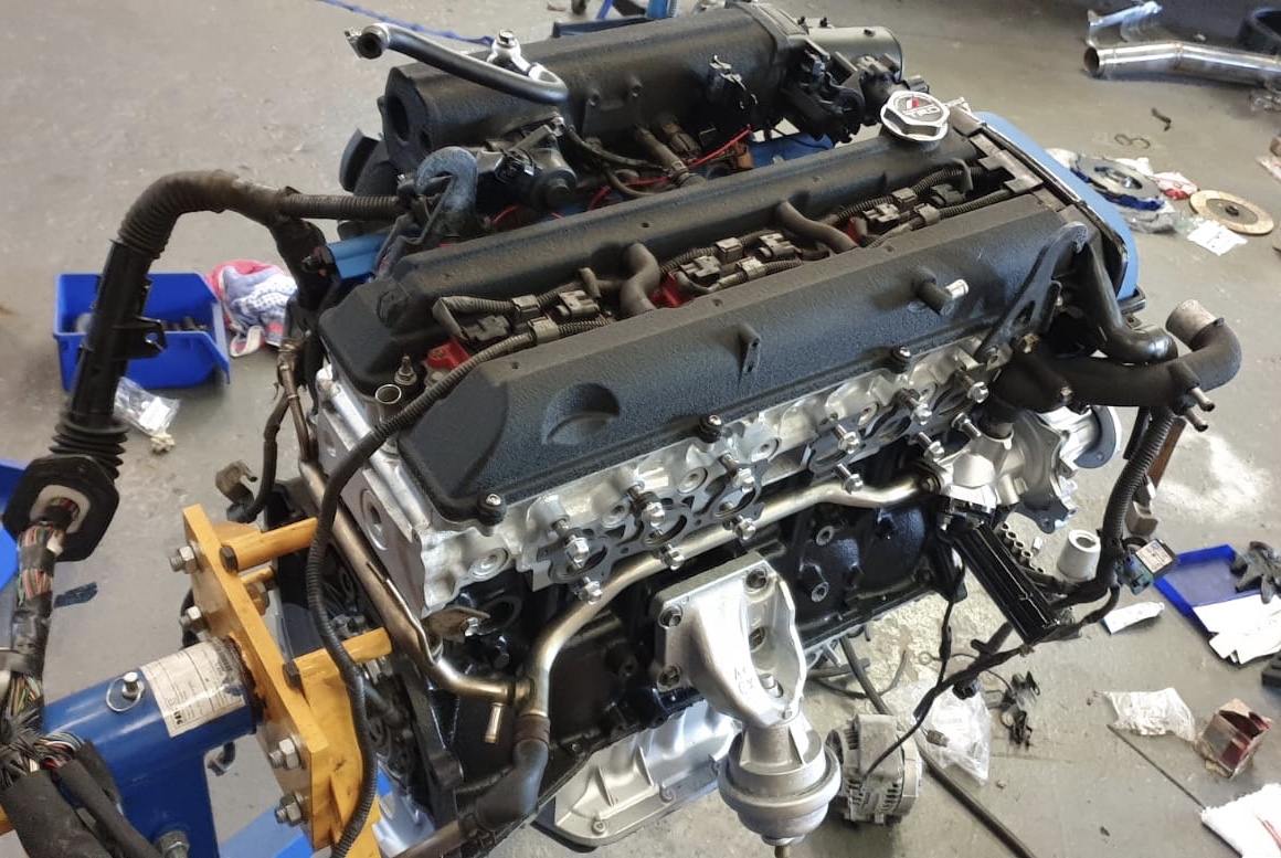

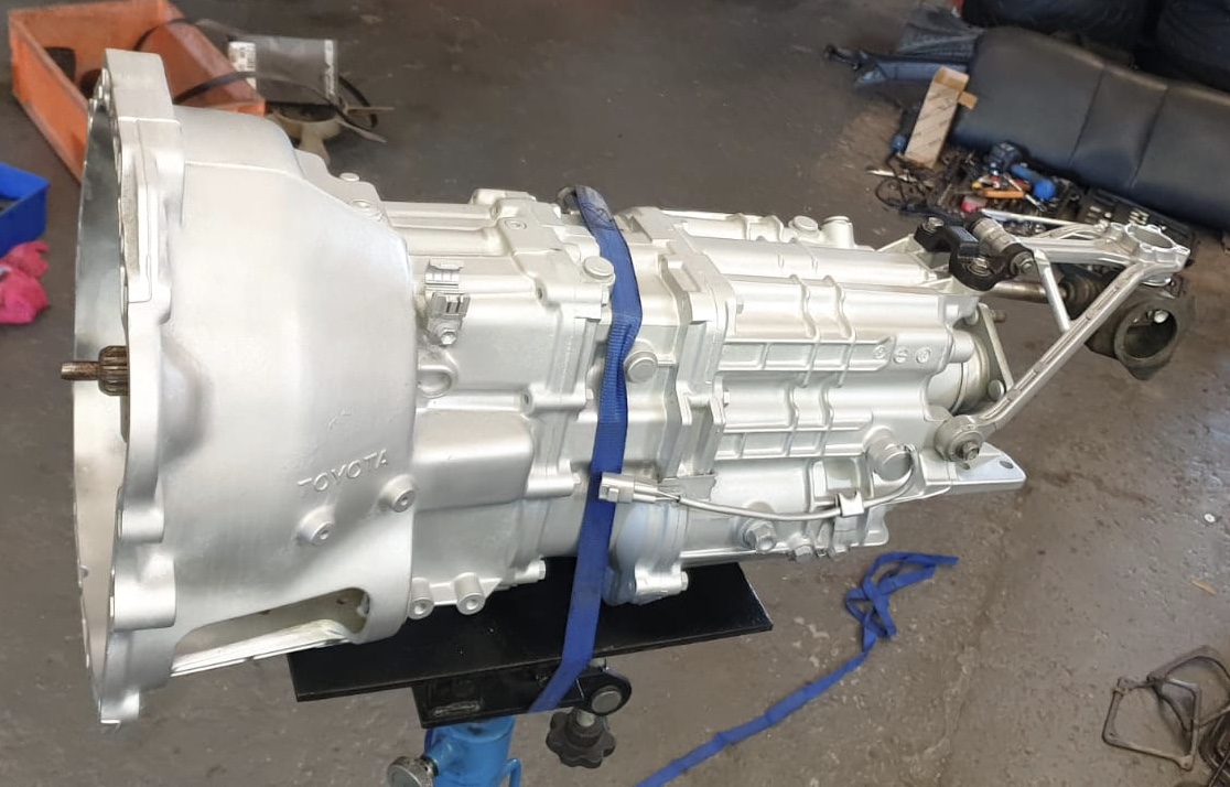

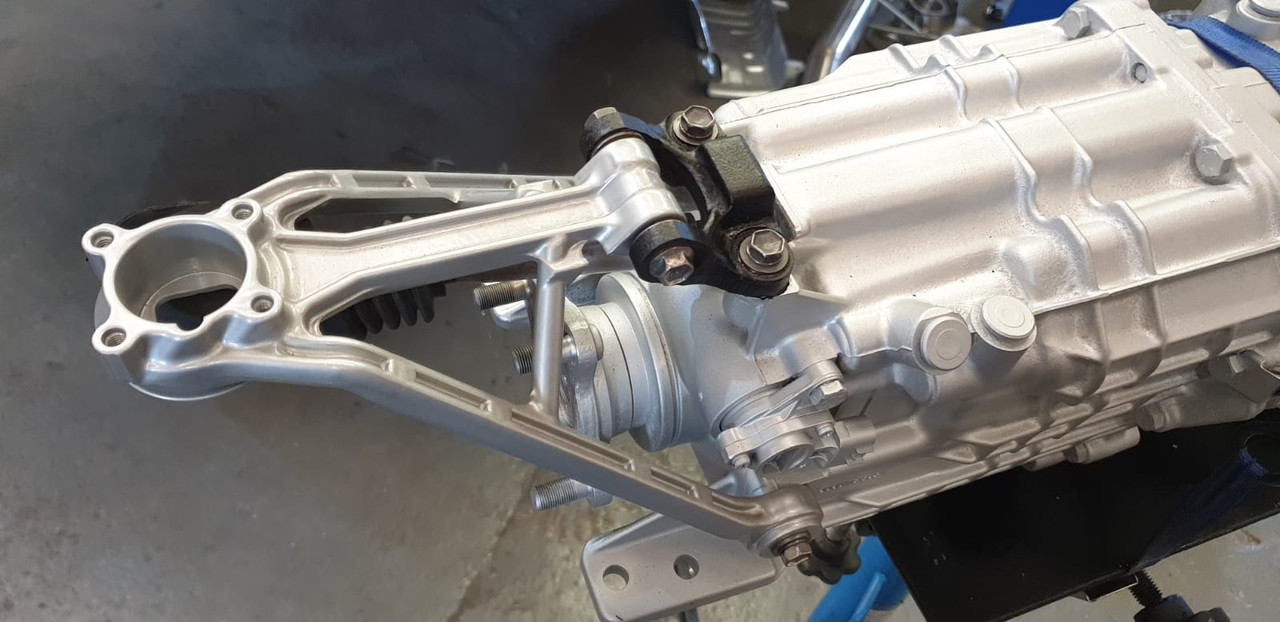

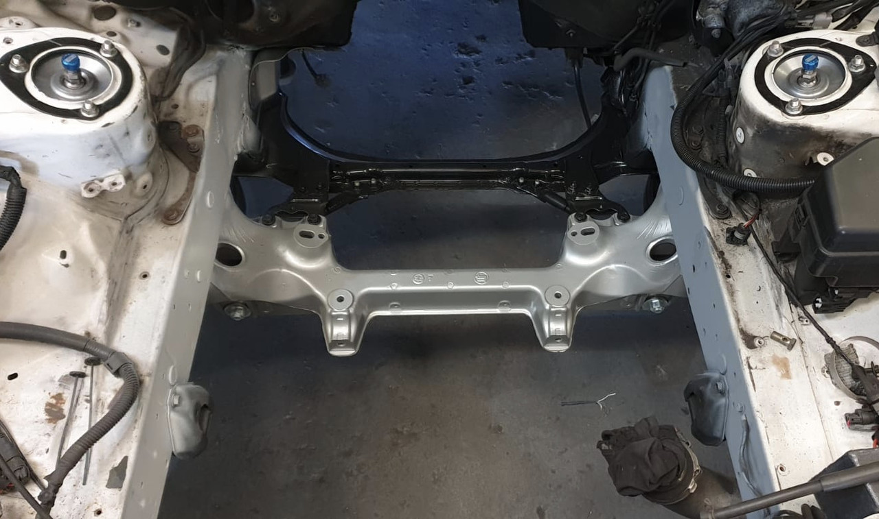

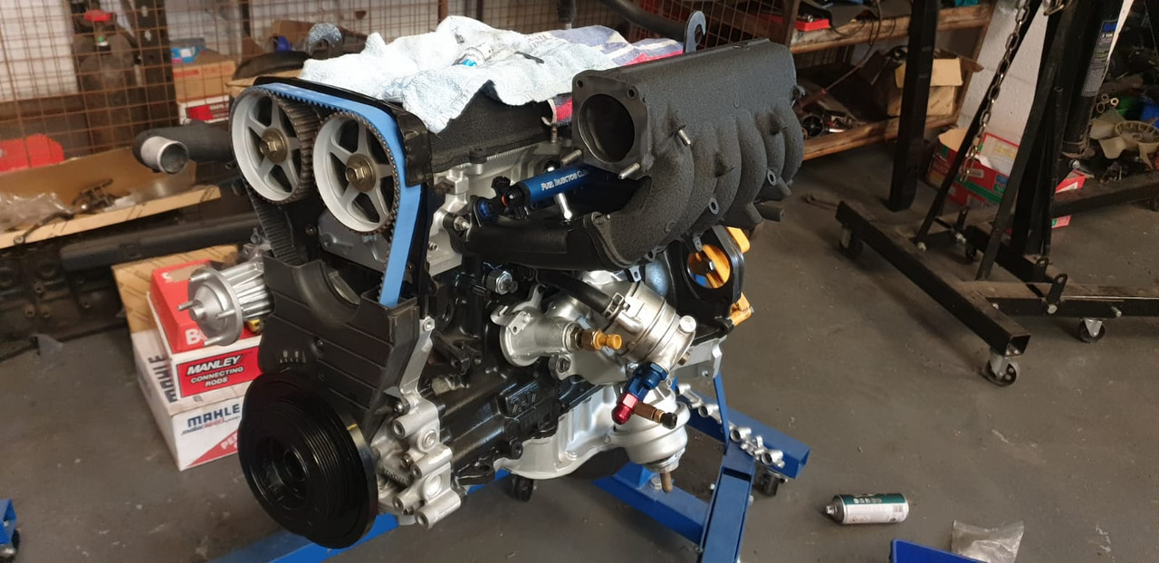

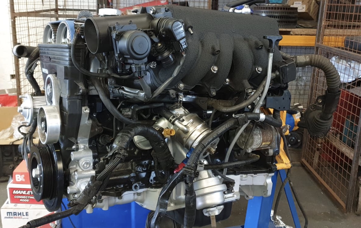

Supra-love Posted August 26, 2020 Author Share Posted August 26, 2020 (edited) Gearbox, spec 3+ new bearings, engine wired with ancillaries attached now! Nice picture of the fresh subframes too! Edited August 26, 2020 by Supra-love (see edit history) Link to comment Share on other sites More sharing options...

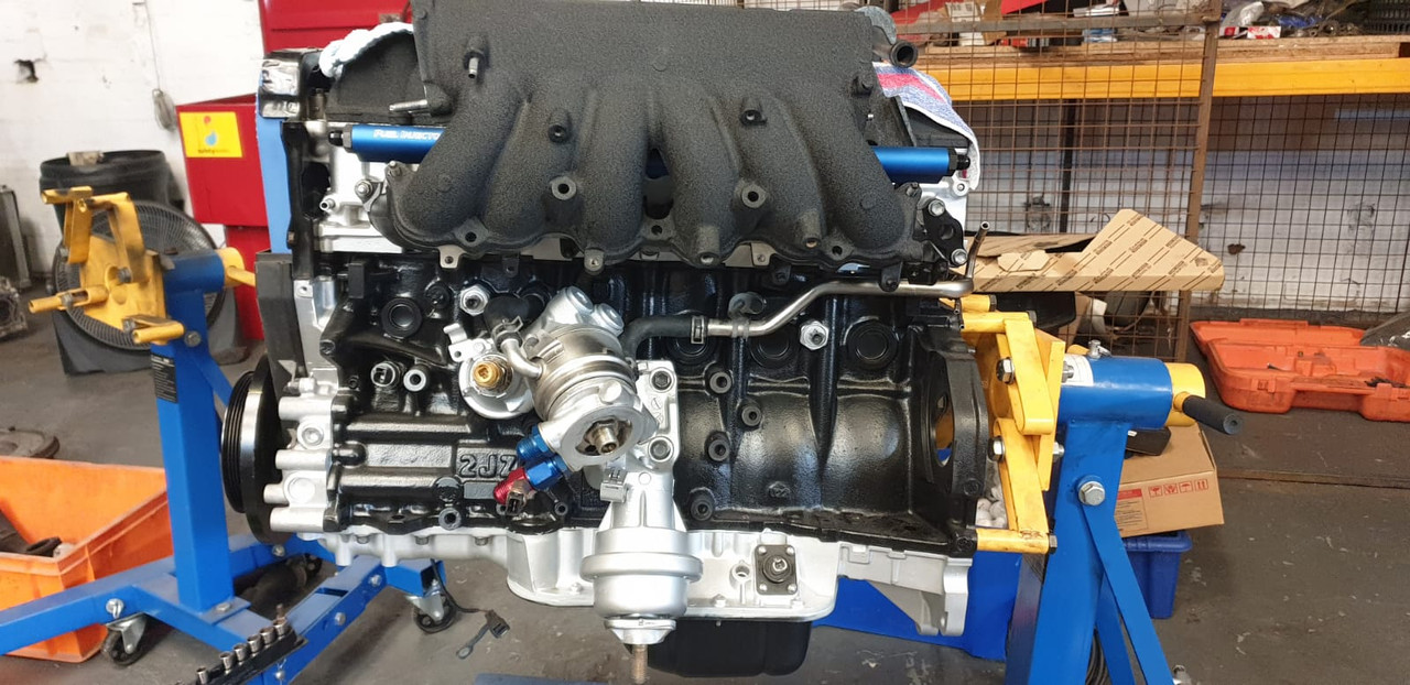

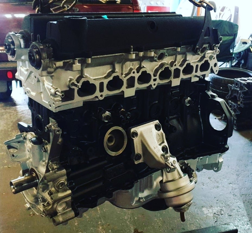

Supra-love Posted August 26, 2020 Author Share Posted August 26, 2020 (edited) Engine built, fitted and awaiting boost! Edited August 26, 2020 by Supra-love (see edit history) Link to comment Share on other sites More sharing options...

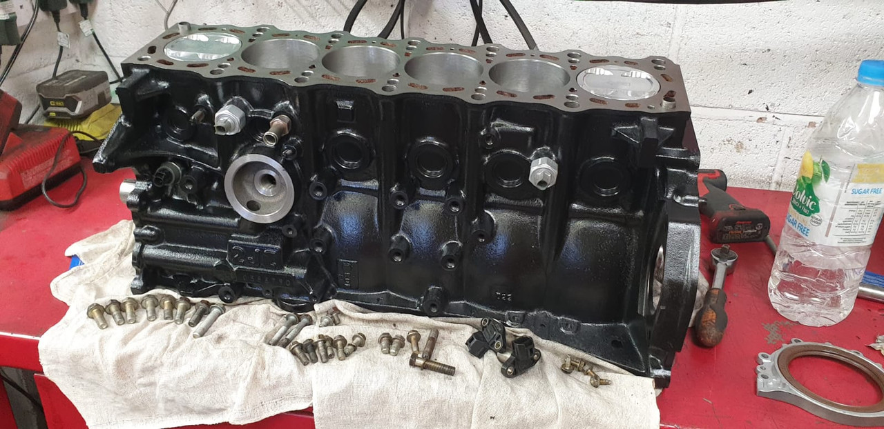

Jellybean Posted August 27, 2020 Share Posted August 27, 2020 Why do you have Pistons and Rods sitting in the block prior to seating your crank and torquing down the main caps? , you want to ensure the crank moves freely before installing piston and Rods You guide the piston and rod onto the connection rod journal from the top of the cylinder via a piston ring compressor tool , stops the rings bending or breaking Why did you not put it on an engine stand when installing everything , make life alot easier measuring clearance and reduce the risk of making a mistake , damaging anything Link to comment Share on other sites More sharing options...
Supra-love Posted August 27, 2020 Author Share Posted August 27, 2020 (edited) Why do you have Pistons and Rods sitting in the block prior to seating your crank and torquing down the main caps? , you want to ensure the crank moves freely before installing piston and Rods You guide the piston and rod onto the connection rod journal from the top of the cylinder via a piston ring compressor tool , stops the rings bending or breaking Why did you not put it on an engine stand when installing everything , make life alot easier measuring clearance and reduce the risk of making a mistake , damaging anything @little num built it, I’m sure he can answer your questions mate Edited August 27, 2020 by Supra-love (see edit history) Link to comment Share on other sites More sharing options...
Jellybean Posted August 27, 2020 Share Posted August 27, 2020 DIY build no ? You spent alot of cash on parts , would not like to see you have any issues Link to comment Share on other sites More sharing options...
Supra-love Posted August 27, 2020 Author Share Posted August 27, 2020 DIY build no ? You spent alot of cash on parts , would not like to see you have any issues No mate James hart built it for me. I would never attempt a DIY Yeah spent mega money on parts and for James to do it all so last thing I want is any issues! I’m sure he will be along soon to explain. Link to comment Share on other sites More sharing options...
