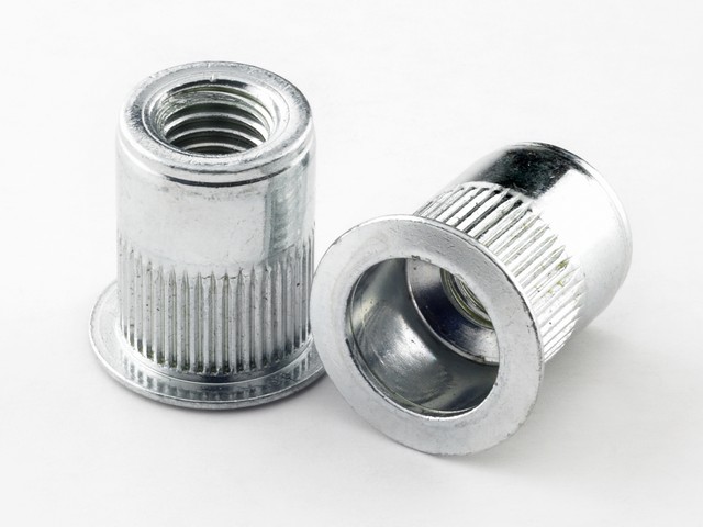

Dim Sum Posted December 8, 2016 Share Posted December 8, 2016 Just wondering if people experience using rivet nut on bodywork. I am planning to to use rivet nut to fit on a lip to the bumper, the reason for this is if the lip gets damaged and etc it could be taken off for repair. How good are they at holding and also would the hole from the rivetnut get bigger over time? These are what I am planning to use. Quote Link to comment Share on other sites More sharing options...
pedrosixfour Posted December 8, 2016 Share Posted December 8, 2016 Ordinary nut and bolt and body washers will save you a lot of grief. Rivets aren't meant for use in much apart from sheet steel. They won't bind in the fibreglass like they're supposed to once compressed meaning, if you do need to remove the lip, the rivnut will just turn along with the bolt. Pure hardship that is easily avoidable. Quote Link to comment Share on other sites More sharing options...

Nic Posted December 8, 2016 Share Posted December 8, 2016 I've used rivnuts but that was into sheet steel to replace captive nuts that needed to be drilled out. They wouldn't work in a bumper, i think they'd pull loose and possibly crack the fibreglass, nuts bolts and penny washers to spread the load would be a better way to secure the lip. Quote Link to comment Share on other sites More sharing options...
