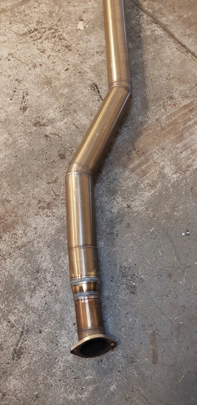

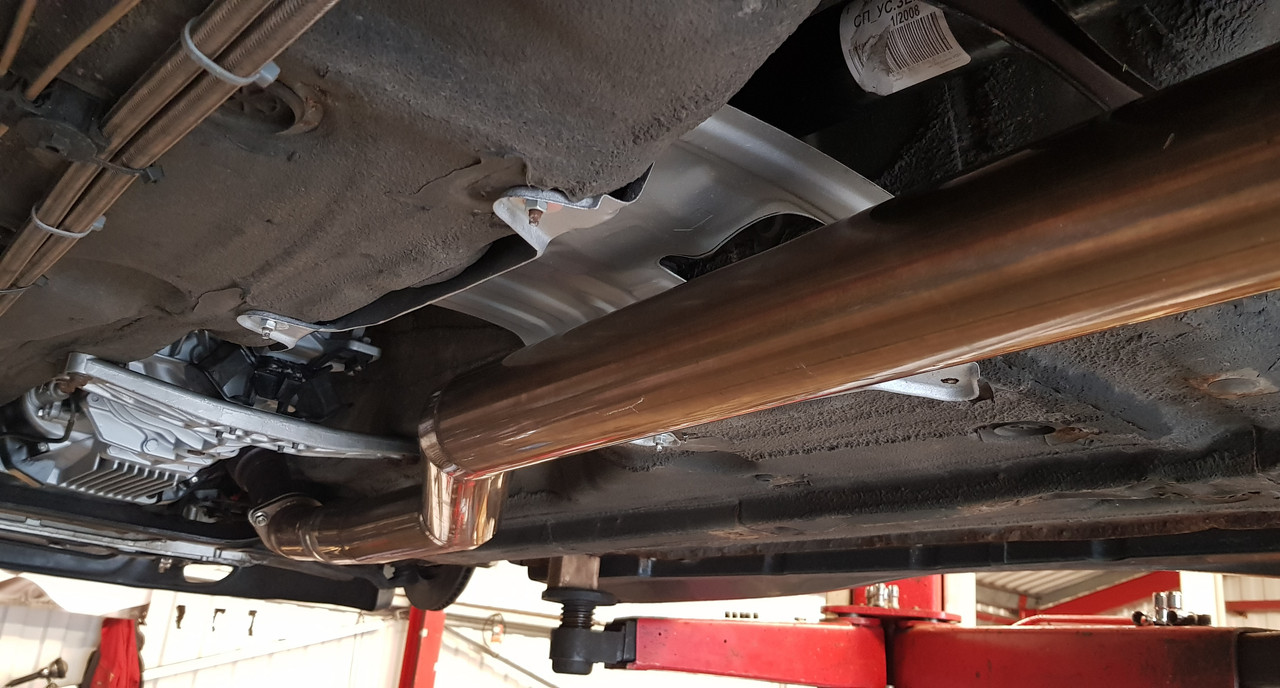

Cam27 Posted October 18, 2018 Author Share Posted October 18, 2018 (edited) Today we set about fabricating the big exhaust i bought last year to fit. The exhaust is 3.5" and my downpipe is 3" so a reducer was required. Started off by chopping the flange off the exhaust and then using the flange off my tb development midpipe before the reducer (much to Tim's disgust haha). Really pleasef with it, can't wait to hear how it sounds! I collected the new flywheel from Toyota this morning but i didn't have the correct bolts so it wasn't possible to fit it. I did manage to change the oil and fit the new diff flange and pas reservoir though Edited October 18, 2018 by Cam27 (see edit history) Link to comment Share on other sites More sharing options...
