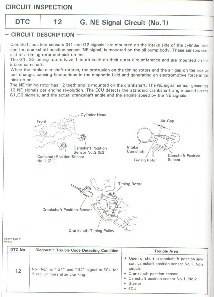

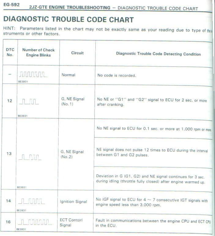

These are what I've found on the ge, but this says there is a crankshaft sensor
Thanks pal, I just went out again to start the car, it's just turning but not starting again now.
I did read there was no crankshaft sensor under the block so that also confused me.
http://i1124.photobucket.com/albums/l570/V6shep/Mobile%20Uploads/DC1_zpssf63vzps.jpg
http://i1124.photobucket.com/albums/l570/V6shep/Mobile%20Uploads/ET1_zpsfgsbn4v5.jpg
Those manuals were written for US spec supra's so it is possible that US na's have a crankposition sensor as illustrated above. but I can say with certainty that the jspec na's do not have one there.
