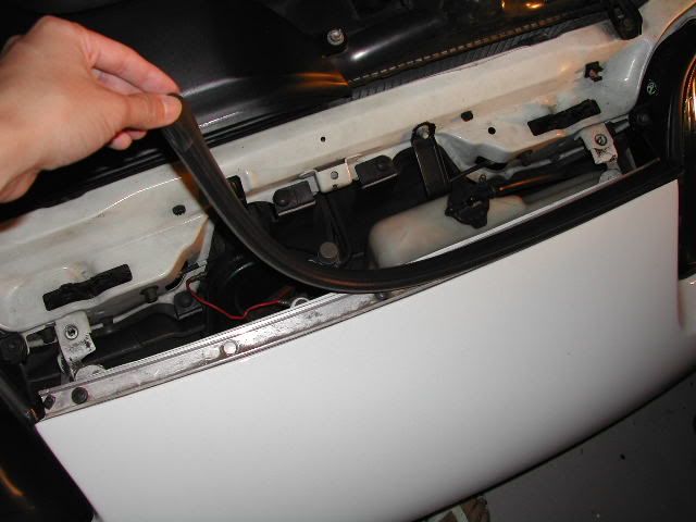

mc92 Posted January 26, 2016 Share Posted January 26, 2016 There are 5 plastic clips under the weatherstrip on top of the bumper between the headlights which allow some adjustment. You can undo the plastic screws from them then gently pull them out and that will let you slide the middle of the bumper around a bit. Not sure how much it'll help. Here's a pic of them: http://img.photobucket.com/albums/v186/SupraBoy/DSCN1102.jpg Quote Link to comment Share on other sites More sharing options...
