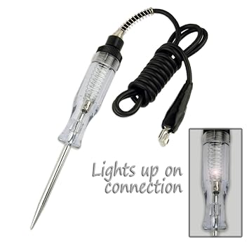

j_jza80 Posted May 4, 2015 Share Posted May 4, 2015 Unplug the loom from the back of the CD player, and use a basic volt tester (something like THIS ) to test whether you're getting power to BOTH the yellow permanent live and the red ignition live wires on the loom. Quote Link to comment Share on other sites More sharing options...
