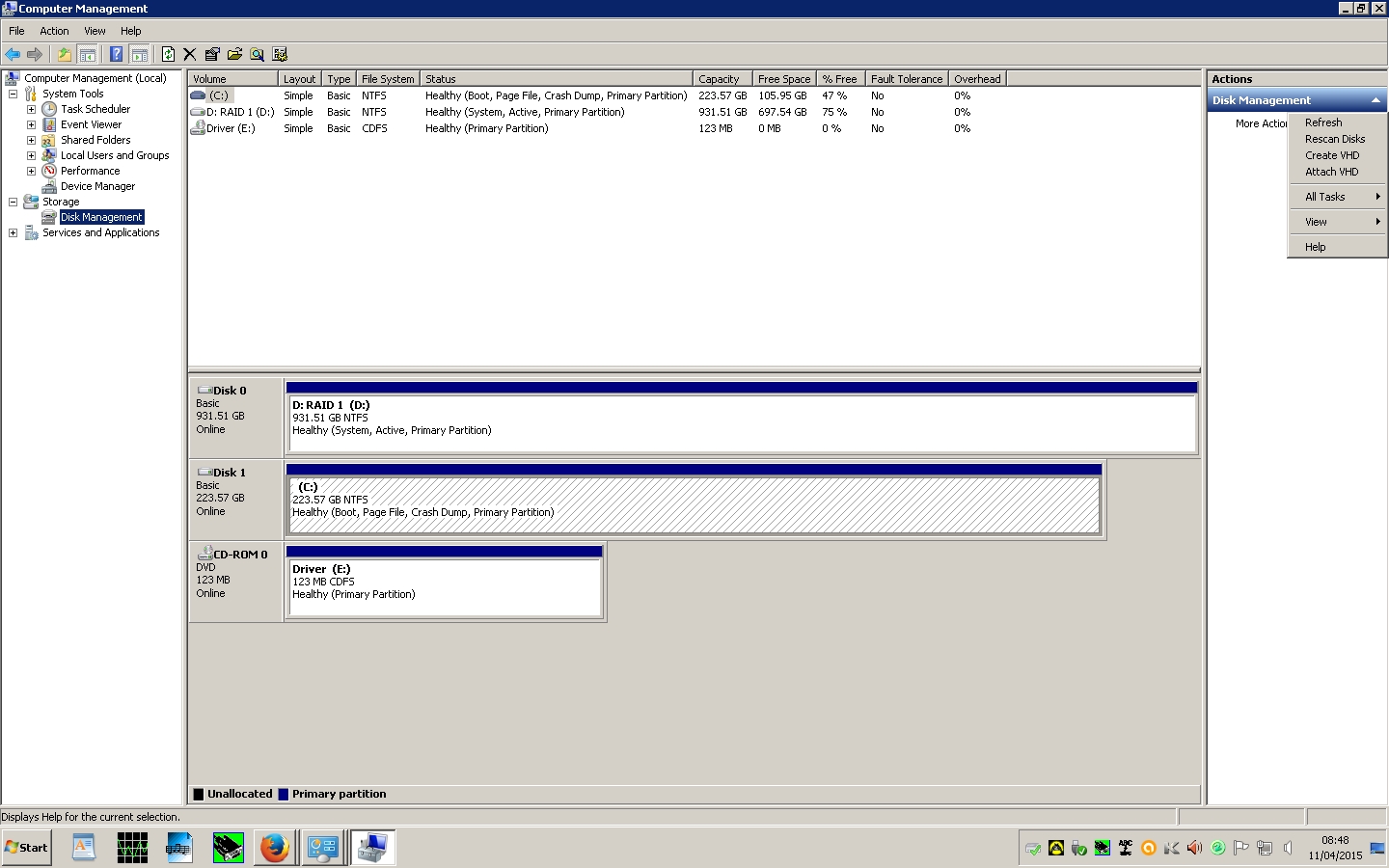

Chris Wilson Posted April 11, 2015 Share Posted April 11, 2015 I have discovered a problem I wasn't even aware I had until trying to do a system image to a tape drive. It seems when I refurbished my PC I have ended up with the the boot files for Windows 7 Pro 64 bit on my SSD C: Drive, and the system files on a RAID 1 SATA array of two 1 Tb drives. I want to move the system files to my C: Drive , which is the SSD one. In the bios I have confirmed disabling the RAID drives causes Windows to fail to boot. The fact the system files are on a different drive is causing issues when doing a system image as the destination drive also contains said files and some software is saying it cannot do this. Plus I think for best reliability the RAID needs to be independent of Windows boot and system files? For clarity I have put a full screen size shot of Windows 7 Disk Management showing how the drives are currently at http://www.chriswilson.tv/partitions.jpg Can anyone tell me how to safely achieve this movement of the system files to my SSD C: Drive please? Thanks. I Googled this a little and it seems this is possible to do by booting into the Win 7 CD and going to the repair utility. But in all the Googled info the system files seem to be in a separate partition, but according to my Disk Manager mine are not. Will this still work? Do I need to unplug the RAID 1 drives first? Do I need to change the boot order in the bios first (first as in before running the repair utility on the Win 7 CD?), and put C: Drive after the CD drive and disable the RAID 1 Drives in the boot menu? Do I need to make the C: Drive partition "Active, and if so, at what stage of the proceedings? Is this all a risky process? Thanks. Quote Link to comment Share on other sites More sharing options...

Chris Wilson Posted April 11, 2015 Author Share Posted April 11, 2015 Well, still here, but despite doing all of the above and making the SSD drive 0, and making that partition active, it still won't boot from C: If I make the RAID 1 disks inactive, but connected still, it won't boot. It seems determined to use the system files (*NOT* Windows System* just the boot stuff) from D: still. Windows Repair is now saying it last booted from the drive OK and basically there's nothing wrong. Damend thing!! Thanks anyway Steve. Is there a way to force writing of the system files to C: ?? Quote Link to comment Share on other sites More sharing options...
Chris Wilson Posted April 11, 2015 Author Share Posted April 11, 2015 Sorted! VisualBCD did the trick in seconds, I was a bit fearful about it, but I am now booting off the C Drive and even if I disconnect the RAID 1 D: Drives it still boots fine The updated Disk Manager screenshot is at: http://www.chriswilson.tv/partitions2.jpg Would you mind looking to see if appears OK please? Cheers! Quote Link to comment Share on other sites More sharing options...
stevie_b Posted April 11, 2015 Share Posted April 11, 2015 Looks like you've sorted it! I've not heard of VisualBCD, but I don't tend to do much power-user stuff with Windows these days. It's not much of a check, but I don't see anything in your new screenshot that looks obviously wrong. Quote Link to comment Share on other sites More sharing options...
