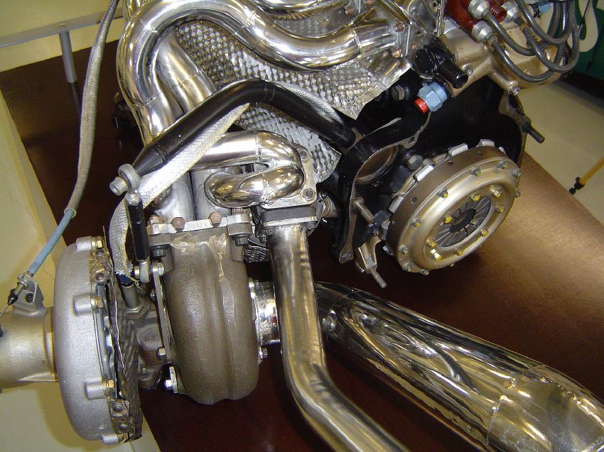

j_jza80 Posted January 24, 2016 Share Posted January 24, 2016 If you are going to use one of those manifolds, make sure you brace the turbo, and get a decent flexi section welded into the exhaust just after the downpipe. That will do more for the manifold than welding it. Quote Link to comment Share on other sites More sharing options...
JackyBoi Posted January 24, 2016 Author Share Posted January 24, 2016 If you are going to use one of those manifolds, make sure you brace the turbo, and get a decent flexi section welded into the exhaust just after the downpipe. That will do more for the manifold than welding it. I did say it would be braced we're gonna brace the absolute **** out of it to try and prevent any cracks. At the end of the day, if it doesn't work, I can chuck it and spend money on a proper manifold! Quote Link to comment Share on other sites More sharing options...
j_jza80 Posted January 24, 2016 Share Posted January 24, 2016 Im looking into this myself, as even with a hks manifold i think leaving the turbo unsupported will cause issues. Im thinking of making a bracket that attaches to the 2 rearmost but 1 sparkplug cover threads on both cam covers, and using an arm to attach it to the turbo. Quote Link to comment Share on other sites More sharing options...
JackyBoi Posted January 24, 2016 Author Share Posted January 24, 2016 Im looking into this myself, as even with a hks manifold i think leaving the turbo unsupported will cause issues. Im thinking of making a bracket that attaches to the 2 rearmost but 1 sparkplug cover threads on both cam covers, and using an arm to attach it to the turbo. It's worth it mate. I didn't bother bracing these twins but I should have - any kit I put on in the future will definitely be braced! Quote Link to comment Share on other sites More sharing options...

Nic Posted January 24, 2016 Share Posted January 24, 2016 Im looking into this myself, as even with a hks manifold i think leaving the turbo unsupported will cause issues. Im thinking of making a bracket that attaches to the 2 rearmost but 1 sparkplug cover threads on both cam covers, and using an arm to attach it to the turbo. Might be worth talking to CW, see this post http://www.mkivsupra.net/vbb/showthread.php?90717-My-Single-Kit&p=1150855&viewfull=1#post1150855 Quote Link to comment Share on other sites More sharing options...
j_jza80 Posted January 24, 2016 Share Posted January 24, 2016 Looks pretty good. Quote Link to comment Share on other sites More sharing options...
JackyBoi Posted January 24, 2016 Author Share Posted January 24, 2016 http://www.gurneyflap.com/Resources/DSC06001.jpg Looks pretty good. Is it the bracing you're looking at? I'm thinking about polished rods that connect the header flange to the turbo flange, and something else to brace the actual turbo to the engine bay, with some measures to allow expansion Quote Link to comment Share on other sites More sharing options...
j_jza80 Posted January 24, 2016 Share Posted January 24, 2016 As Nick said, when you look at motosport type braces, they seem to be rose jointed. Rose joints aren't expensive either. Welding rods between the flanges *may* actually cause cracking. Quote Link to comment Share on other sites More sharing options...
JackyBoi Posted January 25, 2016 Author Share Posted January 25, 2016 As Nick said, when you look at motosport type braces, they seem to be rose jointed. Rose joints aren't expensive either. Welding rods between the flanges *may* actually cause cracking. I see, one of these? Quote Link to comment Share on other sites More sharing options...
j_jza80 Posted January 25, 2016 Share Posted January 25, 2016 Yeah i think ideally youd need a couple. Im going to be doing this as soon as i get my supra back. Quote Link to comment Share on other sites More sharing options...
