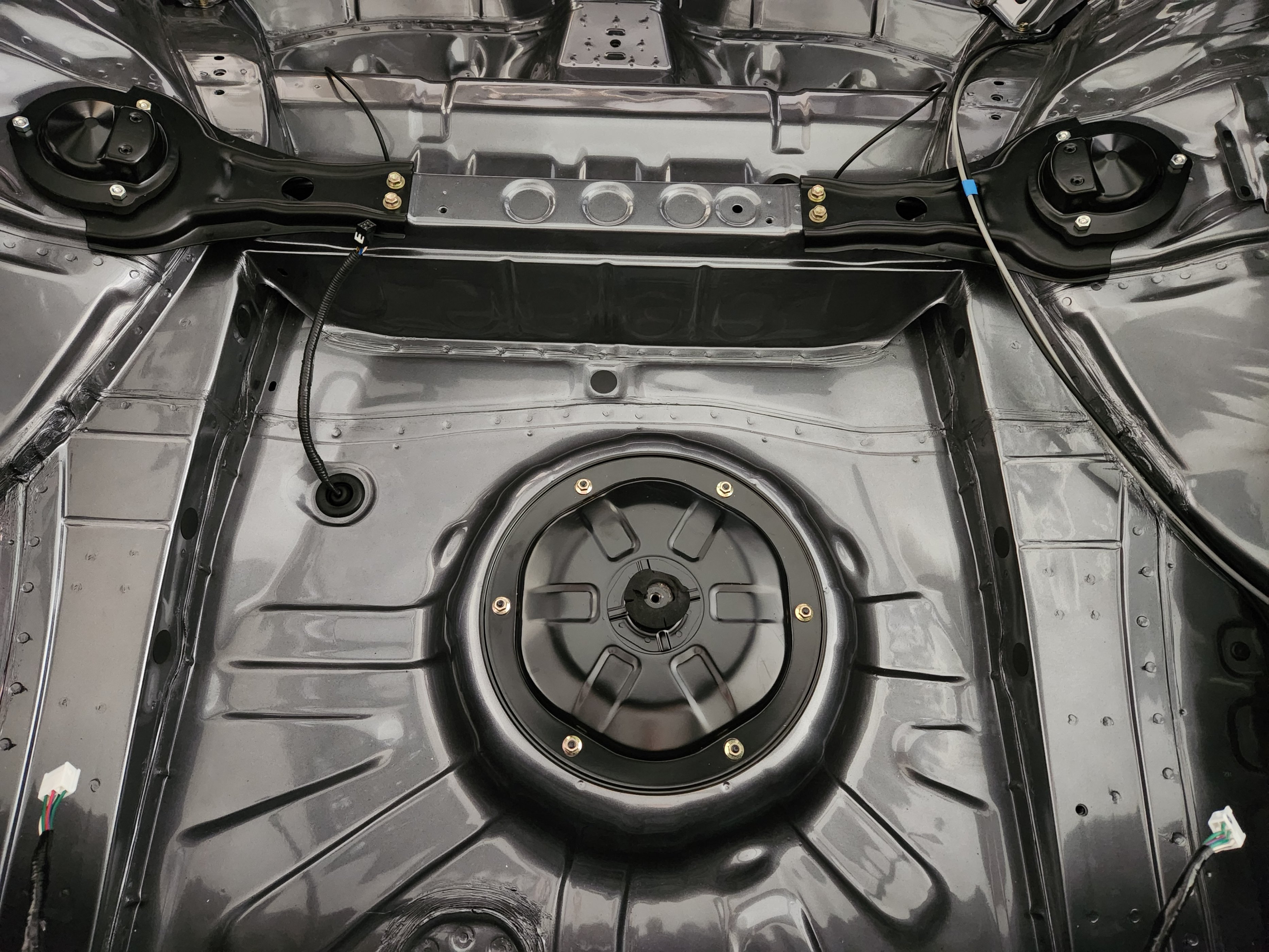

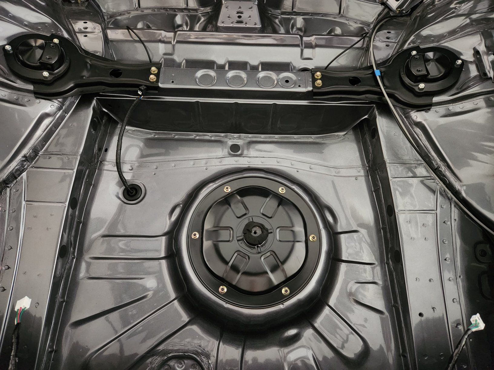

mwilkinson Posted March 2 Author Share Posted March 2 (edited) Thanks for the tip I had to drop the whole fuel tank and start again as I forgot to install the fuel pump loom - doh! I can't believe I didn't do it on first install, but there we go. For anyone else's reference this is how the pipes and loom go. Edited March 2 by mwilkinson (see edit history) Link to comment Share on other sites More sharing options...

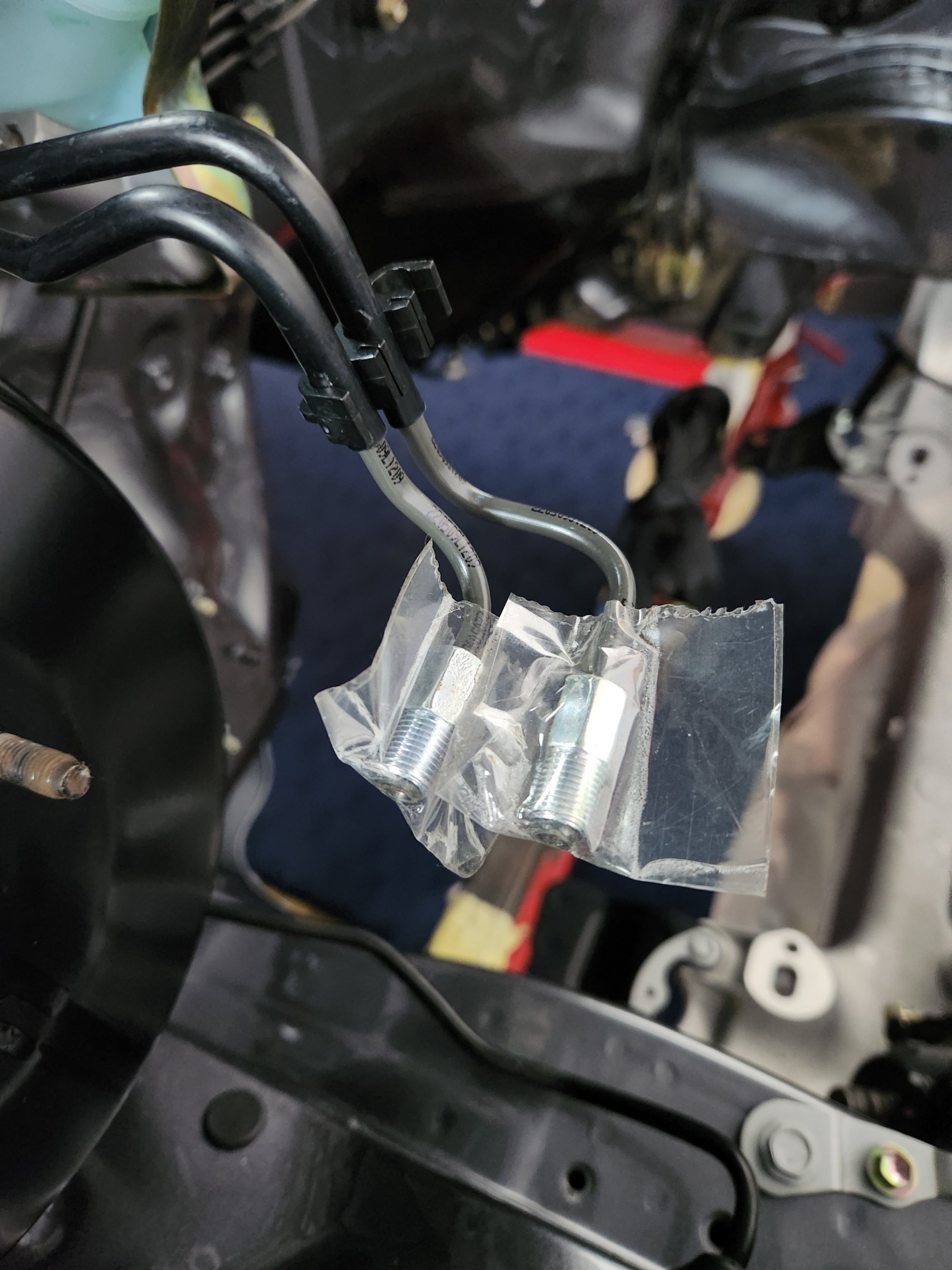

mwilkinson Posted March 3 Author Share Posted March 3 (edited) I've now finished running the fuel and brake lines under the car. I have a twin brake line setup as although the car is a facelift body, it has the non-VVTi engine, so still retains the earlier brake setup. At the front of the car there is a connector block for the brake lines to connect to and a bracket that holds the fuel lines. I do have a new brake pipe connector, but I chose to reuse my old zinc plated one. Once the pipes and brackets were all secure I refitted the pipe covers. I found out that my front one is broken at the tip, so I will need to replace this. I then installed the new bulkhead brackets so that I can start reinstalling the pipework along the bulkhead. This also allowed me to secure the fuel tank breather hose that was still flapping around in the engine bay. I reused the original zinc plated bolts here instead of the new ones I bought. I then decided to install the anti-roll brackets. These were torqued to 18Nm as per the manual. The brackets are original and have been powdercoated. Bolts are new. I have Titan anti-roll bars, so that is why the lower brackets look different. These are new lower brackets and bushings from Titan. I then installed the front heat shield. This is original and powdercoated and the bolts and nuts are all original and zinc plated. Edited March 16 by mwilkinson (see edit history) 3 Link to comment Share on other sites More sharing options...

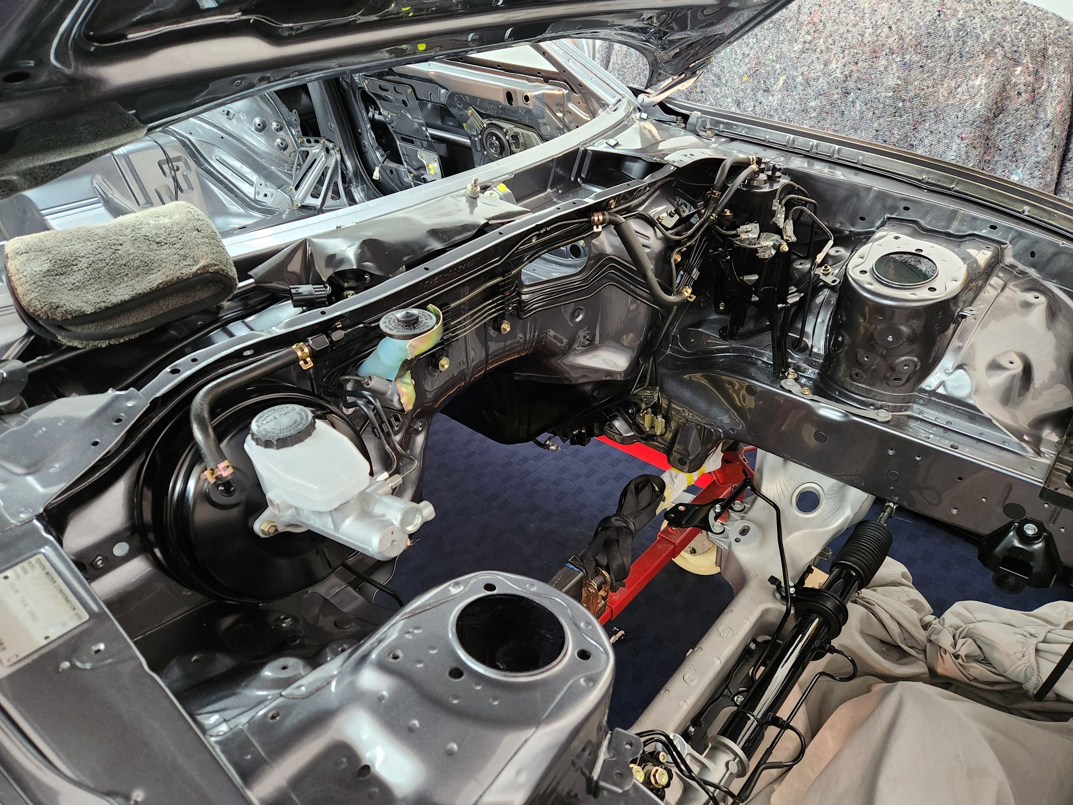

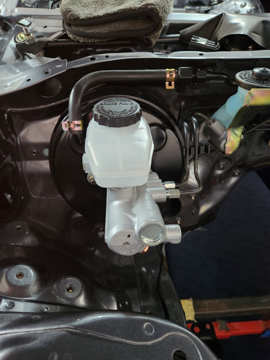

mwilkinson Posted March 27 Author Share Posted March 27 (edited) I've now installed the engine bay bulkhead pipe work. First were the two rear brake pipes that rund from the ABS actuator to the union pipe at the base of the nearside of the engine bay. I managed to get pne new a the other I had to reuse as it is now discontinued. I was also able to still get a replacement near side front brake pipe and losely install it. I then installed the two pipes that run from the brake reservoir. These were both new replacements. I then installed the pipe from the clutch reservoir to the gearbox. I reused my original pipe. Finally I installed the offside front brake pipe. This is annoyingly discontinued, so i had to reuse my original pipe. I then installed the two pipe spacers. The larger one goes on the back of thevpipes whwre the HVAC drain pipe comes through the bulkhead. The other spacer separates the two pipes going into the brake reservoir. I then installed the new clutch master cylinder. Although I bought a new guard and bolts I decided to reuse my zinc plated old ones instead. Next was the repainted brake booster. Edited March 27 by mwilkinson (see edit history) 1 Link to comment Share on other sites More sharing options...
mwilkinson Posted March 27 Author Share Posted March 27 (edited) I've now installed the bulkhead pipe work. I've also installed the aluminium part of the front subframe. More details about the work and parts for the subframe can be found earlier in the thread. Main subframe bolts torqued to 125 Nm. Steering rack bolts x 4 torqued to 75Nm. Edited March 27 by mwilkinson (see edit history) 1 Link to comment Share on other sites More sharing options...

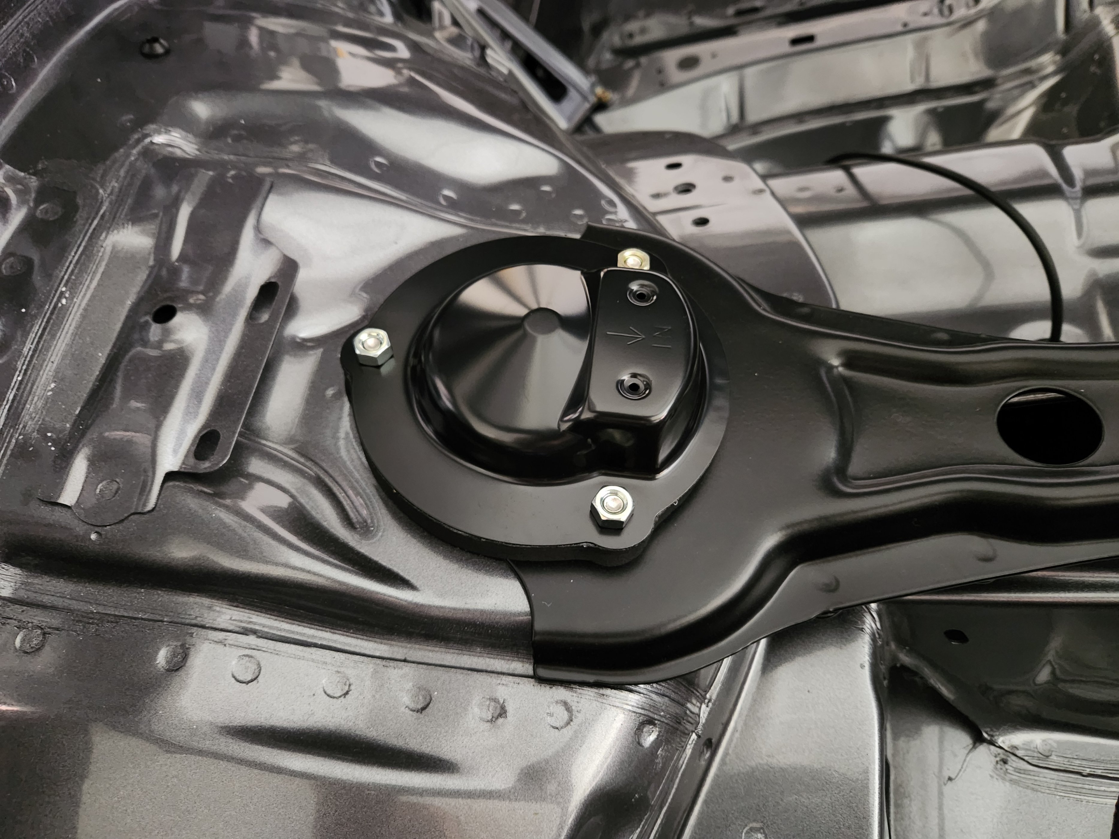

mwilkinson Posted March 27 Author Share Posted March 27 (edited) I've also now installed the assembled rear subframe. Info about the subframe rebuild can be found earlier in my build thread. I used new bolts to secure the subframe. The rear 8 x bolts were torqued to 58 Nm. The same torque is applied to the 2 x nuts that secure the rear bushes the the actual subframe. The 2 x front bolts were torqued to 175 Nm. Remeber to install the two lower cups too (easily forgotten). I then installed my new HKS Hipermax S rear struts. I used new bolts, nuts and washers to secure the suspension. There were also a set of spacers that came with the HKS kit to ensure the correct fitment of the rear stud to the lower suspension arm and associated bolt. None of the other suspension bolts have been tightened. I'll do that later when the car is ready to be taken off the body dolly and the wheels installed. I'll jack the hub /knuckle to the correct ride position and then tightened everything up. Final thing was to ensure the ABS sensor leads were pushed up into the cabin from underneath. Edited March 27 by mwilkinson (see edit history) 2 Link to comment Share on other sites More sharing options...
