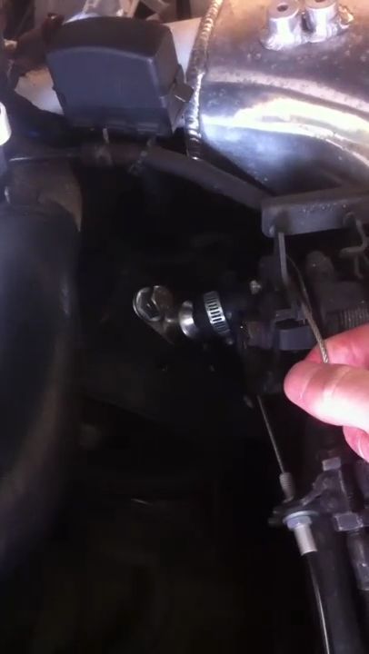

FOSTA Posted October 26, 2013 Share Posted October 26, 2013 (edited) Hi guys, My supra has developed a nice high pitched whistling noise, I've located it to the throttle body on the cable mechanism side. Its coming from where the shaft goes into the throttle body for the butterfly. Is there like a rebuild kit or maby like a rubber doughnut seal in there that I need to replace or something. My A/F gauge is showing up fine with this noise like but it needs sorting as its so annoying! Lol Here is a video so you get an idea http://i206.photobucket.com/albums/bb161/jamielfoster86/21F5EC65-5424-4850-B3CA-40F9181311D1-461-0000011BE8F355BB_zpscfb83294.mp4 Cheers guys Edited October 29, 2013 by FOSTA (see edit history) Quote Link to comment Share on other sites More sharing options...

FOSTA Posted October 26, 2013 Author Share Posted October 26, 2013 Does it stop if you take the auxiliary belt off? Nope, it's from the throttle body dude for sure ive checked everything else and 100% sure its throttle body. The noise even changed slightly when I try and wobble the shaft into the throttle body for the butterfly. Quote Link to comment Share on other sites More sharing options...

FOSTA Posted October 26, 2013 Author Share Posted October 26, 2013 It's where the butterfly valve isn't fully closing You sure dude, The revs seem to be perfect. I can't remember off the too of my head but I should beable to to fully close it from the mechanism. I could swear its comming from where the shaft comes out as if I put my ear on the over side I cans hear it as much but if I put my ear next to the shaft Its really loud! Now I think of it I'm dam sure it's coming from the shaft. - - - Updated - - - Source a new throttle body then? Keron...when he returns. Can you not just replace a seal? Quote Link to comment Share on other sites More sharing options...

Josh42 Posted October 27, 2013 Share Posted October 27, 2013 I had this. Try reseating the gasket that sits between the throttle body and the 'Y' pipe mate Quote Link to comment Share on other sites More sharing options...

FOSTA Posted October 29, 2013 Author Share Posted October 29, 2013 Cheers for all your input and help guys! It was the throttle body gasket, all sorted now and nice and quiet Big thanks Fosta Quote Link to comment Share on other sites More sharing options...
