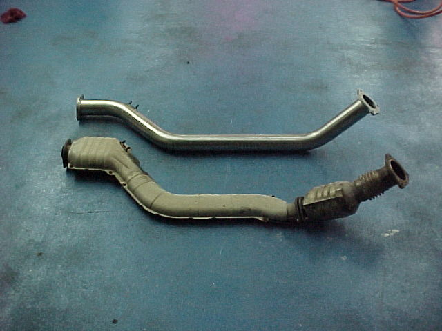

Nic Posted August 30, 2013 Share Posted August 30, 2013 (edited) Exhaust is restrictive (not sure if I have the Cats in or not) The first thing you need to do is check if the car has the cats fitted. The cats are very restrictive and limit the boost level, trying to raise the boost with the cats in place will generate dangerously high exhaust gas temps. Pic of the stock cats in the foreground, the smaller 1st cat (right) nearest the engine, the 2nd longer cat (left) runs underneath the front of the car. Edited August 30, 2013 by Nic (see edit history) Quote Link to comment Share on other sites More sharing options...
Guest mwohaaahaahaa Posted August 30, 2013 Share Posted August 30, 2013 The first thing you need to do is check if the car has the cats fitted. The cats are very restrictive and limit the boost level, trying to raise the boost with the cats in place will generate dangerously high exhaust gas temps. Pic of the stock cats in the foreground, the smaller 1st cat (right) nearest the engine, the 2nd longer cat (left) runs underneath the front of the car. http://up.autotitre.com/0401f80304.jpg Thank you for that. I'll have to check when I can get under the car. I have been reading some other threads like the one below http://www.mkiv.co.uk/vbb/showthread.php?35926-The-sequential-system Could Problem 4 that Ian is talking about be part of the problem as to why I'm not seeing boost at all at low revs, also if this is the problem could a leak here also be causing me to not be able to get greater than .7 boost? Thank you all for your help so far. Quote Link to comment Share on other sites More sharing options...
