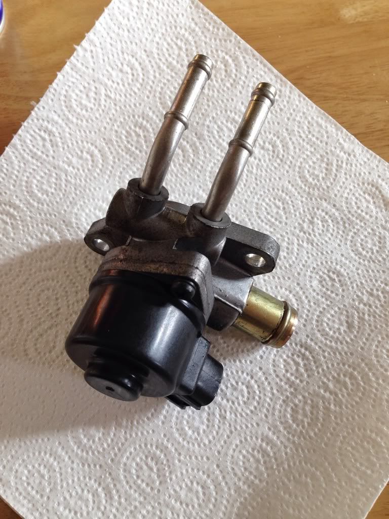

Westy Posted October 23, 2013 Author Share Posted October 23, 2013 Whipped off my idle control valve this morning to try and give it a clean...did all the hard parts and then the little Phillips screws wouldn't play ball! One eventually came out but the other one thinks he is in there for a life sentence! Head started to chew so decided to fill the ICV with carb cleaner and let it do it's stuff. Loads of crap ran out but obviously it's not anywhere near as good as separating it! Quote Link to comment Share on other sites More sharing options...
Iky Posted October 23, 2013 Share Posted October 23, 2013 Whipped off my idle control valve this morning to try and give it a clean...did all the hard parts and then the little Phillips screws wouldn't play ball! One eventually came out but the other one thinks he is in there for a life sentence! Head started to chew so decided to fill the ICV with carb cleaner and let it do it's stuff. http://i1212.photobucket.com/albums/cc445/westy882/A1381EDC-9E55-43E2-966A-A6E9D0A849F4-372-00000065B1CED30B_zpsa6db1be7.jpg Loads of crap ran out but obviously it's not anywhere near as good as separating it! You could try a small chefs blowtorch on it or one of those jet flame cigarette lighters. Similar principle for removing the boot rubbers. Quote Link to comment Share on other sites More sharing options...
Westy Posted October 23, 2013 Author Share Posted October 23, 2013 I did do that mate! That screw isn't playing ball at all! Quote Link to comment Share on other sites More sharing options...
hodge Posted October 23, 2013 Share Posted October 23, 2013 Westy you need to use some small long nose mole grips on the screw. It will crack off pretty easily with those big man. Quote Link to comment Share on other sites More sharing options...
Westy Posted October 23, 2013 Author Share Posted October 23, 2013 Thanks John...I'll give it another crack another day. PITA needing the car on a daily a need to put everything back on immediately!lol! Quote Link to comment Share on other sites More sharing options...
