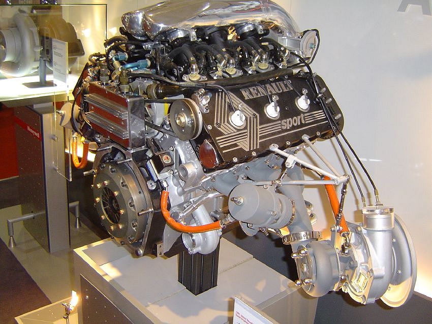

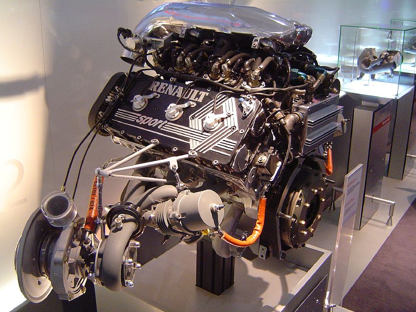

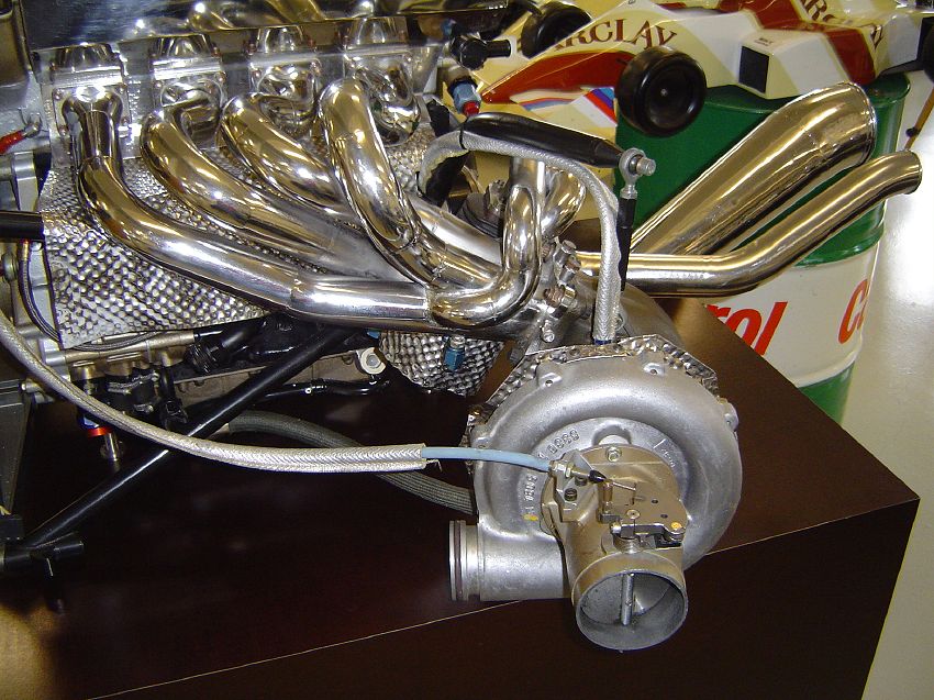

http://www.chriswilson.tv/4AGEbuild/build.html shows my Toyota 4A-GE engine in build, and just one idea for a support bracket. Inconel manifold, turbo has integral wastegate, the turbo is supported from a chrome moly bracket.
http://www.newbury-house.com/F1_turbo/1.jpg
http://www.newbury-house.com/F1_turbo/2.jpg
http://www.newbury-house.com/F1_turbo/3.jpg
http://www.newbury-house.com/F1_turbo/4.jpg
Show some more ideas.
