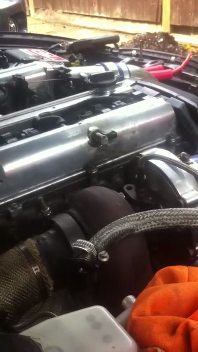

ALG JOT Posted October 7, 2012 Share Posted October 7, 2012 I was just after changing out my shortblock andcar will not start so doing the basic checks and found only one plug is firing. Whether i switch the coilpacks round or sparkplugs its only the same one that fires(#3). Anyone know what i should look for next to solve this? Quote Link to comment Share on other sites More sharing options...

ALG JOT Posted October 7, 2012 Author Share Posted October 7, 2012 all sorted 2 packs weren't getting a decent ground and one pig tail connector was faulty now that that is sorted when i go to start im getting a pop now and again but a slow crank leading up to it. That is with a fresh battery and jump leads from another car. Is it possible to have the cams on a non vvti 2jzgte engine the wrong way round? I.e inlet cam on exhaust side and exhaust cam on inlet side? I have... *Fuel *Spark *Timing is spot on So thats the only other thing i can think of :/ - - - Updated - - - all sorted 2 packs weren't getting a decent ground and one pig tail connector was faulty now that that is sorted when i go to start im getting a pop now and again but a slow crank leading up to it. That is with a fresh battery and jump leads from another car. Is it possible to have the cams on a non vvti 2jzgte engine the wrong way round? I.e inlet cam on exhaust side and exhaust cam on inlet side? I have... *Fuel *Spark *Timing is spot on So thats the only other thing i can think of :/ Quote Link to comment Share on other sites More sharing options...

ALG JOT Posted October 7, 2012 Author Share Posted October 7, 2012 yeah compression is all good i know its a cold engine and i didn't spray any oil but they all averaged 150ish. I am about to upload a video of what it sounds like when i try start... Quote Link to comment Share on other sites More sharing options...
ALG JOT Posted October 7, 2012 Author Share Posted October 7, 2012 http://i299.photobucket.com/albums/mm287/akcustomz89/595C060A-680B-415A-A42C-E953F3DD588F-558-000000CC4A64A2FB.mp4 Quote Link to comment Share on other sites More sharing options...
