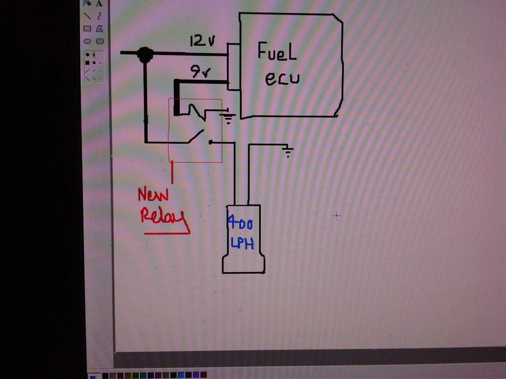

mellonman Posted July 4, 2012 Author Share Posted July 4, 2012 it is the fuel pump ecu as when i but the short in b+ ,fp the pump starts working. i tested it again and i got a 12v prim voltage but as soon as i conect it to the fuel pump volts just go completely, so im forced to bypass the ecu i have just brought a relay to do it but not 100% on how its wired is my drawing any good? or anyone know where to find a drawing for the relay mod Link to comment Share on other sites More sharing options...

mellonman Posted July 4, 2012 Author Share Posted July 4, 2012 mellonman said: just checked i think its B+ and FP i will test this latter when you say fit a relay would it be something like this [ATTACH=CONFIG]154223[/ATTACH] well my diagram worked a treat happy days boosting to 1.3 at a lovely safe 11.2 Link to comment Share on other sites More sharing options...
Nodalmighty Posted July 5, 2012 Share Posted July 5, 2012 mellonman said: well my diagram worked a treat happy days boosting to 1.3 at a lovely safe 11.2 This suggests to me it was your fuel pump ECU that was gradually failing and the current demand of the GST400 was the last straw. Your fuel pump could well have been fine all along, not that any of this really matters now Lyndon. Link to comment Share on other sites More sharing options...
