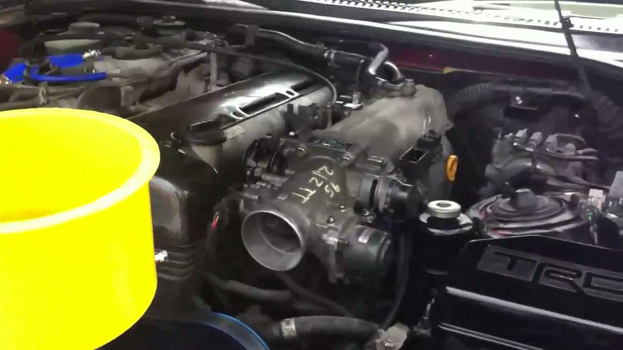

hodge Posted May 11, 2012 Author Share Posted May 11, 2012 Here's a quick video I took a few days ago. http://i1103.photobucket.com/albums/g470/Shineypics/3bec1a4b.mp4 Quote Link to comment Share on other sites More sharing options...

hodge Posted May 14, 2012 Author Share Posted May 14, 2012 Ok, so, here's the issue. The car doesn't have a throttle control ECU, nor a connector for it. How I've overlooked this is beyond me. This engine WAS NOT removed from an auto supra as I was previously told. And this is how. This is a pic of my spare TT auto loom I use for spares. Notice the large ECU plug and the 2 smaller ECU plugs. The and 1 small one goes into the main engine ECU and the other smaller grey plug goes into the throttle control ECU. Now this is a pic of the ECU plugs for Simons car. There is 1 large grey plug and 1 smaller one which go into the main ECU and instead of having another grey plug it has this small white one instead, which odviously is the throttle ECU for whatever the hell it's came out of. My guess is that it's from a GS300 twin turbo. Here's a couple more pics of the plug. The way I see it, is there's 3 ways of doing this. 1) replace the loom for a Supra specific loom which I would preferr to do as this 1 is totally butchered. 2) try and find a throttle control ECU for the GS300 or whatever car it was removed from and give that a punt. 3) find the pin out's for both the supra and this other plug and hardwire a supra specific plug to it as I already have a supra throttle control ECU. This is proving to be a very, very interesting job for sure. Quote Link to comment Share on other sites More sharing options...
