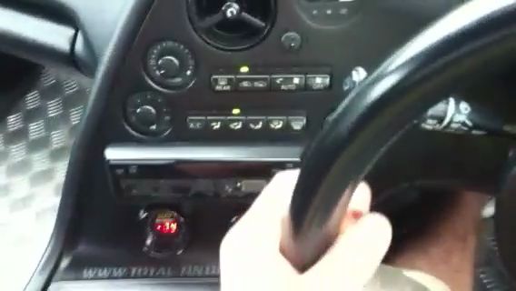

FOSTA Posted September 7, 2011 Author Share Posted September 7, 2011 Ok I'm just going to buy a new wastegate but a hks or A tial. But just before I do is there anything else I can check before I dismantle the kit? Here is a video of the erratic boost. Sorry for the bad quality. http://i206.photobucket.com/albums/bb161/jamielfoster86/c79e3c52.mp4 And here is some pics. The boost gauge is on the left Wastegate opened at 8.82psi Wastegate opened at 4.08psi Wastegate opened at 7.35psi And here at 6.21psi Quote Link to comment Share on other sites More sharing options...

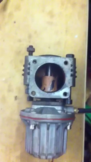

FOSTA Posted September 11, 2011 Author Share Posted September 11, 2011 Ok I took off the wategate today and checked it over and everything seemed to be looking ok and the piston was moving freely. I cleaned it up and regressed and it's still the same? Boost is all over the place? :-( All looks new! And a video link of it working! http://i206.photobucket.com/albums/bb161/jamielfoster86/08a0b35f.mp4 Now I'm really confused! It all seems to be brand new inside and working freely! Could it be something else? I've also replaced the vacuum hoses for the third time now! Please help guys! :-) Quote Link to comment Share on other sites More sharing options...
Scott Posted September 11, 2011 Share Posted September 11, 2011 Looks to be opening about 10lbs according to that gauge. They are notoriously inaccurate though. I would possibly suspect the spring if everything else is ok. The fact that you were getting intermittent results would say it's something else though. Quote Link to comment Share on other sites More sharing options...
FOSTA Posted September 11, 2011 Author Share Posted September 11, 2011 Yeah well the spring was opening fine at a steady 5psi when first installed. But the wastegate did stick open after a few months of use and after taking the kit off and giving the wategate a clean it was closing ok. But I never tried to open it after that as I was waiting to get it mapped! But as the car was due to go down for mapping on Friday gone there. I thought I would make sure everything was working and this is what I came across! Boost all over the place. What else can cause this to happen? Cheers Quote Link to comment Share on other sites More sharing options...
Scott Posted September 11, 2011 Share Posted September 11, 2011 The wastegate is sticking bud, it's the only explanation really. Either that or the boost gauge is playing up. Quote Link to comment Share on other sites More sharing options...
