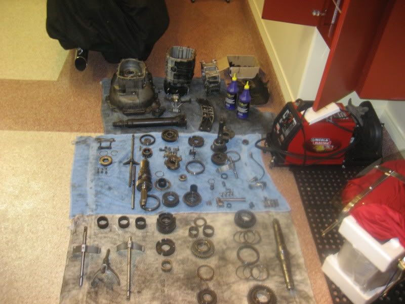

Kirk Posted August 24, 2011 Share Posted August 24, 2011 (edited) You would have to completely dismantle the transmission to this point before you could treat it so unless your a handy engineer with the Red Toyota manual or know a really good friend I cant see the process being free The Achilles heal is the gears themselves. There just not beefy enough to handle huge torque so treating the gears is only putting off the inevitable for a little longer IMO. Edited August 24, 2011 by Kirk (see edit history) Quote Link to comment Share on other sites More sharing options...

pedrosixfour Posted August 24, 2011 Share Posted August 24, 2011 You would have to completely dismantle the transmission to this point before you could treat it so unless your a handy engineer with the Red Toyota manual or know a really good friend I cant see the process being free http://i26.photobucket.com/albums/c123/cul8r2fast4u/IMG_0701.jpg The Achilles heal is the gears themselves. There just not beefy enough to handle huge torque so treating the gears is only putting off the inevitable for a little longer IMO. That picture just made me heave a little! @ Noz Sorry I never replied to your PM buddy, I completely forgot to do so after I did a bit of looking into your process and then got side tracked! I really don't think there is one particular thing you can do to the W58 that is going to cure its weaknesses because they can fail in several different areas. The old reliables of synchros, bearings and seals are all replaceable and there is nothing you can do to improve on the original design as far as I can tell so just buy the best. The geared components themselves, the gears and the shafts, are the main concern. But from looking at my own I'd say that they are just inadequately sized to handle alot of torque and, in some areas, thrust. I doubt a case hardening process will make up for a lack of material in the long run as it's not usually as a result of gradual wear that the boxes fail IMO. Quote Link to comment Share on other sites More sharing options...
Kirk Posted August 24, 2011 Share Posted August 24, 2011 (edited) Martin, the process will be free i understand replacing parts may not be. i think it would be a SERIOUS pain in the donkey to try and get it apart. most people on here haven't claimed to have gear problems, mainly bearing issues? It is a serious pain in the arse to do trust me . Bearing issues are more a wear and tear thing IMO although i wont rule out some failures were down to accelerated wear from stress on the original bearings. When paired with a TT engine that produces twice the torque the box is rated to then your asking for trouble as I and Damien said the gears are not substantial enough to take the torque they will be subjected to. Dr Doom found that out the hard way. He's gone through more W58's than anyone else and I dread to think what the insides looked like. Point being subjected to abuse after a short while they will grenade themselves. Edited August 24, 2011 by Kirk (see edit history) Quote Link to comment Share on other sites More sharing options...
