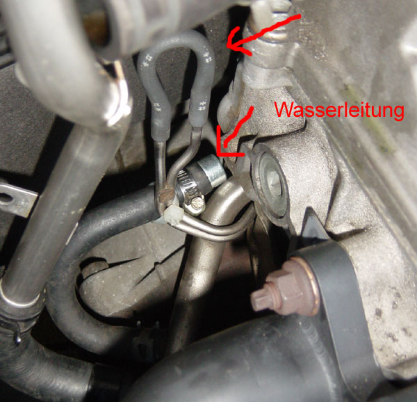

Hi I was cleaning my engine bay today and I noticed that I have a hose that is connected at one end but it is not connected at the other. There is a pipe that it can connect ot but I dont want to do this until I am sure it should be on there.
Unfortunately I did not carryout the install so I am not sure if this should be connected on a single install. I have attached some ppitctures, you will see the one end of the hose connected, and you will see a pipe next to this where the the other end of the hose could connect.
Can someone please tell me what this is and should I connect the pipe. I am not sure if this is just a part of the old sequential system and is now redudant. The area is at the back of the engine bay down the left hand side as you look at it. Someone please help, pictures below

The silicone pipe is coming off one of the small metal pipes (see pictures above) looking at your explanation, this would then lead to the sequential turbos. I didnt know if the loose end had to be connected to the other small metal pipe to act as a return.
hope this makes sense, hopefully someone with a single install will be able to check on there install and confirm
It won't matter if it's not connected or capped off because the pressure tank isn't used anymore, it's just tidier and looks more professional.
