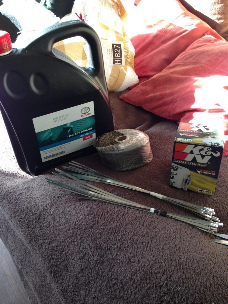

Its taken a little time as I've been busy with work, but got all the parts ordered and in that time decided that I'd prefer a SAFC2 over the v1 that I already have and so I bought one.... just waiting for it to arrive.
So jobs I did:
I drained the oil and coolant from the engine and pulled the turbo and manifold off the block (again), stripped down the turbo so I could get at the bolts on the manifold and managed to get them apart, there was a couple of gaskets between the turbo/ manifold and one side had blown out completely, so this is where my leak (black smoke) was coming from.
I took the manifold into the house (amazingly my wife let me) and started wrapping it in Titanium wrap, I'm pretty happy with the result and should keep the temperatures around the brake cylinder area cooler than before. Since I was replacing the oil (again), I purchased a nice K&N oil filer and also got some NGK copper spark plugs as the platinum one I had were fouled.
So with a new gasket fitted to the turbo (and OEM ones against the block) and Toyota red coolant now sitting in the radiator, I replaced the cheap Lambda sensor I had in the downpipe for a OEM Denso one - so now...I think I'm nearly ready to fire her up again. But I'm away for 5-6 days so probably won't be until next Thursday/Friday.
I'm hoping the SAFC2 will turn up in that time as I'd like to get that wired in straight away as I know I'm going to be running rich again. and once shes up and running I'm going to need to take it for a map on a dyno, anyone know the best one to go to in the NE?
