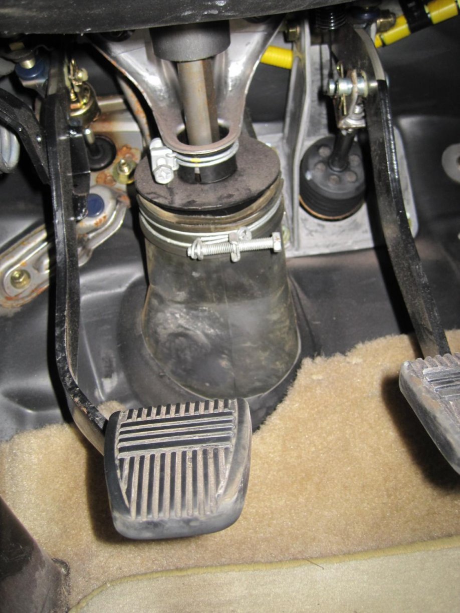

pistol pete Posted February 25, 2011 Share Posted February 25, 2011 Hi ya peoples.. still got a problem with my clutch pedal and it seems to be with the spring on the pedal it self... now the big spring seems fine and is onthe pedal fine.. it then i think attatches to a smaller spring.. can some of you manual boys just take a quick pics for me so i can compare.. many thanks sorry should have been your.. can someone edit the title please Quote Link to comment Share on other sites More sharing options...
pistol pete Posted February 26, 2011 Author Share Posted February 26, 2011 anyone??? please.. just a couple of pics.. i want to drive my supra but can't... Quote Link to comment Share on other sites More sharing options...
nasoup Posted February 26, 2011 Share Posted February 26, 2011 I will take acouple of pics when iv dragged myself out of bed. So you looking for a pic of the backside of the pedal? Quote Link to comment Share on other sites More sharing options...
pistol pete Posted February 26, 2011 Author Share Posted February 26, 2011 yes please mate.. mainly up in the well.. of the 2 springs up there... thanks Quote Link to comment Share on other sites More sharing options...
Josh Posted February 26, 2011 Share Posted February 26, 2011 These what you want? UK TT6. Quote Link to comment Share on other sites More sharing options...
pistol pete Posted February 26, 2011 Author Share Posted February 26, 2011 THANKS... i think the small spring where the big one goes to on the back arm (not the pedal) may be broken on mine.. goin back out to look now.. thanks again.. huge help Quote Link to comment Share on other sites More sharing options...

pistol pete Posted February 26, 2011 Author Share Posted February 26, 2011 okay i am being a pain here i know.. but behind the big spring it attache to an arm through a white clip which attaches to a spring.. can anyone get a close up pic of this?? sorry. and thanks pete Quote Link to comment Share on other sites More sharing options...
pistol pete Posted February 26, 2011 Author Share Posted February 26, 2011 i am pretty sure the white clip is attached to the small spring rather than just pushing on it... i am sure thats what my issue is cheers Quote Link to comment Share on other sites More sharing options...
Josh Posted February 26, 2011 Share Posted February 26, 2011 Here are some better close ups And for those who are still strugging, the ever elusive "boot release". Quote Link to comment Share on other sites More sharing options...

pistol pete Posted February 26, 2011 Author Share Posted February 26, 2011 many thanks for the pics... yeah think i am gonna have to go to Mr T on monday and order that part where the small spring is thanks Quote Link to comment Share on other sites More sharing options...

pistol pete Posted February 26, 2011 Author Share Posted February 26, 2011 hi all thanks for all your help.. i am pretty sure the white clip is no longer attached to the small spring.. i think this is broken as i cannot see it in the pictures above (thanks for all the pics they have been a big help) so think i need to order the white clip and change it.. see what happen cheers Quote Link to comment Share on other sites More sharing options...
