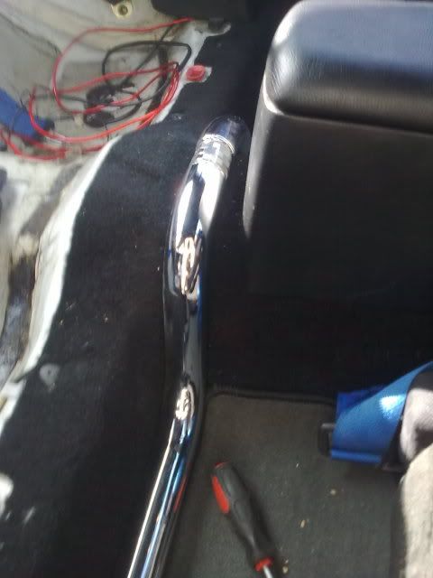

Dim Sum Posted January 25, 2011 Author Share Posted January 25, 2011 My friend give me this one, which I attached it on today. probably no brand but will it do anything? Quote Link to comment Share on other sites More sharing options...
Scott Posted January 25, 2011 Share Posted January 25, 2011 Your turning this thread into a broken record blue. IMO it will do nothing, it looks pretty though. I can see how extra bracing would help an aerotop but I can't see how any brace across the width would do anything to help scuttle shake (the term when the front twists clockwise while the rear twists anticlockwise). They would have to be crossed over in the floor of the car. I haven't experienced the effect so I can't deny that they work, I can only say that I have tried front struts and rear struts, branded and unbranded, and felt absolutely no difference. I noticed a massive difference with a simple geo so if you want a noticeable difference to handling get decent tyres and a geo done Quote Link to comment Share on other sites More sharing options...
Dim Sum Posted January 25, 2011 Author Share Posted January 25, 2011 Guess this is the end of the thread lol. Might as-well think about re-selling the bar and get some new panels which i cut out the hole for the brace. Thanks for the info all. Quote Link to comment Share on other sites More sharing options...

bodilx6 Posted January 26, 2011 Share Posted January 26, 2011 My friend give me this one, which I attached it on today. probably no brand but will it do anything?http://i151.photobucket.com/albums/s154/fightersblue/th_IMAG0082.jpg I bought the same one. It's a cheapo ebay item. I think it was like 30£ or so. I only got it after doing my rear seat delete to keep luggage from flying through the cabin.. But yeah, looks pretty http://idisk.me.com/stefanbovien/public/rearseat3.jpg I noticed a difference when I fitted a rear brace. On the road to my house there were 5 speed humps I had to negotiate, without the brace I could hear the rear twist and the rear door creak, the brace stopped the noise. Was/is yours a hardtop or aerotop? I'm also guessing that the one you fitted was a proper sturdy one, right? Quote Link to comment Share on other sites More sharing options...
