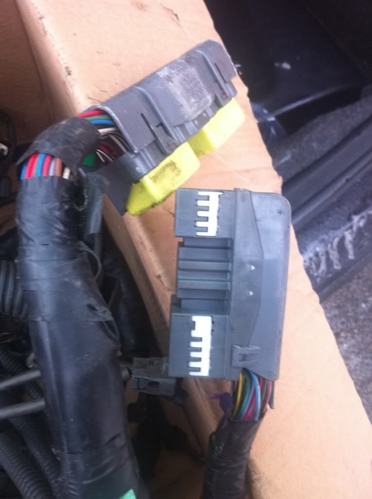

hodge Posted January 15, 2011 Share Posted January 15, 2011 Here you go Awisto. Sorry it's late but snow has just gone a couple of days ago. This is an aristo non VVTI The supra has the top plug that screws into the ECU but also has a smaller plug that plugs into it also, as you can see this just has 2 large plugs. The Supra loom also has 4 smaller plugs which attach to the interior harness which isn't there either. Quote Link to comment Share on other sites More sharing options...

Awisto Posted February 14, 2011 Share Posted February 14, 2011 Here you go Awisto. Sorry it's late but snow has just gone a couple of days ago. This is an aristo non VVTI The supra has the top plug that screws into the ECU but also has a smaller plug that plugs into it also, as you can see this just has 2 large plugs. The Supra loom also has 4 smaller plugs which attach to the interior harness which isn't there either. http://i200.photobucket.com/albums/aa74/hodge_012/e5c863c4.jpg Just seen this, not been on here much. The E9 connector (the plug with the yellow connectors) is common between Aristo and Supra, as you said. The E10 connector (which goes on the far right of the ECU, doesn't bolt in the like the E9 but is a clip fitting), which again is common between the Aristo and Supra but isn't part of the engine loom on the Aristo (and don't think it is on the Supra loom either? ) but the Aristo does have the E10 connector. The other plug isn't an ECU plug, and I only stated the ECU plugs are identical. Quote Link to comment Share on other sites More sharing options...
