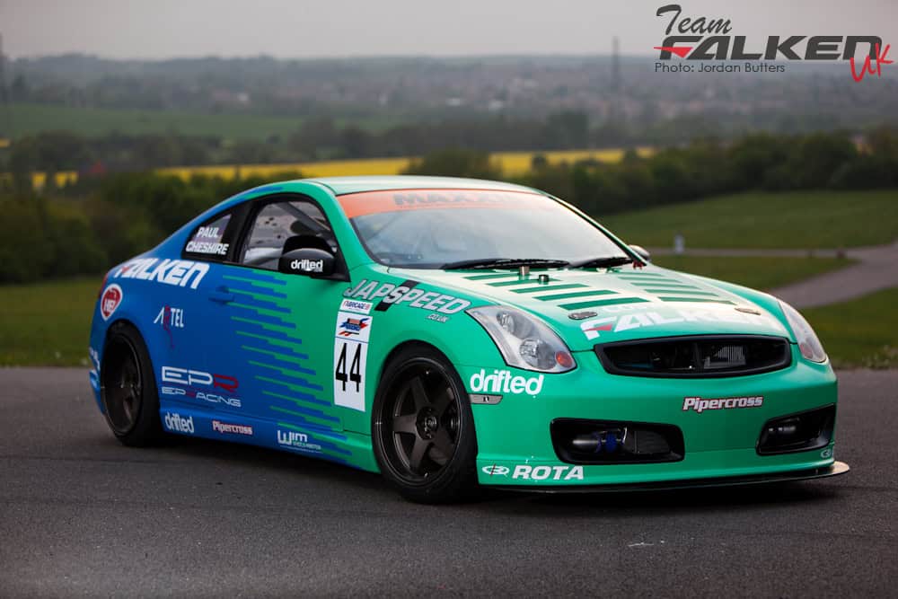

Polo Posted October 19, 2011 Author Share Posted October 19, 2011 Cheers guys!! Time for a well over due monster update!! last thing i done after the front splitter was fitting the mesh tot he bonnet! Tiger seal FTW! Then fabbed up the screamer pipes and got a mate to tig weld them The next morning it was up to Greg at protuner Yes that is all below 5750rpm Then streight from protuner to the bodyshop, literally 6 hours later Then the 4-5hour task of masking the Falken design This is all gun finish BTW, no polishing atal At this stage i was quite worried it was going to look crap Its like a hole new car By this stage i was very excited and pleased how it was looking Quote Link to comment Share on other sites More sharing options...
Polo Posted October 19, 2011 Author Share Posted October 19, 2011 That was up till about a day and a half before the 1st round, this little update will be up to then So i rushed the Lexan windows but was really happy how they came out I was gooing to construct some sort of frame to hold the top of the door window in but only had time for lock wire, it works really well so will be staying! I had the guy nex door knock up me a knob on his cnc lave as i couldnt find one to fit Then it was time to tackle the lack of steering lock I took to the stock rods with the lave Bump stops with and angle grinder and ta da, still not great but a huge improvement! Then a few shots out side before it got dark and the rest was finished like fire extinguisher, harness etc Note the rear lexan window, only pic i have Then after using the car a few times it came apparent that A) no single or twin plate clutch would work so in went a tripple B) i had a major gear oil leak so i fitted a -6 breather in the box wich stopped all leaks But the tripple plate clutch done this to 2nd gear (nothing to do with my angry driving):wack: so now im looking for T56 or V160 conversions, some thing i didnt want to do until the end of the year! And i also got a differant bumper for when i dont want to bash the nismo one Quote Link to comment Share on other sites More sharing options...

Polo Posted October 19, 2011 Author Share Posted October 19, 2011 Just superb, cheers for spending the time uploading to the site, really interesting read and great pics. Looks a beast of a motor. So what's next on the project list As said in my 1st post in this thread today....... I was thinking of selling it and moving onto some thing else through out the year but in Portugal it worked and I came 4th so it's given me some confidence that it can work!! Throgh out the year iv had endless problems with the car, mainly power steering and transmission. Iv cured the power steering by fitting a 350z pump. So over the winter il be doing the following to make it a hole load more awesome!! Handling is prety bad and it feels like a bus to drive, so il be fitting/making fibre glass doors, front wings, rear 1/4s, boot and bonnet, chopping out all the metal I can with in the rules! Also to level up the weight loss and make it handle better I'm shifting weight around in the car for better distribution by moving the rad and other things to the back. Il also be remaking alot of things in light weight materials. Steering lock is a major issue with the car, loosing out in qualification due to weak angle so il be doing alot of work on the front steering and suspension. The car is going to be corner weighted next week so I have an idea of what iv got to work with and then compare it afterwards. Il also be fitting a v160 6spd box, this will be much better suited to the 3.4:1 diff I have now, which is alot of the problems I'm having with blowing boxes, ATM pulling away in 1st is like 2nd gear as it's so long geared! The other thing I'm going to do if I can afford it is change the hks ecu out for syvecs and go for closer to 700hp. To help with the power I'm hoping to freshen up the engine with rods, pistons, springs and cams. Right, I'm off the rob a bank lol Quote Link to comment Share on other sites More sharing options...

Suprash Posted October 20, 2011 Share Posted October 20, 2011 As said in my 1st post in this thread today....... I was thinking of selling it and moving onto some thing else through out the year but in Portugal it worked and I came 4th so it's given me some confidence that it can work!! Throgh out the year iv had endless problems with the car, mainly power steering and transmission. Iv cured the power steering by fitting a 350z pump. So over the winter il be doing the following to make it a hole load more awesome!! Handling is prety bad and it feels like a bus to drive, so il be fitting/making fibre glass doors, front wings, rear 1/4s, boot and bonnet, chopping out all the metal I can with in the rules! Also to level up the weight loss and make it handle better I'm shifting weight around in the car for better distribution by moving the rad and other things to the back. Il also be remaking alot of things in light weight materials. Steering lock is a major issue with the car, loosing out in qualification due to weak angle so il be doing alot of work on the front steering and suspension. The car is going to be corner weighted next week so I have an idea of what iv got to work with and then compare it afterwards. Il also be fitting a v160 6spd box, this will be much better suited to the 3.4:1 diff I have now, which is alot of the problems I'm having with blowing boxes, ATM pulling away in 1st is like 2nd gear as it's so long geared! The other thing I'm going to do if I can afford it is change the hks ecu out for syvecs and go for closer to 700hp. To help with the power I'm hoping to freshen up the engine with rods, pistons, springs and cams. Right, I'm off the rob a bank lol Glad you're sticking with it Paul, I've been watching you all year mate and you've looked like you've been struggling in the car, so what you've said here explains a lot, but this is too nice a build to sell after such little time, so keep going mate, it'll make the good qualifications and good results feel so much better once you start getting them, and you will, you know how to drive a car after all. Everytime I see this though it makes me want to build something just as nice, or attempt at something as nice, along side my cobbled together attempt of a car lol , but you do this for a living, I support Datacenters and Im not sure I could afford to carry the debts it would incure, as I could imagine yours are from this car ! Jealous - 100% Quote Link to comment Share on other sites More sharing options...
Polo Posted October 20, 2011 Author Share Posted October 20, 2011 Thanks Ash Ok just got back from having it weighed!!! Shes a fat fook!!! lol 1463kg!!! Front 835kg 57% Rear 628kg 43% Drivers side is 10kg more than passenger side!! 1544kg with me in it!! Thats with a prety empty tank!! Realistic target figer for next year???? 1350kg maybe??? Quote Link to comment Share on other sites More sharing options...

Polo Posted October 20, 2011 Author Share Posted October 20, 2011 That's going to take some doing on the weight issue. Still, as someone said to me on saving money and weight in a car..... just go on a diet So what was the problem with the power steering? I thought a lot of the original parts are taken from a 350z? When going on to full lock the pump was stalling causing the belt to jump off, mid corner at 70mph is scary!! Also the way the ps pump is mounted on the JZ engines, it relies on the AC compressor to support it, i have romoved the AC, i did make a braket but the pump still flexed under high rpm, so now i have made an even stronger one. Quote Link to comment Share on other sites More sharing options...
