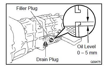

merckx Posted March 3, 2010 Share Posted March 3, 2010 (edited) read that you need to put special V160 oil in, It's not readily available like it used to be, Whifbitz on here do it , you'll need just less than 2 litres. Do a search on here and you'll find that it isn't particularly clear which lubricant is a definate replacement. does the box have to be removed or anything stupid? No. Some recommended lubricants. The car needs to be level. I filled mine using a couple of metres of clear plastic tubing. Stick one end in the filler hole and attach a funnel to the other end and fill it up from the side of the car. You shouldn't have much left from 2 litres and it should be level with the bottom of the filler hole. It might be worth checking that you can loosen the filler hole plug first before you drain it out from the bottom hole. Edited March 3, 2010 by merckx (see edit history) Quote Link to comment Share on other sites More sharing options...

Suprab1 Posted March 3, 2010 Share Posted March 3, 2010 It's not readily available like it used to be, Whifbitz on here do it , you'll need just less than 2 litres. Do a search on here and you'll find that it isn't particularly clear which lubricant is a definate replacement. No. Some recommended lubricants. http://i4.photobucket.com/albums/y122/rexmerckx/gearbox-1.jpg The car needs to be level. I filled mine using a couple of metres of clear plastic tubing. Stick one end in the filler hole and attach a funnel to the other end and fill it up from the side of the car. You shouldn't have much left from 2 litres and it should be level with the bottom of the filler hole. It might be worth checking that you can loosen the filler hole plug first before you drain it out from the bottom hole. Waw thats a great diagram mate. This looks a very strait forward job. Quote Link to comment Share on other sites More sharing options...

Terminator Posted March 3, 2010 Share Posted March 3, 2010 I get my V160 fluid from Opie oils. Remove the filler plug before draining the oil, it will allow air to take the place of the draining oil Quote Link to comment Share on other sites More sharing options...
