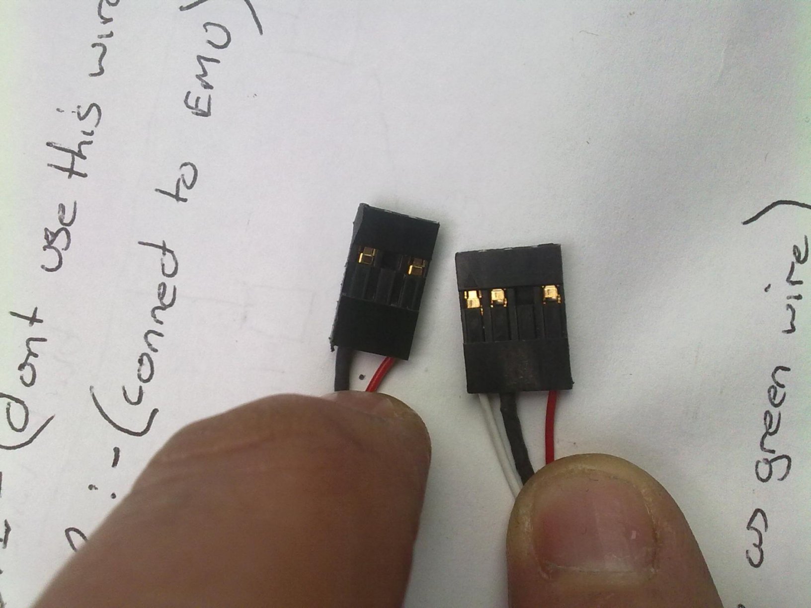

barneybrendan Posted October 5, 2010 Author Share Posted October 5, 2010 (edited) descided today that i had to get in the van and get some parts myself,impatience got the better of me.Managed to get the 90 degree fitting for the fuel rail adaptor for a huge sum of £2,so that is now fitted.fuel side of things should now be finished.The internal pc cable arrived this morning so that has been trimmed and now fits into the option port on the emu that was 99p and greddy want $25 plus whatever the postage would be for the option port connector with pigtail.As you can see from the pic the cable has a 4 pin connector each end all i had to do was cut the end one off with the white wire attached.The emu only needs 2 wires anyway ,as you look at the option port the 2 used are left had side analog and right hand side ground. Edited October 5, 2010 by barneybrendan (see edit history) Link to comment Share on other sites More sharing options...
