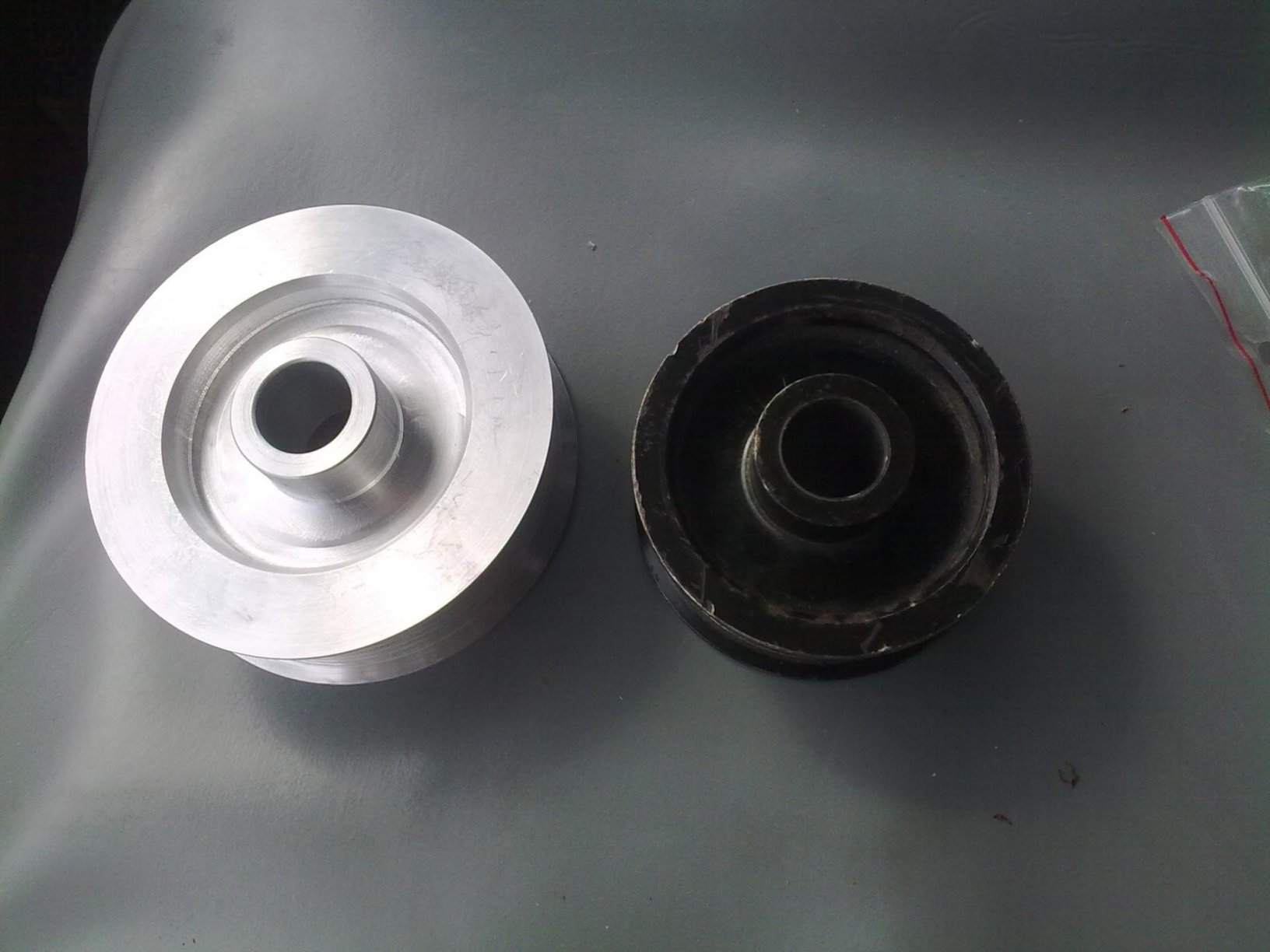

barneybrendan Posted April 28, 2010 Author Share Posted April 28, 2010 just picked up the bits from the engineers. the pulley is now 98.5 mm and alloy this now gives me a 2-1 ratio the bov now has a piece of stainless tube screwed into it so i can weld the rest of the recirculation pipe work. the tube with the flange has had a hole taped for the map ecu IAT sensor. going to now fit this little lot so i can measure up for the size belt i need,and get the tensioner bracket in pplace. ref not starting,now thinking the dizzy could be out as its been in the shed for a while and moved around a bit.so its a case of get tdc and rotor arm facing number 1 plug . Link to comment Share on other sites More sharing options...
