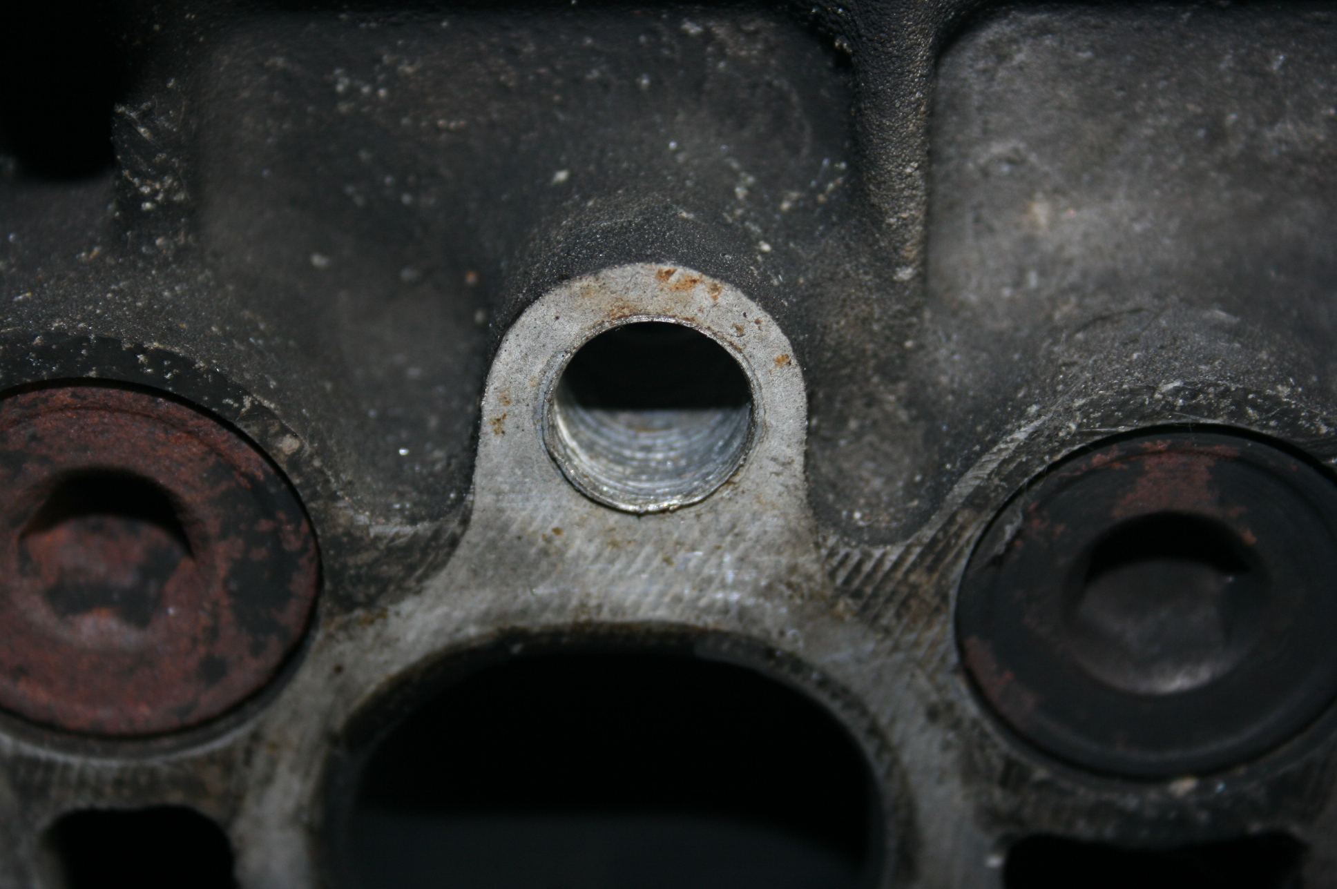

Spent the day fitting my manifold etc, and one of my problem studs (that has kept coming out) is well & truly fecked. I think at this point I'm just going to scrap this head & put the car away for the winter.

I can understand why heads can't be repaired easily in most aspects, but Id' have thought it would be simple enough for a machinist to provide some kind of solution to this?
The particular stud had previously been helicoiled, so the 10mm thread is prolly at 12mm now, I'd be willing to try another solution as it seems a waste to get rid of a perfecty good built head due to pulling a stud out
Ah....that's a shame. I wonder if it can be filled and redrilled?
Just emailed you Chris :)
It's 2nd from right on the top,
Also I was told the last time the head went on that it had a lot of material removed from the umpteen previous skimminings & this was prolly the last time it could be put on (I think they used a 2mm HG to keep compression as stock), is this the final nail in the coffin for it?
Physical damage or overheating are the two commonest reasons for skimming. If it were mine I'd have a hardness test done on it, and the same test done on a known never overheated head. If it has gone soft it's a scrapper. Have the cam journals checked for warpage too. That just needs an engineering straight edge. The hardness test needs a Brinell tester. You can probably find somewhere fairly local for hardness testing.

If the cam journals have warped would I be seeing any other side effects? Can I check them by just removing the cam covers? I might need direction as to what the "journals" are :D
If the heads off the car take it to an engineering company that can either check it using there inspection CMM machine or just pop it on a milling machine and put a verdict clock in the tool head and run along the cam journals.
Very easy to do and only take a few minutes
If its on the car and you have an accurate straight edge you could see the warp along the journals but you need a good edge and a good eye.
Cams need to come out in both cases
