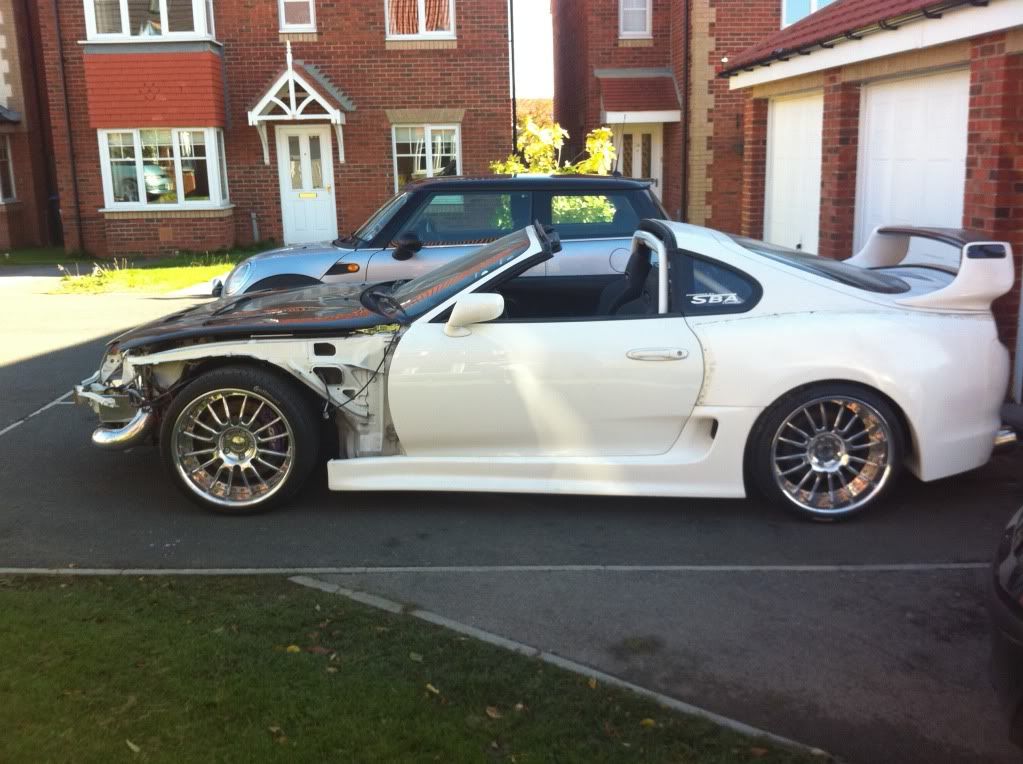

hodge Posted November 18, 2010 Author Share Posted November 18, 2010 No TRD kit there rob. That has trial skirts and stock wings and stock rear quarters and a nice layyyyyyddddyyyy Link to comment Share on other sites More sharing options...
Stevo Posted November 18, 2010 Share Posted November 18, 2010 I don't know Rob, not a bad looking rear if you ask me. Link to comment Share on other sites More sharing options...
hodge Posted November 18, 2010 Author Share Posted November 18, 2010 If you fancy a trial rear project, I know just the donor car.... Nice try steve lol. Link to comment Share on other sites More sharing options...
Rob_Mitchell Posted November 19, 2010 Share Posted November 19, 2010 I don't know Rob, not a bad looking rear if you ask me. nice supra aint it! oh my bad i thought it was TRD with trial rear **slaps face in shame** Link to comment Share on other sites More sharing options...
Jamesy Posted November 19, 2010 Share Posted November 19, 2010 James this is the nearest I've got to a full side on view mate but the front wing is missing. I've got a couple of when I first fitted the kit but there's no engine in and I've raised the back about 30mm since. But this pic is the stance it sits now. I went round with a digital vernier and measured the skirt to ground clearance to make sure it sat straight. http://i200.photobucket.com/albums/aa74/hodge_012/013-25.jpg cool thanx mate - love it Link to comment Share on other sites More sharing options...
