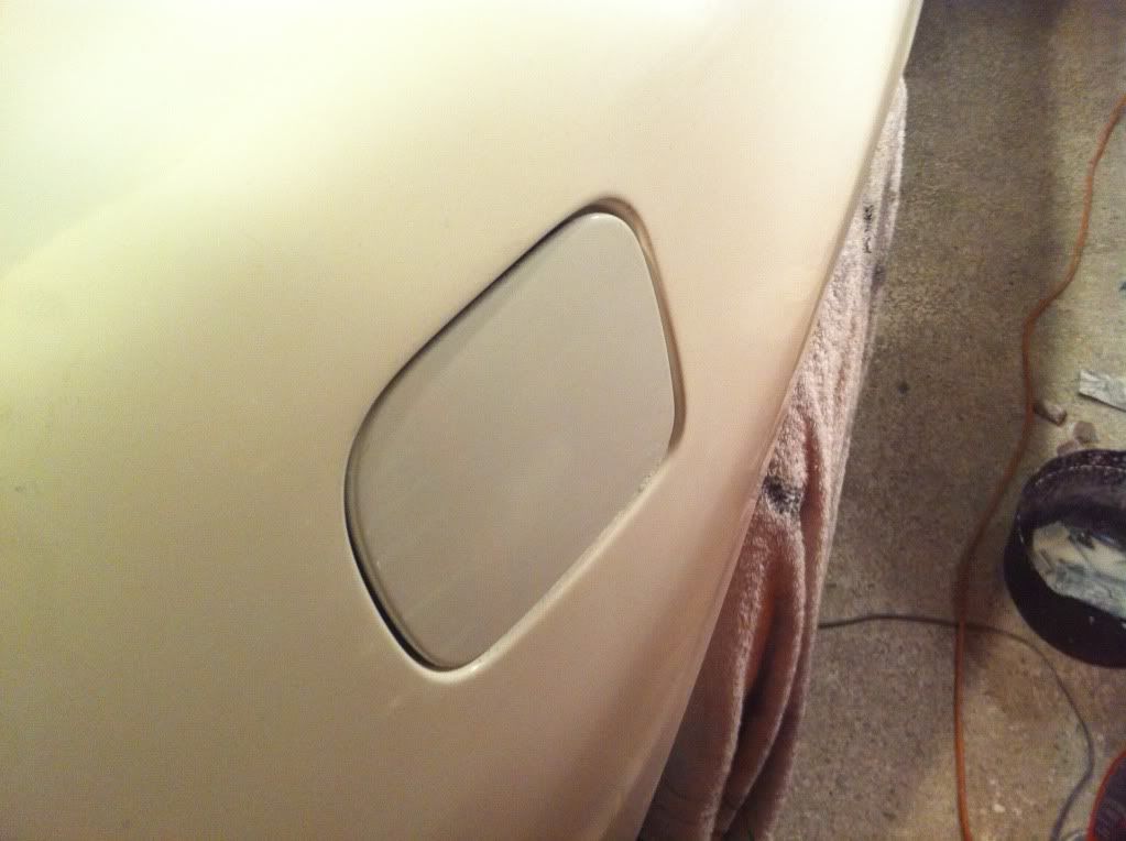

kingaby Posted November 16, 2010 Share Posted November 16, 2010 Hi i have been reading your build and its looking awsome you mentioned about the flush fitting filler cap Im considering fitting 1 of these. What do you all think. http://www.speedflowshop.co.uk/aero-400-8-bolt-flange-with-neck-670-cap48sl-1225-p.asp The filler flap will have to be smoothed over, so I need to find a way to make it solid when closed cos if it has any kind of flex once filler the filler is going to crack straight away. http://i200.photobucket.com/albums/aa74/hodge_012/004-42.jpg Hopefully i can now patiently await Rob to tell me the best way to do it Well i am having the same problem! I have been advised to get some steel sheet cut it to the same size as the flap then fit the flush fitting cap to the sheet and weld it as smooth to the body as possible leaving enuff room to hide the weld and then fiberglass it flat. thats the way im gona attempt it Link to comment Share on other sites More sharing options...
