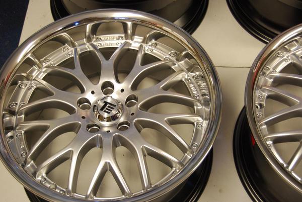

Adrian123 Posted July 11, 2009 Share Posted July 11, 2009 (edited) As the title suggests, i was just wondering if anyone knows if these wheels clear UK breaks, either they have them, or know someone that does as im considering the purchase. http://1.2.3.9/bmi/imagehost.vendio.com/a/23734168/aview/1244120844104_STAG_DTM_1.jpg http://imagehost.vendio.com/a/23734168/aview/1244120843365_STAG_DTM_2.jpg Their sizes are as follows: Size - 18" Offset Front and Rear - +35 Front Width - 8.5 Rear Width - 9.5 Thanks for the advice. Edited July 11, 2009 by Adrian123 2nd link to pic (see edit history) Quote Link to comment Share on other sites More sharing options...
JamieP Posted July 11, 2009 Share Posted July 11, 2009 I cant get that pic to open, the offsets look good for clearing uk's. Quote Link to comment Share on other sites More sharing options...
Tricky-Ricky Posted July 11, 2009 Share Posted July 11, 2009 Depends on what the spoke design is like on the inside of the wheel. i have deep dish with 35 offset, and have to use a 5mm spacer to clear UK brakes. Quote Link to comment Share on other sites More sharing options...
JamieP Posted July 11, 2009 Share Posted July 11, 2009 Pic works now, may be tight with that dish. Quote Link to comment Share on other sites More sharing options...
Adrian123 Posted July 11, 2009 Author Share Posted July 11, 2009 Thats my fear too. Is it ok to run with the spacer for everyday use? or does it depend on the size of the spacer? Quote Link to comment Share on other sites More sharing options...
JamieP Posted July 11, 2009 Share Posted July 11, 2009 I dont think spacers are such a big deal (if using quality ones with the right studs) that people make out but as you are buying new id try to avoid them and look at other wheels mate. The other problem is the spacers will change the offsets and you may have a clearance issue. Quote Link to comment Share on other sites More sharing options...
