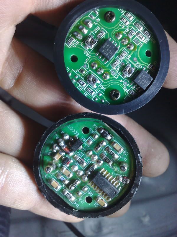

A while ago my boost sensor to my axepi avc-r breakdo It was showing 3.5 bar in ignition mode.:)
It appers that recidence R2 had failed.
Anyway I order a new sensor.
This one http://www.frsport.com/Apexi-499-X002-AVC-Type-R-Boost-Controller-Pressure-Sensor-Accessory_p_9450.html
But when I installed it was showing 1.8 bar in ignition mode and 0.8bar in idling mode.
So i opened the new sensor and compered it to my old one. See pic
http://i106.photobucket.com/albums/m265/gt-akare/200904221007.jpg
It is totally diffrent!
Are there diffrent sensor to apexi avc-r?
I have the blue one.
I have talk to frsport and they can't explain it so they put in that it maybe dont work to old apexi avc-r.
Please help me! What should i do?
