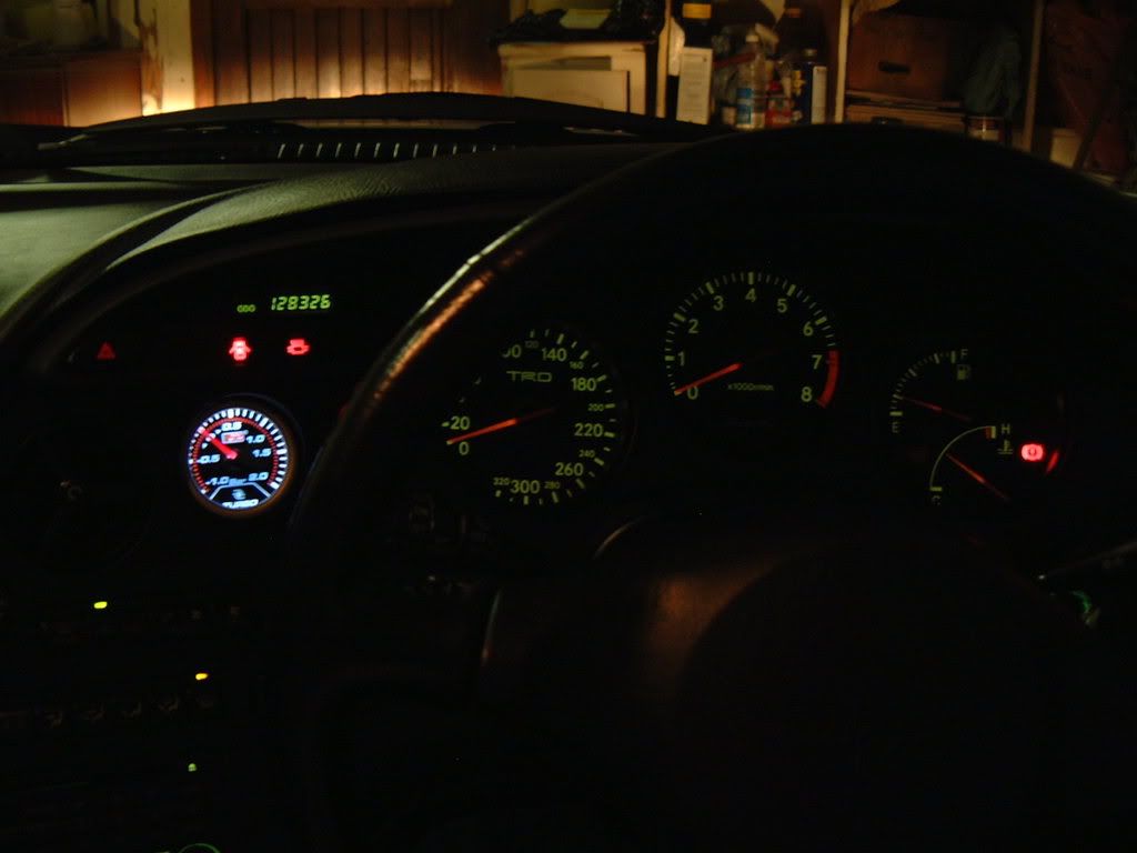

Guest ImraanK Posted February 13, 2008 Share Posted February 13, 2008 Howzit guys.. Quick question. Are those fan/ac control buttons meant to light up when u switch the car headlights on ? If so, wat could be the problem ? any fuse i should check ? heres a pic http://i233.photobucket.com/albums/ee34/mohk786/DSCF0018.jpg Cheers. Quote Link to comment Share on other sites More sharing options...
jamesmark Posted February 13, 2008 Share Posted February 13, 2008 Yes they are if it is turned on, unknown if it is a fuse. Quote Link to comment Share on other sites More sharing options...
SupraShaun Posted February 13, 2008 Share Posted February 13, 2008 I had this on mine, the bulbs had gone- twist fit ones on the back Quote Link to comment Share on other sites More sharing options...
Guest ImraanK Posted February 13, 2008 Share Posted February 13, 2008 I had this on mine, the bulbs had gone- twist fit ones on the back Ok cool...Will take a look at it. Quote Link to comment Share on other sites More sharing options...
Guest ImraanK Posted February 18, 2008 Share Posted February 18, 2008 Anyone no how to open up that control unit ? Any tips ? Quote Link to comment Share on other sites More sharing options...
Supranature Posted February 18, 2008 Share Posted February 18, 2008 You need to remove your dash panels first. Do a search, its quite easy.You may need to purchase the bulb from Toyota and they ain't cheap for what they are... Quote Link to comment Share on other sites More sharing options...
SupraShaun Posted February 19, 2008 Share Posted February 19, 2008 I followed this guide and replaced them with leds http://www.internetwork.org.uk/led/led.htm Quote Link to comment Share on other sites More sharing options...
dan4 Posted February 19, 2008 Share Posted February 19, 2008 i spent loads on these bulbs and they are still sat in my glove box lol, mega expensive and the fitment size is unique Quote Link to comment Share on other sites More sharing options...
Guest ImraanK Posted February 22, 2008 Share Posted February 22, 2008 Thanks guys...Just have a problem opening the control unit... Will take a look tomz Cheers Quote Link to comment Share on other sites More sharing options...
